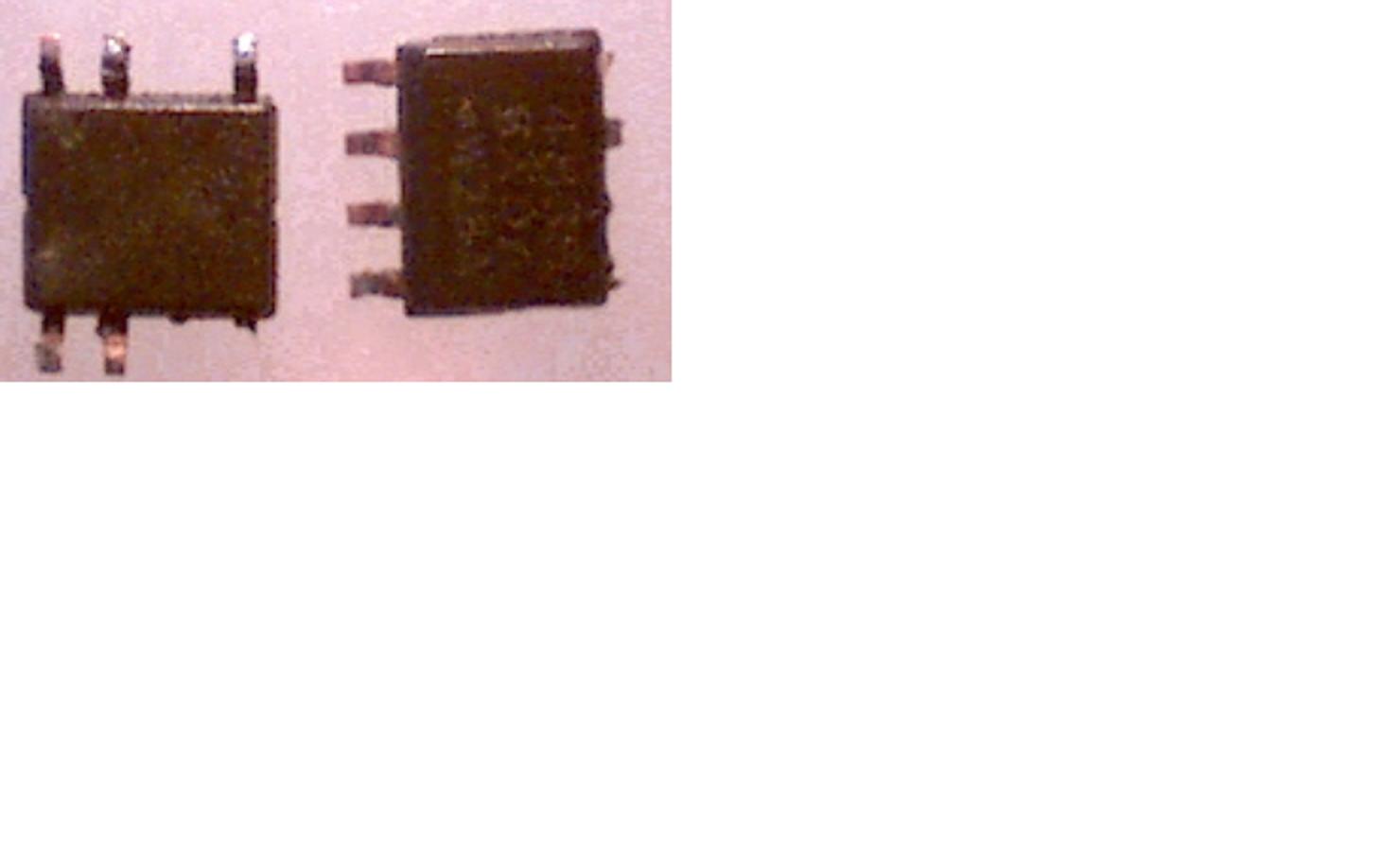

    My toshiba sat melted
    The Satelite laptop was caught in a storm and died.
    I found these two power MOS FET's had melted right off the board in a green mush.
    I had a couple of similar chips on a dead dell and soldered them in
    So it doesn't look good but works perfect again.
    Jim

    Good job Jim most ppl would of scrapped that Laptop but you managed to fix it. It really doesn't take moister long to destroy circuits I've seen devices that completed rotted out connections like you mentioned.Sometimes you can clean the circuit and even fix the bad circuit boards. I've had rare parts that the pins were rotted or broken and I scraped the pin area down till I could wrap wire around the metal and solder them to the board.Believe it or not I had one TV that had a board that was busted in many places and I managed to fix it.It was like a maze with all the copper circuitry and solder joints that were broken.
