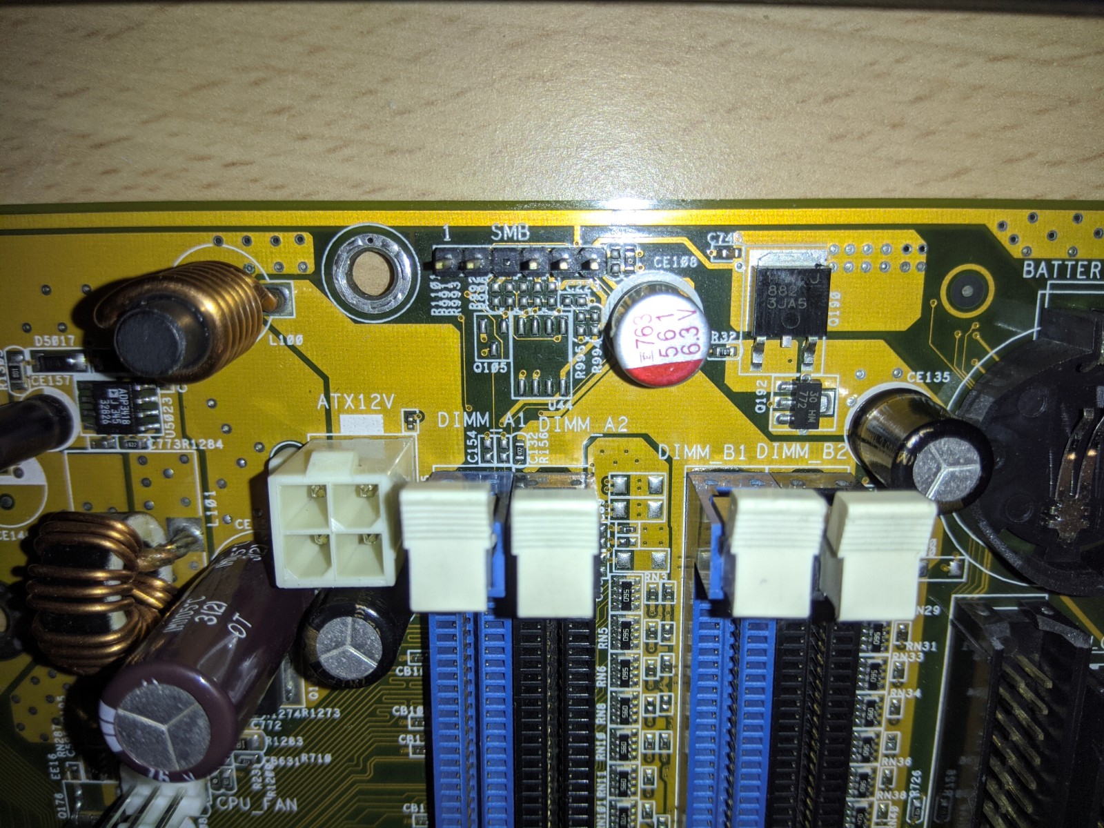

    Hello to all, first af all thank you for the existence of this forum, I discovered it only 2 days ago.
    I have a question regarding a used p4c800 mainboard I bought few days ago for a retro P4 project that I'm doing.
    My system is: p4c800 deluxe, p4 prescott 3.2ghz, Corsair xms twinx platinum series 2-3-3-6, saphire HD3850 agp with modified bios and pencil mod, verbatim ssd 120gb, Audigy 4 sb0610, 650w corsair PSU and a Corsair Spec Delta case.
    My previous motherboard was an Asrock p4i65g, not very good in overclocking but I managed to oc the cpu to 3.73ghz with 5:4 multiplier for RAM.
    The p4c800 deluxe board had tons of dust that I carefully cleaned out with isopropyl alcohol and comes with 2 smd capacitors off.
    My question is if you tkink it's safe to plug in and power, I want to be sure before frying some stuff, it takes 2 years to find all the components for this system.
    I resoldered the 2 smd capacitors as good as i can with a regular esd safe iron ( see photos below of the board and the area involved ), I'm concerned about the smd located in the backside of the mainboard under the 875p chipset.
    I also populated an empty area with a solid state capacitor ( the red one ),
    same volts tolerance half the capacitance, I've seen that is a vmem capacitor.
    Waiting for your answers, best regards.

    The p4c800 deluxe board comes with 2 smd capacitors off.
    what about the other one? the pics u uploaded only show one cap circled. where is the other that came off?
    for those brown/tan smd mlcc caps, i can only tell u that if they are physically damaged like broken, chipped or cracked in any other way, they tend to go short. some of the horror stories here include shorted mlcc caps creating a crater on the motherboard and u can see all the exposed copper inside the motherboard after that.
    so if the board was poorly packed, shipped and arrived at your door damaged, inspect the board carefully for any damaged broken, cracked, chipped smd mlcc caps like those. usually, these caps are used for filtering high frequency noise on the power rails or for decoupling of the clock frequency signal and boards typically have more of them than they need, so one or two removed wont cause any problems. worst, the computer just fails to post without them unless u replace them. at best, the loss of one or two mlccs on the 875p nbmch chipset just decreases the maximum overclock of the fsb and memory.
    if u are fearful of more damaged mlcc caps making a crater on the board and ruining a board worth €90+ on ebay, u can try using a good quality low power psu with WORKING short circuit protection instead of that 650w corsair psu. 250-300w should be enough to power on that system. also try using a cheap low power agp or pci video card to avoid frying that sapphire 3850 agp in case shit happens as its also quite a valuable card worth about €80-150 on ebay now.
    the low power psu will trip sooner and will prevent a high power high current short circuit from burning a crater through the board if anything shorts. that is all i know about trying to power on unknown condition hardware to avoid BBQ-ing anything.

      Today I found the courage to power it on , the first boot attempt was done with a weak setup, to prevent any damage: ati 3drage II+ PCI and 1 slot of ram, no audio card, no sata plugged.
      The first attempt was anything than good, no beeps sound. So i start the troubleshooting procedure, changed ram, changed the processor with a prescott 3.00ghz and then it powers on with succesful POST. It seems to cause problem with the processor I installed, a p4 3.2ghz SL7PN (a particular revision with higher t-junction of 73.2C° ), late 2004 release.
      I think it's a BIOS problem with the microcode missing for that CPU, so I just updated it to the 1019 version ( previously installed was 1014 ) with Asus update software under windows environment, now it works like a charm.
      As soon as I swap the processor again I'll keep you updated.

        The other smd cap missing was near the Speech POST reporter chip, but I managed to resolder another one with success ( much better solder than the other one you've seen in the photos ). I checked all the motherboard and there seems to be no other damage apart from the junk I already cleaned out.
        Luckyly there was no blown-out capacitors, even if I read from other posts in this forum, that the capacitors in this board are far from good-quality ones.
        I think this board was used for a short time, then forgotten in a dusty garage with other cards smashed over it.
        I also checked all the capacitors resistance and they all reveals to be good with all the same results compared to each other. ( so lucky! )
        Thanks again, sorry for the double-post.

          yes, good that u figured out the problem and got it working. looking at the asus cpu support website for this board: Asus P4C800 Deluxe - Support the p4 prescott 3.2 ghz is only supported by bios revision 1017 or later so updating the bios to the latest revision may be necessary to get the board to recognise the faster cpu.
          yeah, asus often uses 1000uF 6.3v ost rlp caps all over the board for general filtering and 1500uF 6.3v ost rlx or rlz caps by the cpu for cpu vrm output filtering. these often fail silently without any visible signs of bloating. therefore, u wont know if the caps are bad unless u desolder them and measure their specs using an esr or lcr meter.
          so if u are feeling more courageous and confident of your computer technician skillz, u can try replacing some or all of the ost caps on the board if u want to use the board for a long time and make it last a long time too.
          the 1000uF 6.3v ost rlp can be replaced with panasonic fr caps of the same specs and size (make sure the diameter of 8mm matches!). the ost rlx and rlz by the cpu can also be replaced with panasonic fr caps of the same specs and size.
          since it looks like u're into overclocking, u can replace the rlx and rlz by the cpu with polymer caps also. panasonic oscon sepc 820uF 2.5v, chemicon psc 820uF 2.5v or nichicon fpcap L8 series 820uF 2.5v can be used as replacements.
          u need a soldering iron of at least 80w to solder and desolder the caps by the cpu because there is a lot of copper in that area. if the wattage is inadequate, the solder wont melt but u'll just be overheating the board, damaging it instead.
          another very important thing is that because this is an asus motherboard, asus has the cap polarity silkscreen markings on the pcb reversed. for asus boards, the shaded side is POSITIVE(+). normally, the shaded side is negative which is what is marked on the caps. but this shouldnt be an issue for you since u added the red polymer cap by the dimm slots fine with the right polarity orientation.
          i also have this board too btw albeit its the non-deluxe version without the promise raid controller and 1394 firewire. my thread recapping my board is here. its from waaay back in 2013 when i first joined and was still a nub. lol!

            Hi, thanks for your suggestion.
            Yes I noticed that the polarity was inverted, I have a good equipment, ESD safe iron station, max 500c°, so i think I'll do the recap as soon as I can.
            Yesterday I made some overclock, the CPU tolerate only 1.6v from BIOS, if I go higher the system don't POST, I think it's related to that kind of prescott CPU, anyway I don't want to go with a northwood .
            Memory can only go up to 240mhz fsb at 1:1 with 3-4-4-8 timings and 2.85v, but it seems ddr500 pc4000 are nowhere to be found so I think I will keep them to this frequency.
            I didn't tried to lower the ram to 266mhz and keep increasing the fsb to find the maximum overclocking capability of the CPU, I really want to keep the ram to 1:1.
            Thanks for your capacitor list, I thought it was necessary to keep the voltage of the new capacitors ( if I choose the solid state ones ) at 6.3v.
            Thanks for sending me your thread link, I'll check it out later in the afternoon.
            Best Regards.
