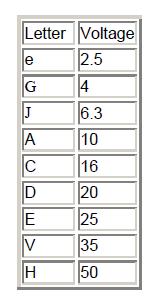

    Re: Chip type SMT electrolytic capacitor value chart?
    pics are always helpful.
    if they have a logo, even better.
    if not, the markings can be a clue. the pictured ones are most likely Nichicons, for example.
    in case you just need the values, the table below works quite often.
    it's always better to have a datasheet, though.
