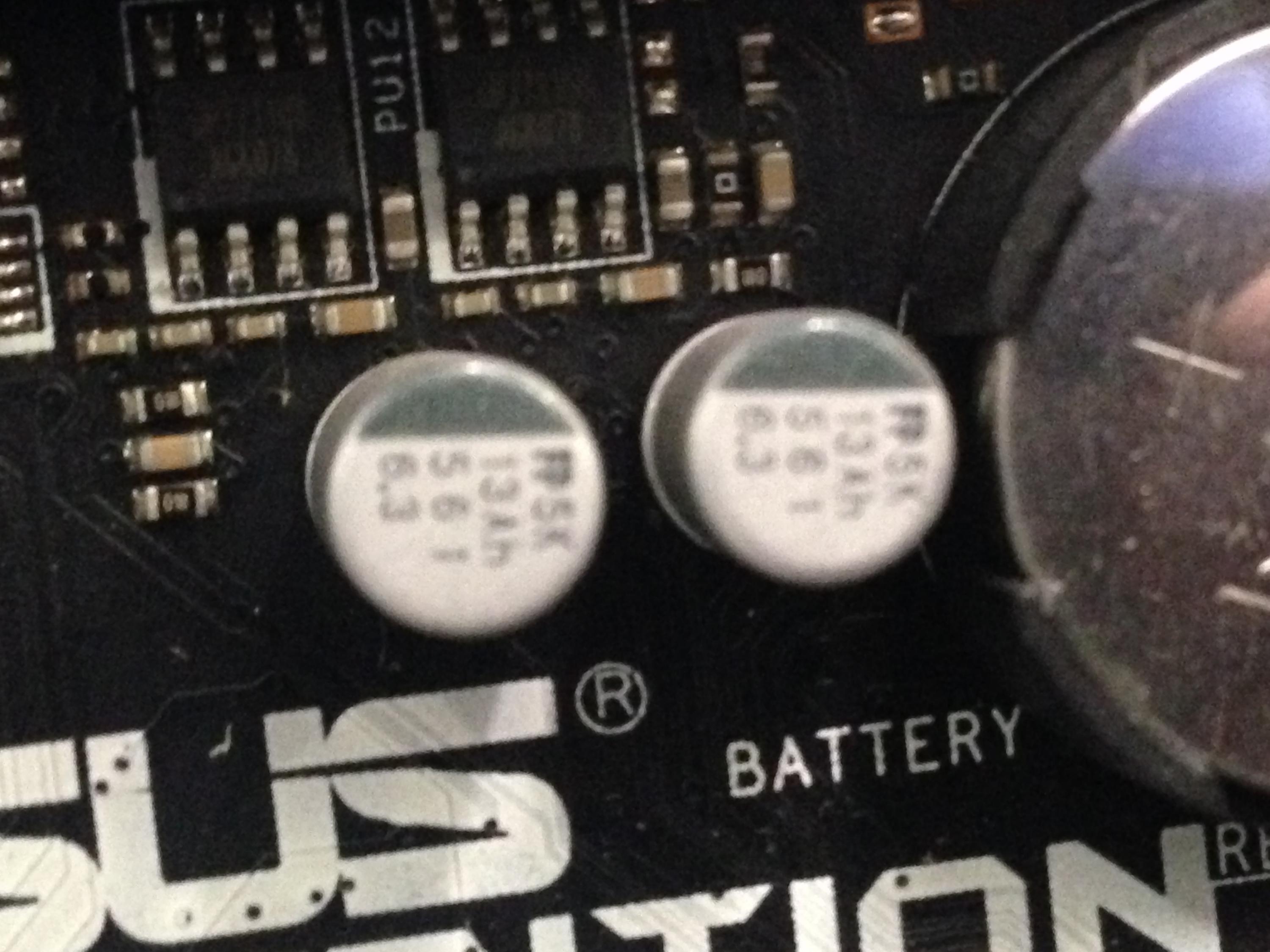

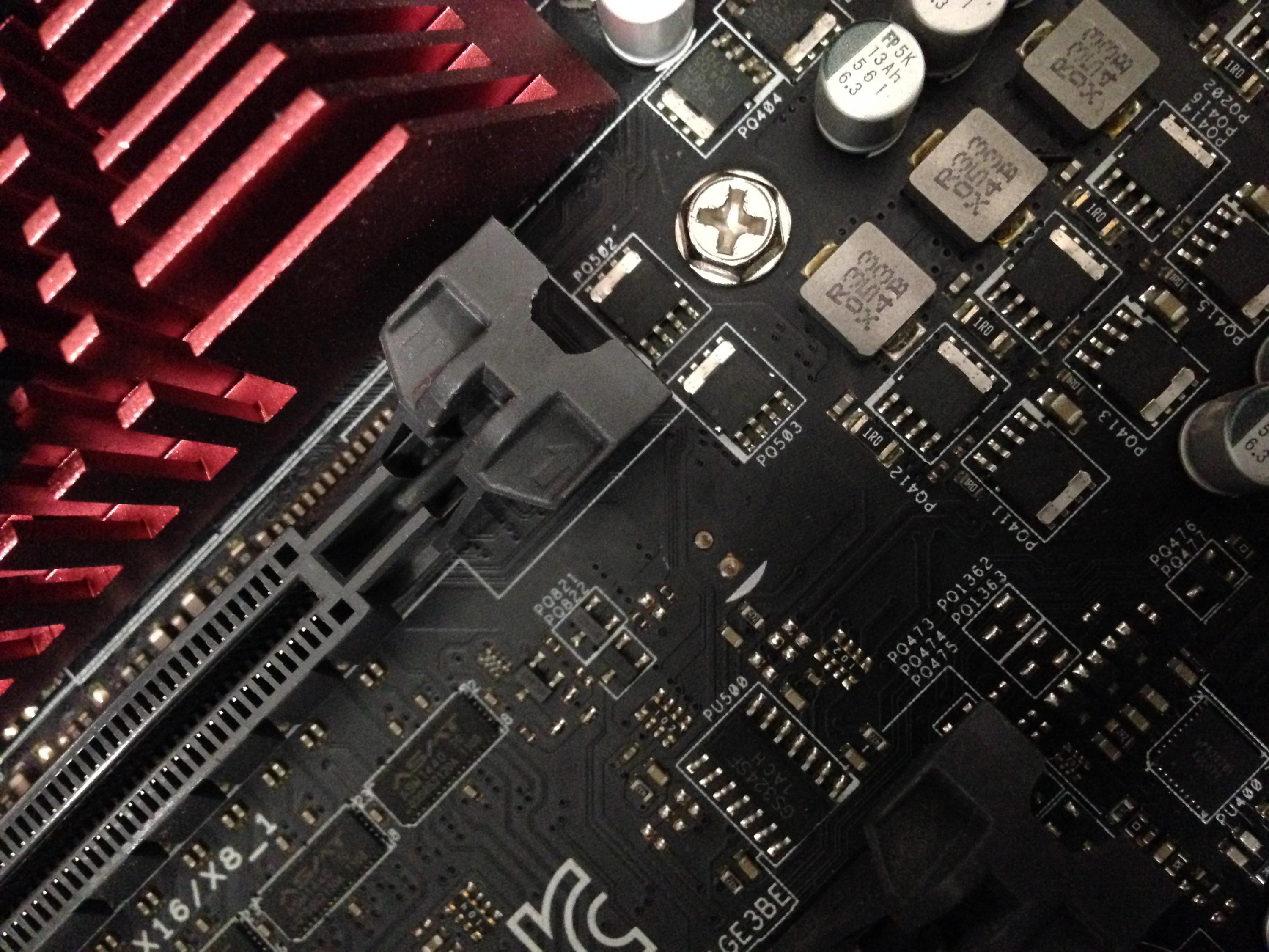

    I recently came across a headache I am trying to fix, got a Asus Rampage III Black Edition Motherboard that is MISSING a capacitor by the top most PCIe port (pictures attached.)
    Going by a mixture of logic and pictures found around the internet it should be the same "FP5K, 13AH, 561, 6.3" cap that is close to the other PCIe ports (pictures also attached) but I cannot find where to buy them. Even the numbering does not match anything I google.

    560uf 6.3v functional polymer electrolytics.
    http://capacitor.web.fc2.com/solidcapacitor.html#fpcap

      Missing? Or omitted by design? MB vendors often use the same PCB for multiple models, varying what is installed or omitted according to the specific models.
      Among other things, my present employer (which I will not name) designs and sells MBs, so I see this with some regularity.
