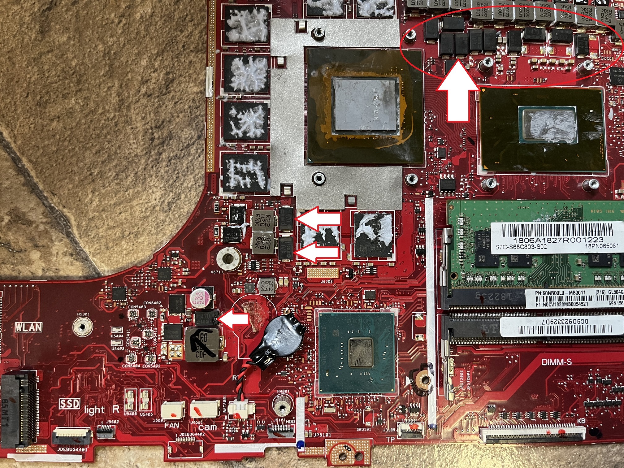

    Hi Im working on repairing this Asus GL504GS, and with meter in continuity mode, getting short to ground on all of these GPU related tantulum capacitors and .03ohm value in Diode mode (image with arrows). are these readings normal for this type of Board?
    I tested the caps on another non working board, and get the same readings.
    If abnormal, is it safe to inject 1v, 3-4amps to these to monitor with thermal cam?
