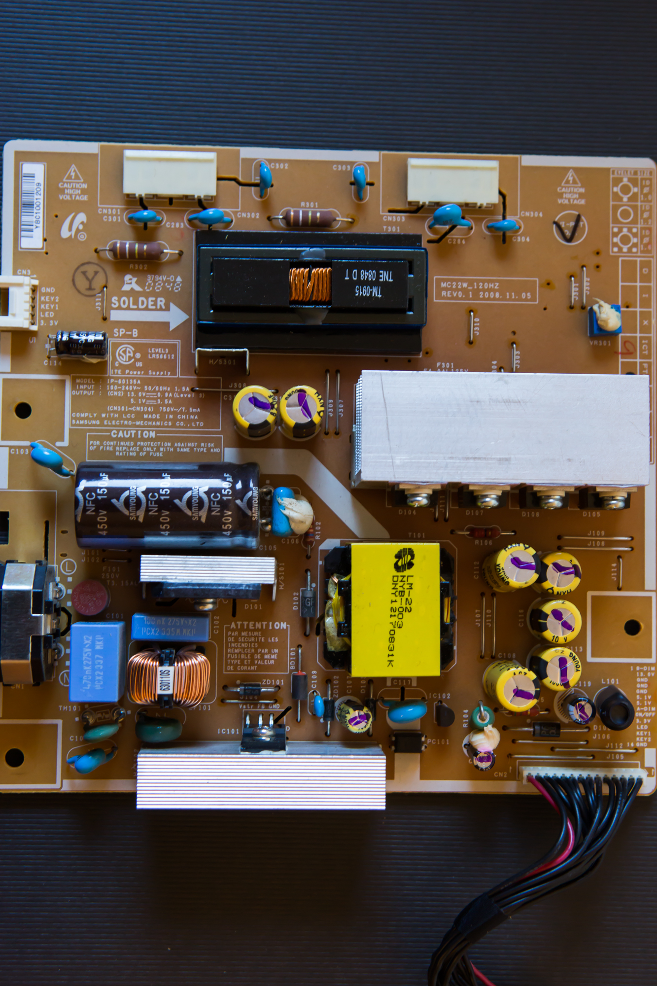

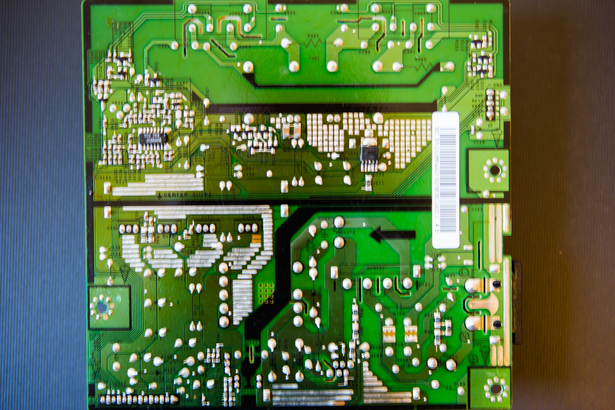

          Re: Samsung Syncmaster 2233RZ possible bad caps. Need help
          Not sure if these attached or not. Hopefully they did.
          Edit: Looks like they did attach. Here is front and back of the power board. As I stated before I don't see any blown or bulging caps but doesn't necessarily mean they aren't dried up. This is a 5+ year old monitor.
            none of the caps in your photo appear to be bulging
