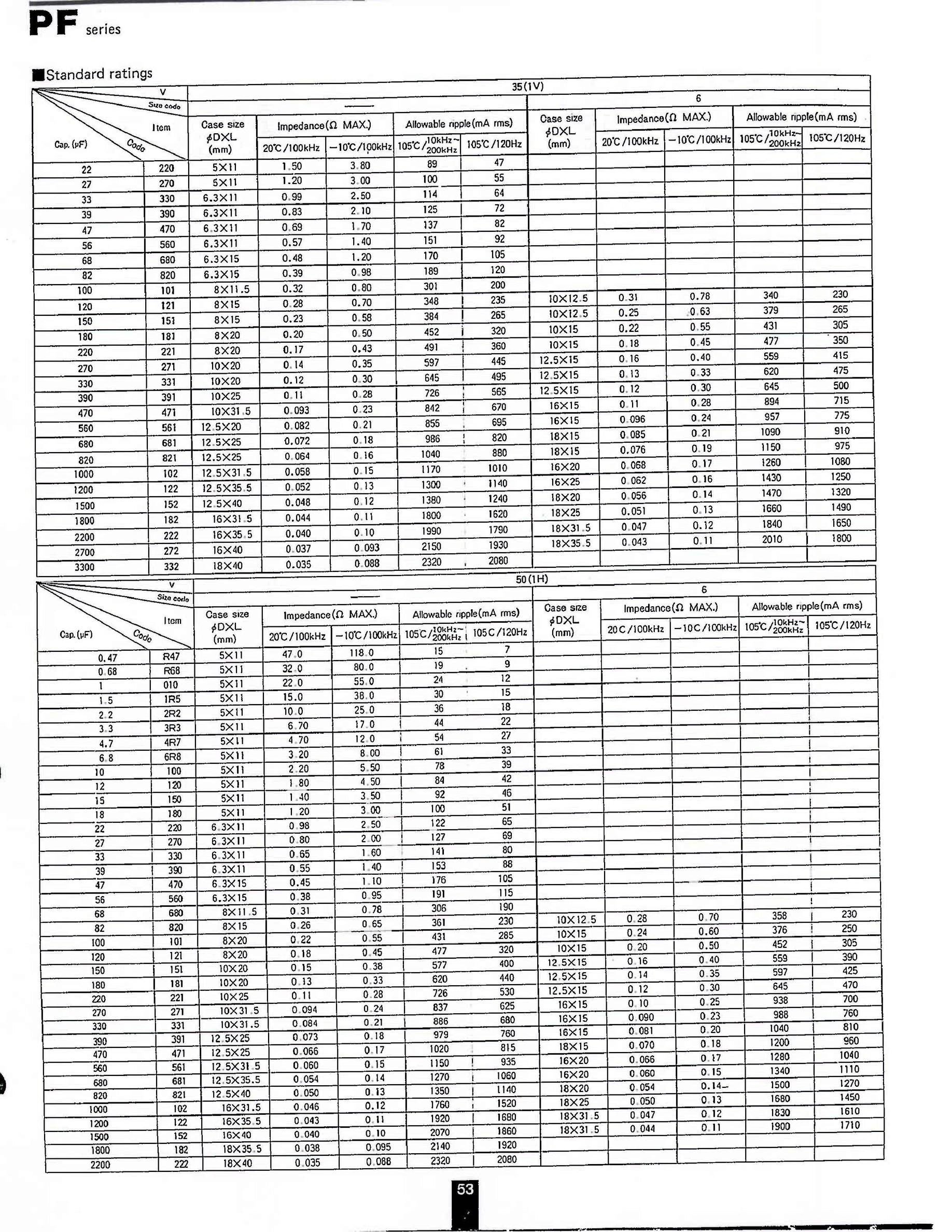

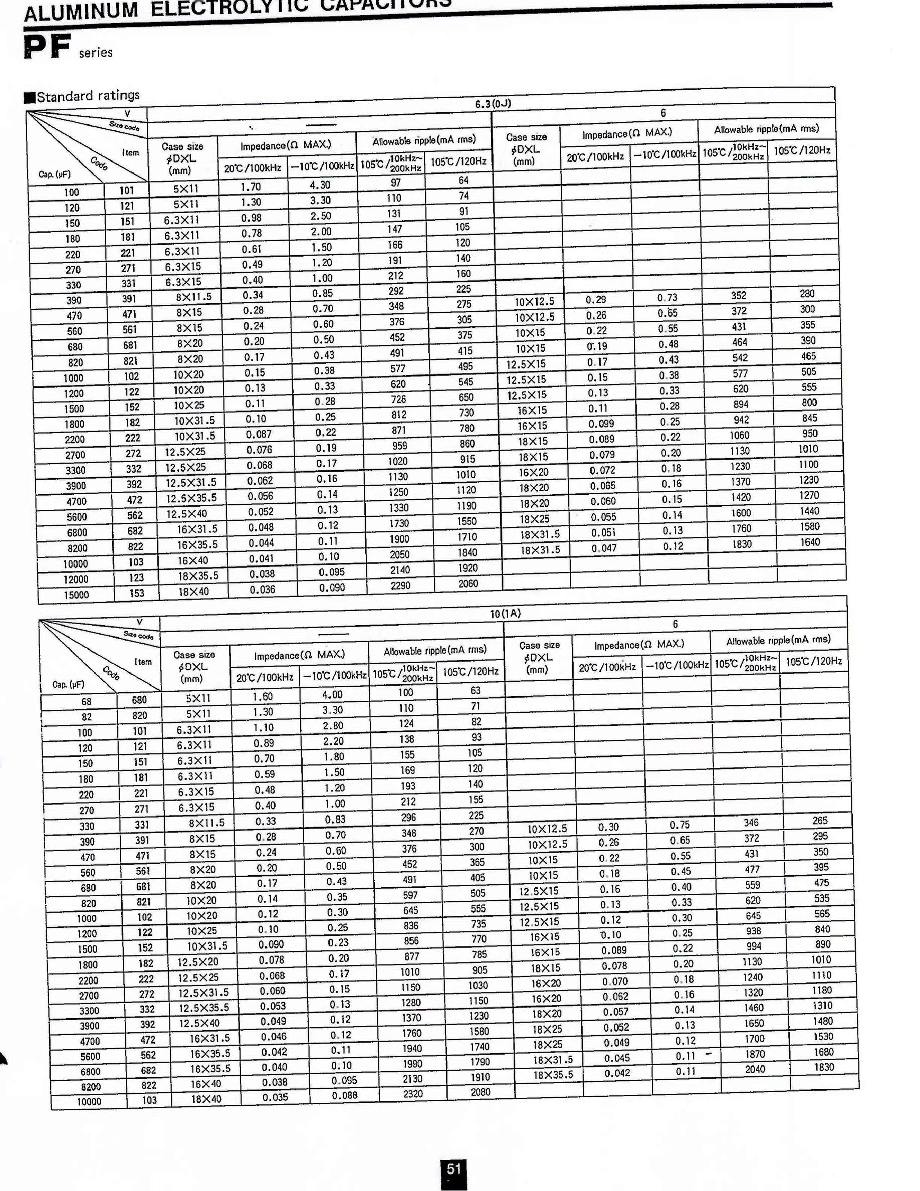

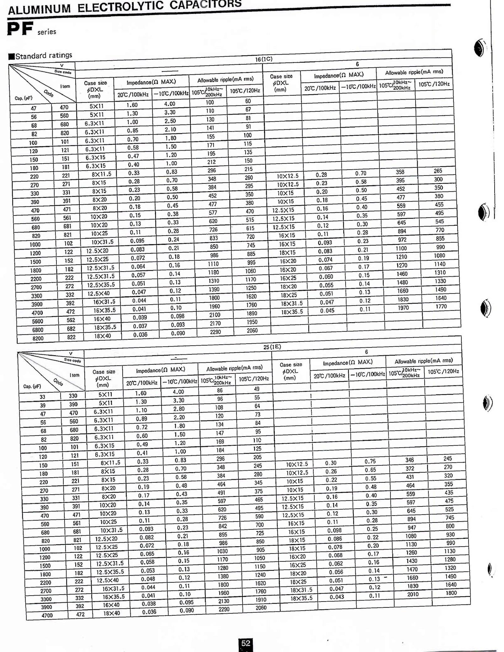

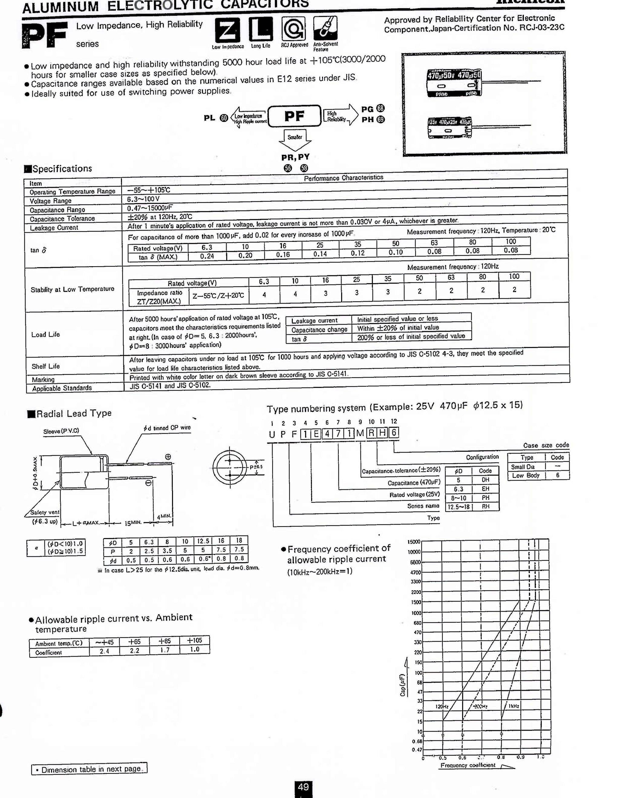

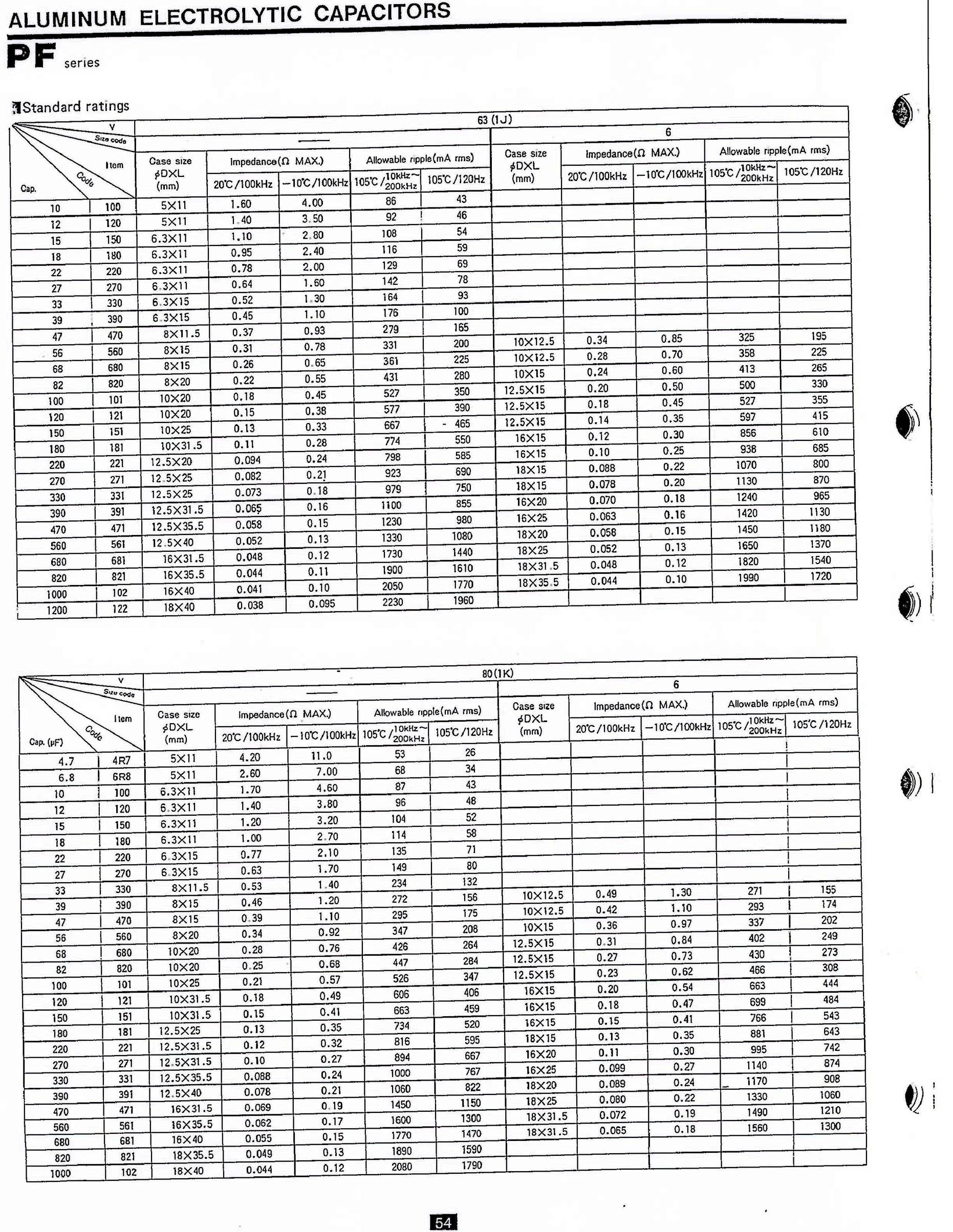

Need help locating datasheet - Panasonic series GE
  • theOracle
    • Nov 2012
    • 163
    Need help locating datasheet - Panasonic series GE
    Need help locating datasheet - Panasonic series GE
    I can contribute a datasheet the archive does not have, the infamous original low ESR leaker - the Nichicon PF (M) series
    If no one can locate a datasheet for Panasonic GE series, do you at least know for sure if it is low-ESR ?
    If you could point me to something from Panasonic indicating their preferred current substitute cap in place of series GE, that would be great!
    thanks!
    Nichicon PF (M) series datasheets
    large copies for archive are here at these links, the images further below do not size up as large as the originals at the links below
    i.imgur.com/1ZefA.jpg
    i.imgur.com/gw01w.jpg
    i.imgur.com/EgKmP.jpg
    i.imgur.com/9umgj.jpg
    i.imgur.com/3SUCs.jpg
    i.imgur.com/zlon6.jpg
    i.imgur.com/QDtDK.jpg
    __________________
    the BIG 4
    ~~~ the top tier of low-ESR electrolytic capacitors ~~~
  • PeteS in CA
    • Aug 2005
    • 3583
    • USA, Unsure of Planet
    Re: Need help locating datasheet - Panasonic series GE
    It may be just personal annoyance and CDO ("If you're truly OCD, you'll alphabetize the acronym!") ...
    Why do people here keep including "(M)" as part of series names? The meaning of "(M)" is that the tolerance is +/-20%!
    As to old low ESR series, in the late 70s Nichicon's best parts were the PA and PB series (ironically, Nichicon has worked its way through the alphabet, and their best non-water-based series is again the PA series). In the same time frame, the best NCC/UCC series were the RX (small can) and RZ (larger can) series. The sleeve color for the PA and PB series was green, and the RX and RZ series was yellow-orange.
    It's interesting that the little diagram on the first page of the PF series datasheets indicates that the PL series is lower impedance, and the PR series is smaller. The RoHS versions of the PL and PR series are the PM and PS series, respectively. I don't see a date on the catalog pages, as shown in this thread, but I'd guess that this catalog was dated 1988-1992 (the PL series was the latest and greatest Low-Z series, and the PF series had not yet been obsoleted).
    PeteS in CA
    • linuxguru
      • Apr 2005
      • 1564
      Re: Need help locating datasheet - Panasonic series GE
      Originally posted by theOracle
      If no one can locate a datasheet for Panasonic GE series, do you at least know for sure if it is low-ESR ?
      If you could point me to something from Panasonic indicating their preferred current substitute cap in place of series GE, that would be great!
      AFAIK, GE is just the case marking for series NHE. The replacement for NHE is probably NHG - which is a general-purpose, 105c series, but not particularly low-ESR. You should be able to safely use FC, FJ, FK or FM to replace NHE.
      • theOracle
        • Nov 2012
        • 163
        Re: Need help locating datasheet - Panasonic series GE
        AFAIK, GE is just the case marking for series NHE
        how do you know this, I can find no Panasonic document substantiating this, though I have heard a rumor to this effect
        The replacement for NHE is probably NHG
        yes, this much is well documented
        You should be able to safely use FC, FJ, FK or FM to replace NHE.
        I have run into problems with oscillation when using low-ESR caps in some applications where they are not called for
        __________________
        the BIG 4
        ~~~ the top tier of low-ESR electrolytic capacitors ~~~
        • linuxguru
          • Apr 2005
          • 1564
          Re: Need help locating datasheet - Panasonic series GE
          Originally posted by theOracle
          how do you know this, I can find no Panasonic document substantiating this, though I have heard a rumor to this effect
          Most of the Panasonic documentation for series NHE (datasheet, discontinuation notice, extended part numbers, etc.) has the string xxxGE somewhere, while NHG tends to have strings that look like xxxHG, with most of the other characters/digits being similar.
          I do have a few authentic Panasonic GE-marked caps around, and I can measure the dimensions later if needed - these are original Japanese production (thin scoring on the vents, smooth shiny can, silver stripe on navy blue sleeve), so GE is definitely an authentic Panasonic series, not a counterfeit.
          • theOracle
            • Nov 2012
            • 163
            Re: Need help locating datasheet - Panasonic series GE
            yes, where I am finding these used, I have no doubt they are genuine, but I disappointed that Panasonic doesn't list the GE series by name on their nice list of acceptable replacements for obsoleted capacitors
            __________________
            the BIG 4
            ~~~ the top tier of low-ESR electrolytic capacitors ~~~
            • theOracle
              • Nov 2012
              • 163
              Re: Need help locating datasheet - Panasonic series GE
              from my research around the depths of Panasonic's Japanese website, I have come to the conclusion that the GE marked caps are indeed the NHE series as linuxguru speculated - and the current replacement is indeed the NHG series
              __________________
              the BIG 4
              ~~~ the top tier of low-ESR electrolytic capacitors ~~~
                ASUS Pro Series D320MT-I564001774 Pro Series i5-6400 Specification for Upgrade or Repair
                This specification for the ASUS Pro Series D320MT-I564001774 can be useful for upgrading or repairing a desktop PC that is not working. As a community we are working through our specifications to add valuable data like the Pro Series D320MT-I564001774 boardview and Pro Series D320MT-I564001774 schematic. Our users have donated over 1 million documents which are being added to the site. This page will be updated soon with additional information. Alternatively you can request additional help from our users directly on the relevant badcaps forum. Please note that we offer no warranties that any specification,...
                09-12-2024, 03:28 PM
                ASUS Pro Series D320SF-I564000134 Pro Series i5-6400 Specification for Upgrade or Repair
                This specification for the ASUS Pro Series D320SF-I564000134 can be useful for upgrading or repairing a desktop PC that is not working. As a community we are working through our specifications to add valuable data like the Pro Series D320SF-I564000134 boardview and Pro Series D320SF-I564000134 schematic. Our users have donated over 1 million documents which are being added to the site. This page will be updated soon with additional information. Alternatively you can request additional help from our users directly on the relevant badcaps forum. Please note that we offer no warranties that any specification,...
                09-12-2024, 03:28 PM
                ASUS Pro Series D320MT-TR362D Pro Series i3-6100 Specification for Upgrade or Repair
                This specification for the ASUS Pro Series D320MT-TR362D can be useful for upgrading or repairing a desktop PC that is not working. As a community we are working through our specifications to add valuable data like the Pro Series D320MT-TR362D boardview and Pro Series D320MT-TR362D schematic. Our users have donated over 1 million documents which are being added to the site. This page will be updated soon with additional information. Alternatively you can request additional help from our users directly on the relevant badcaps forum. Please note that we offer no warranties that any specification,...
                09-12-2024, 03:28 PM
                ASUS Pro Series D320MT-I564000234 Pro Series i5-6400 Specification for Upgrade or Repair
                This specification for the ASUS Pro Series D320MT-I564000234 can be useful for upgrading or repairing a desktop PC that is not working. As a community we are working through our specifications to add valuable data like the Pro Series D320MT-I564000234 boardview and Pro Series D320MT-I564000234 schematic. Our users have donated over 1 million documents which are being added to the site. This page will be updated soon with additional information. Alternatively you can request additional help from our users directly on the relevant badcaps forum. Please note that we offer no warranties that any specification,...
                09-12-2024, 03:28 PM
                ASUS Pro Series D310MT-0G32500650 Pro Series G3250 Specification for Upgrade or Repair
                This specification for the ASUS Pro Series D310MT-0G32500650 can be useful for upgrading or repairing a desktop PC that is not working. As a community we are working through our specifications to add valuable data like the Pro Series D310MT-0G32500650 boardview and Pro Series D310MT-0G32500650 schematic. Our users have donated over 1 million documents which are being added to the site. This page will be updated soon with additional information. Alternatively you can request additional help from our users directly on the relevant badcaps forum. Please note that we offer no warranties that any specification,...
                09-12-2024, 03:28 PM
