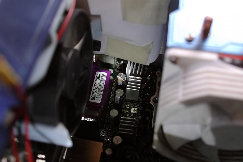

    One bad cap. Unstable ethernet.
    The MSI board I'm running right now seems to have a single cap that's venting for the VRM's.
    The system is rock solid aside form the ethernet constantly burping. Sure I can recap it but you think that might be the culprit for my ethernet woes too?

    Probably won't fix the problem. Can you check for more KZG near the ethernet chip on the board?

      Re: One bad cap. Unstable ethernet.
      I think it could be, that one is visibly showing symptoms but maybe more of the KZG's are out of spec but not showing symptoms. Looks to be a lot of them...doesn't hurt to reinstall/update the driver though.
      Is it getting clean power from a good PSU?
        The corsair 550 watt PSU is in fantastic condition still.
        Aside from all but my rear USB ports locking the system instantly when used I have not had any other issues with the board since a reinstall a month ago. The cap was spotted a day earlier while blowing out the insides.
          One bad cap is all it takes...and a flaky ethernet is a common symptom (any onboard device can become unstable under this circumstance). Replace all the KZG's, and I'll lay odds that the board will be spiffy afterward.
            Advice taken.
