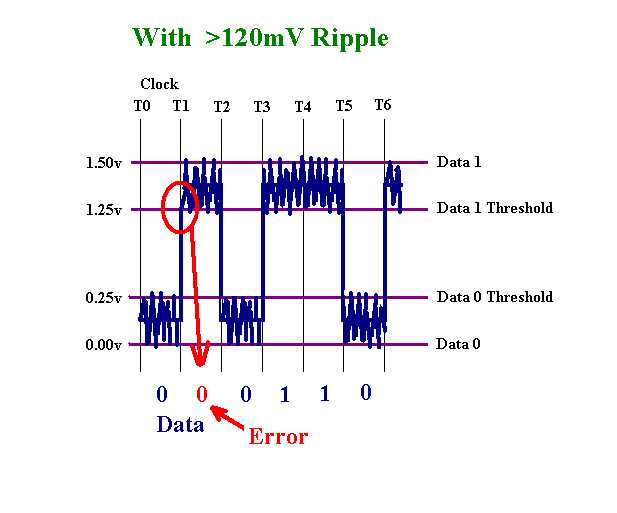

                  Yes to all of that.
                  I think without pics/drawings it might be a little over the OP's head at this point though.
                  Mann-Made Global Warming.
                  - Dr Seuss
                    #69
                    Re: Question about 85c caps vs. 105c caps
                    Here's some quick-dirty oversimplified drawings that should help get the idea across.
                    The 'No Ripple' one shows the correct Output from some IC chip.
                    If Data is "0" then volts has to rise to threshold [1.25v] to become a Data "1".
                    It's where volts is on the clock pulse that matters.
                    If at time T1 the ripple keeps the voltage below the 1.25v the Data won't change to a "1" and you'd get a data error.
                    If the Data is a file going to the drive you get a corrupted file.
                    It's not a mis-write so the drive isn't going to try and fix it.
                    There is nothing wrong with the drive, it just got bad data to save.

                            The rise time doesn't have much to do specifically with Ripple corrupting a signal which was the point of the drawing.
                            Like I said that was quick and dirty. I used MS Paint.
                            If you wanna do up a prettier more detailed one then go right ahead. {I'll look...}
                            120mV Ripple is the ATX 12v spec. That's why I chose it.
                            With 5v signaling 120mV ripple isn't that big a deal because there's a lot of room to the threshold.
                            - Which is why old Mobo/CPU's like 486 that used 5v signaling for everything didn't need scads of low ESR caps.
                            5v signaling would be harder to show the Ripple related problem and it isn't used that much on mobos anymore anyway.
                            AGP was down to 0.8v before it faded out.
                            PCI can be either 5v or 3.3v but, while add-in cards are often 5v, onboard chips on the PCI BUS are most always 3.3v.
                            DDR2 uses 1.8v
                            Chipsets use a sundry of signal voltages down to at least 1.5v
                            I was actually thinking of [a fairly modern] CPU when I picked 1.5v volts.
                            More or less a random pick of legit values that would show what I wanted to show.
                                  Originally posted by PeteS in CA View Post
                                  Like I said, old school +5V TTL.
                                  Granted that I went further afield, noise is noise, whether it comes from inadequately filtered P/S ripple, or inadequately decoupled ICs. In some ways the latter can be nastier, as it might not be visible with an oscilloscope.
                                  Agreed but it's better to explain one thing at a time and the core question was: how can a PSU issue screw up a hard drive.
