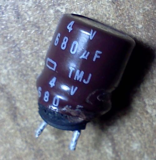

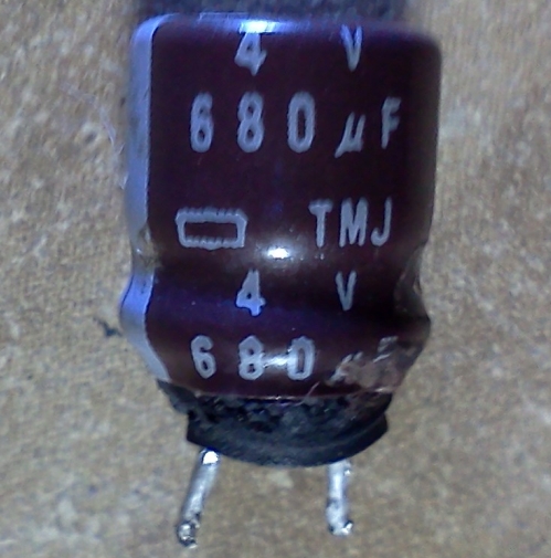

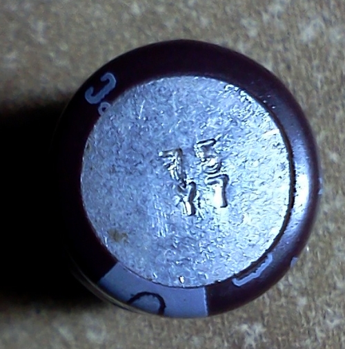

Nippon TMJ series?
  • SIDMX
    • Nov 2010
    • 165
    • Mexico
    Nippon TMJ series?
    It's from Biostar P4M890-M7 TE v7.1 that i'm recapping, it came in VRM zone, can't find any datasheets only this:
    http://www.aliexpress.com/product-fm...olesalers.html
    counterfeits anyone ?
  • c_hegge
    • Sep 2009
    • 5219
    Re: Nippon TMJ series?
    Probably a derivative of KZJ. I know TMZ is a derivative of KZG. It's probably genuine, but Nippon Chemi-Con KZG and KZJ are junk, which would explain the failure
    • SIDMX
      • Nov 2010
      • 165
      • Mexico
      Ok, thanks hegge!
      one question: It is ok to replace both of these TMJ with Sanyo SEPC polys? ...right now i dont have any other caps that fit in there.
      edit: Sanyo SEPC 560uf / 6V
      thanks in advance
      • c_hegge
        • Sep 2009
        • 5219
        Yup. In fact, Polys would have been my first chioce as replacments.
