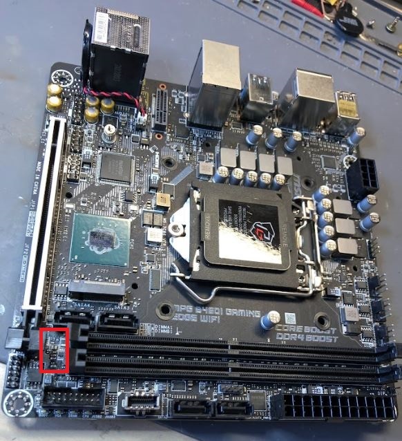

    Got his board that turns on and stays blocked at CPU led.

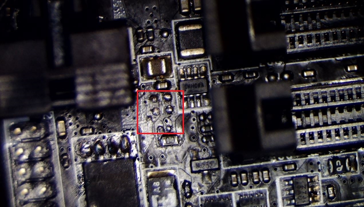

    Ive seen a resistor crushed, but I cannot get his value.
