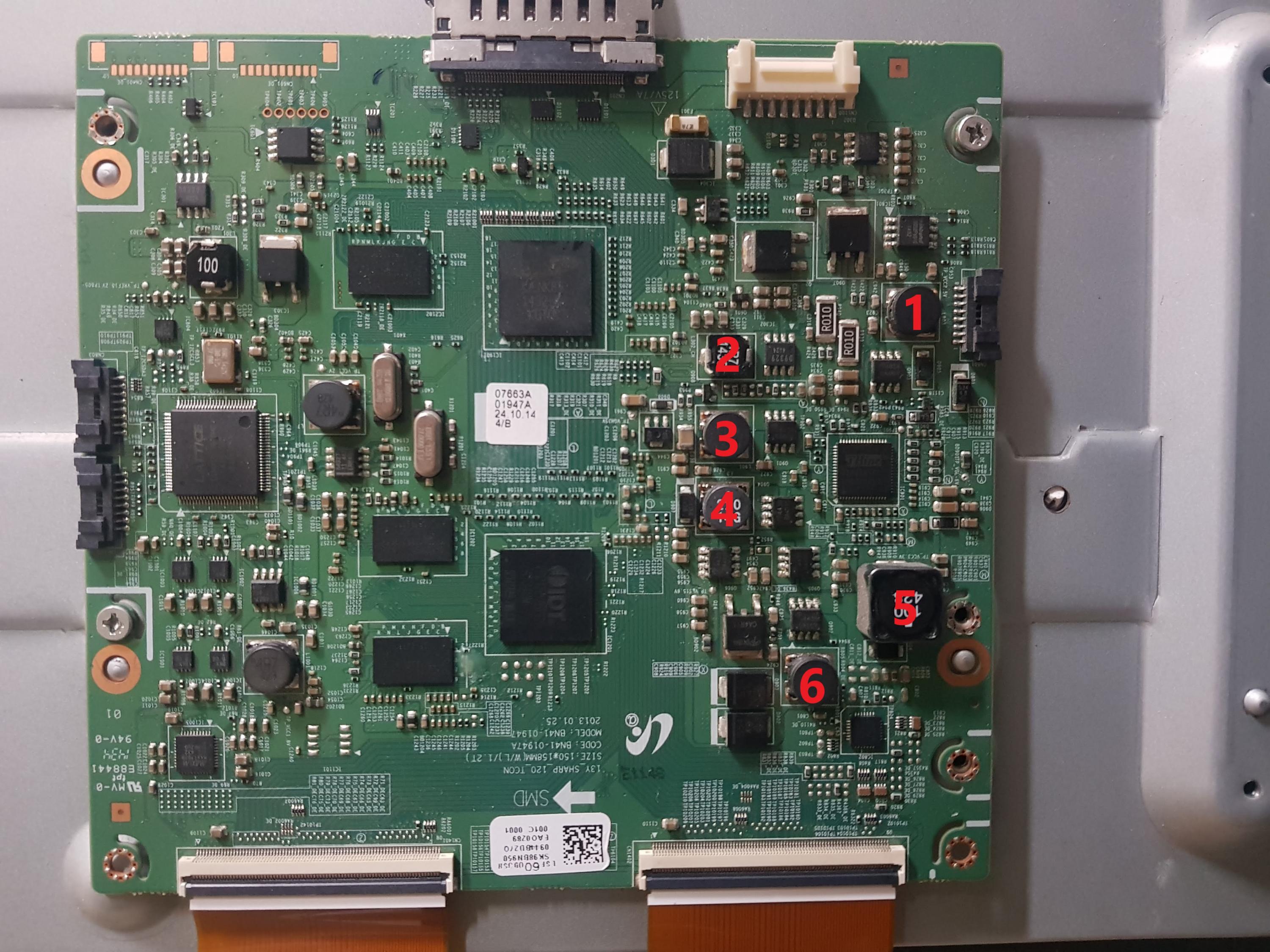

    Hi all, I have a Samsung tv that has a vertical side of the screen very dark. The backlighting is good. Doing some testing on the t-con board bn95-00944b and am not sure about the voltages i should have on the inductors. Does anyone have a list of voltages? There is one inductor that has 0v on it, while its mosfet has 15v in the gate driven by THV3056 out_vgl pin. Am guessing the thv3056 is defective. Thanks

    Attached a photo of the t-con board that has problems. These are the current voltages on inductors:
    1: 2.5v
    2: 1v
    3: 0v
    4: 15.3v
    5: 3.2v
    6: 12.3v
    Also the voltage on the main fuse of t-con board is 12.35v

      Re: Samsung bn95-00944b t-con
      On T-Cons, it happens that one inductor sits on GND, then it forms a negative voltage to power the panel (VOFF = VGL = VGOFF = VEEG = from -5V to -9V).

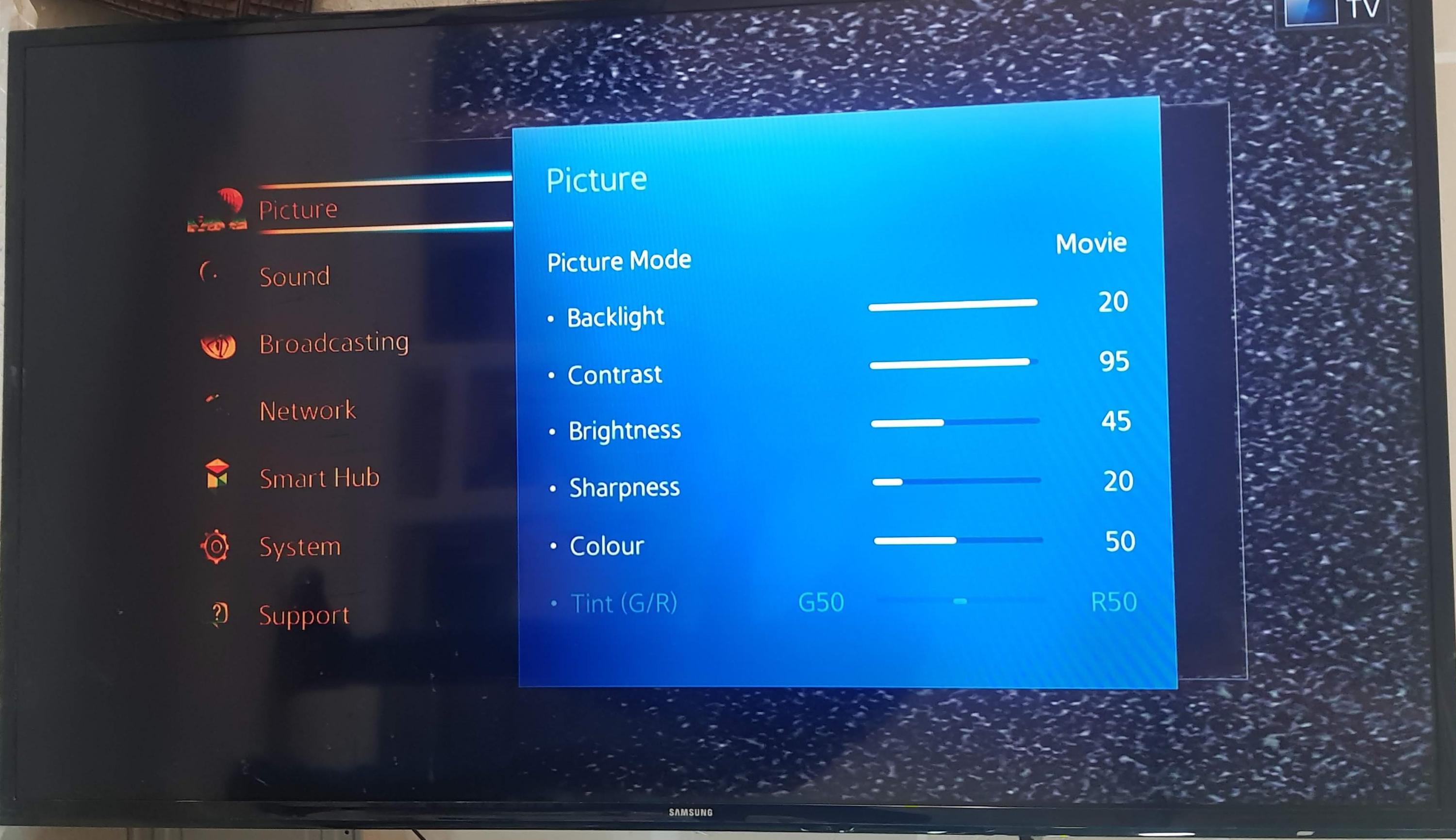

        Hi all, attached a picture of the screen with fault.
