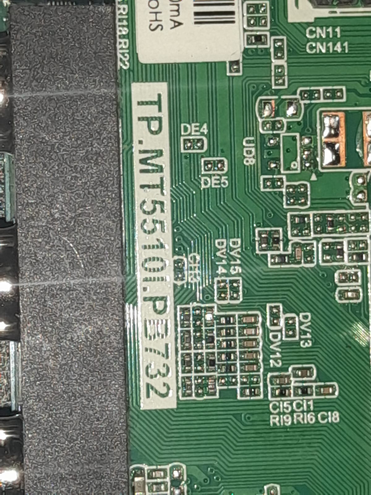

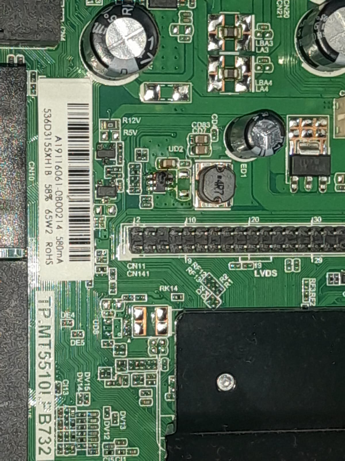

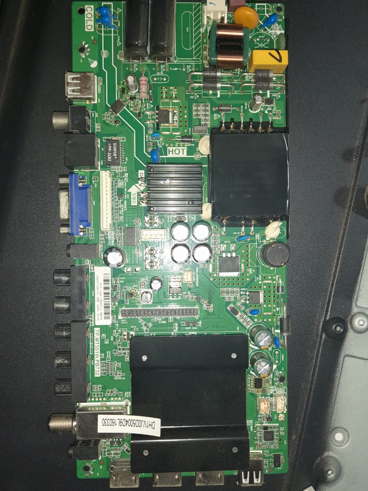

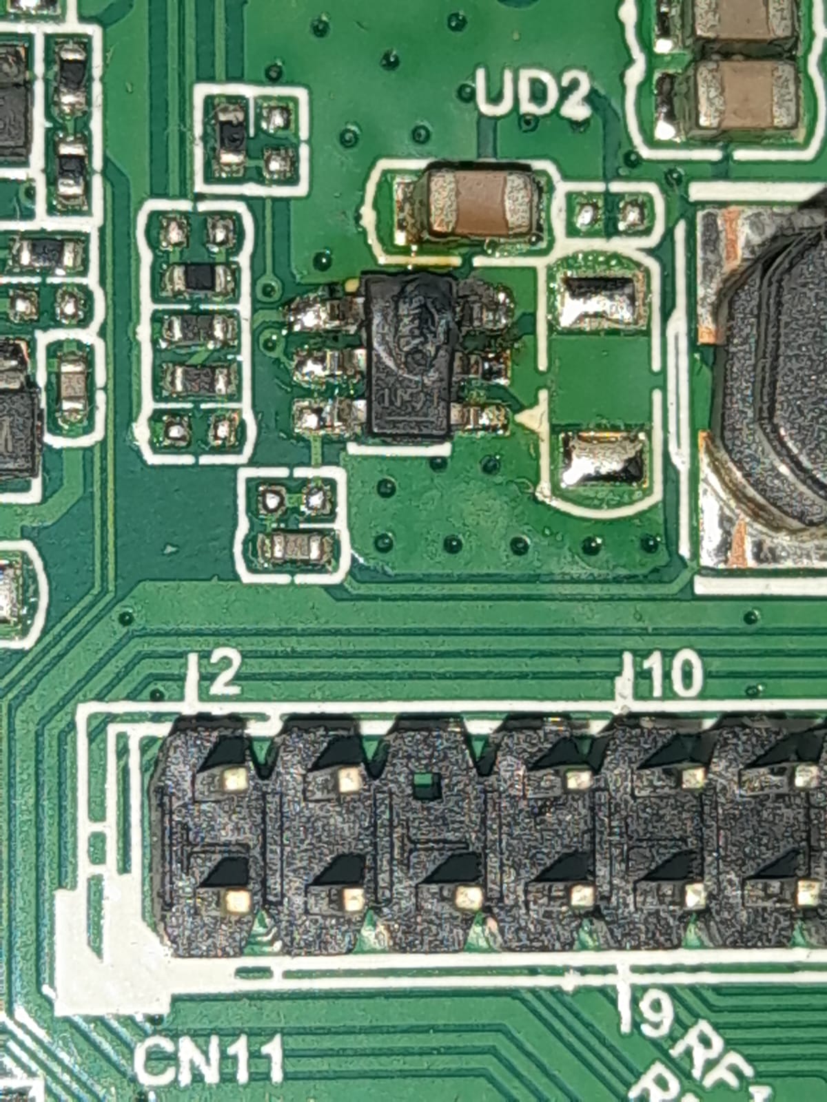

Hello everyone, I am looking for the daigram of the Haier 32" tv card tp.mt5510i.pb732
Or someone who can guide me to identify a damaged component, I attach photos

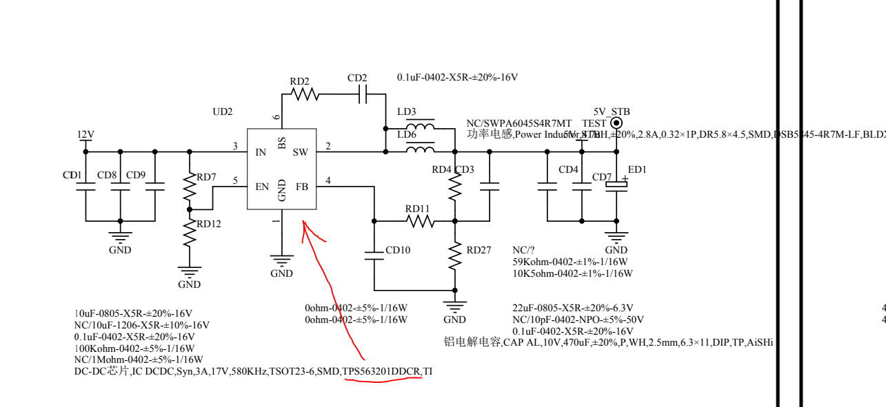

TPS563201DDCR
https://aliexpress.ru/item/100500294...00022899623522
