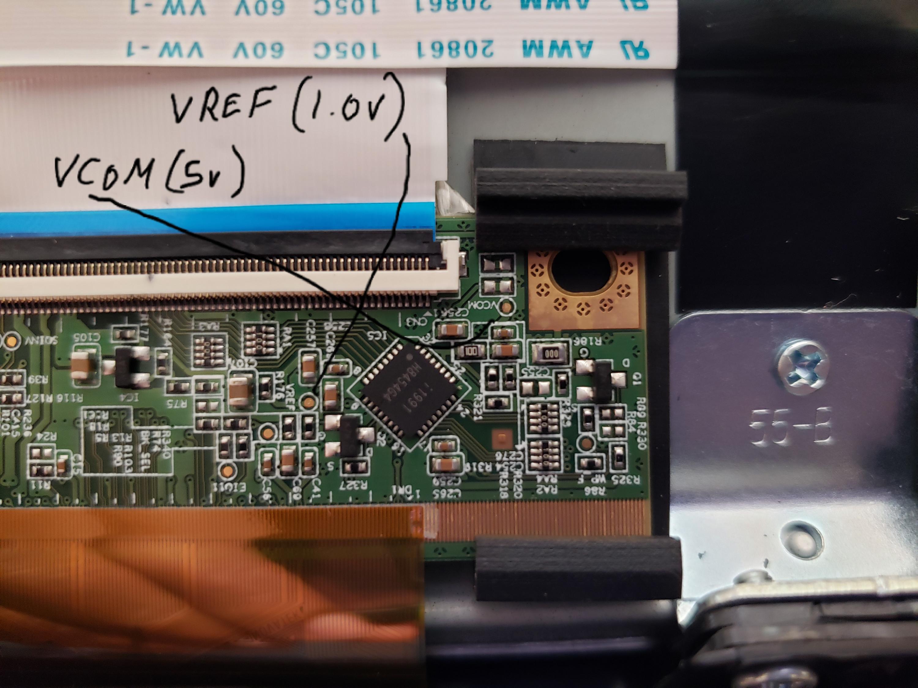

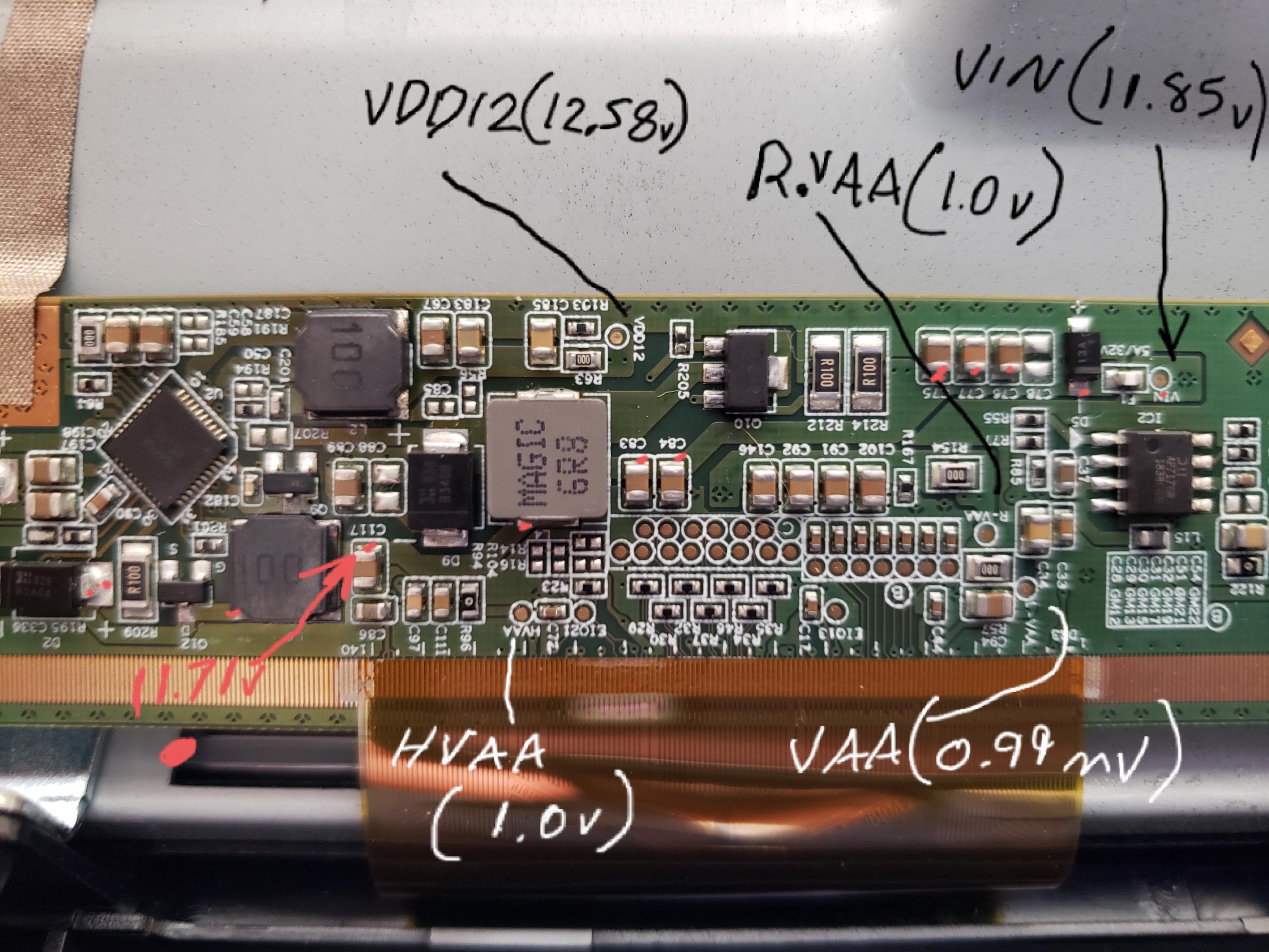

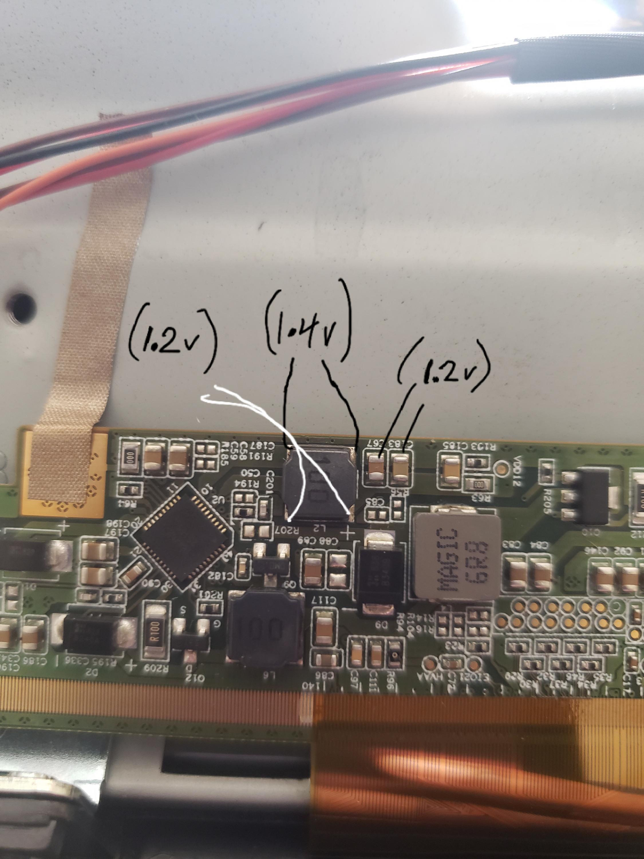

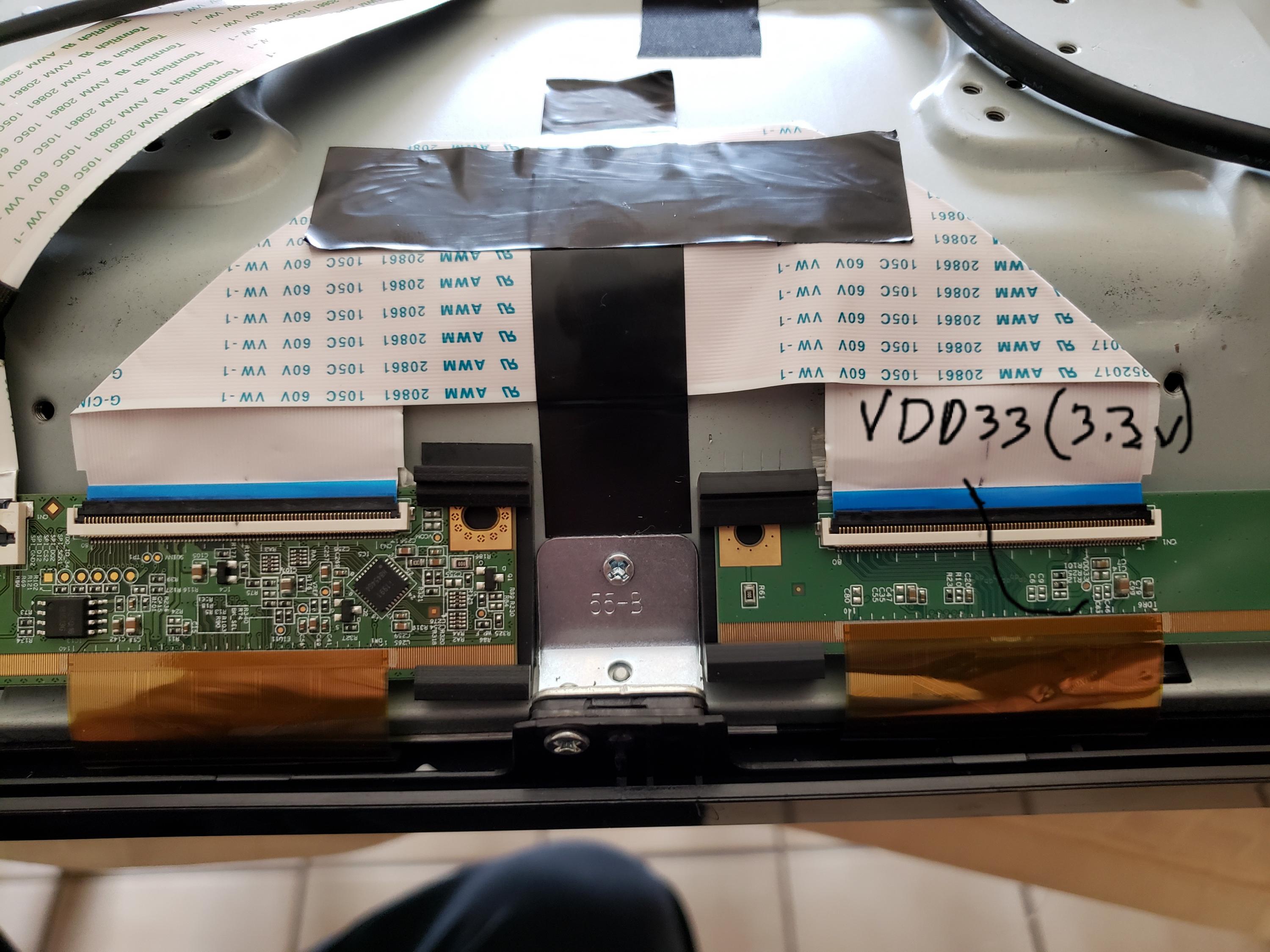

    Looking for advice concerning no picture. has back lights and sound. i have vgl -7.89. vgh low at 11.85 and no avvd voltage found, i have few other voltages marked in the pictures. Can anyone tell me which test point is avvd.
    All voltages i found are marked in the pictures. No caps were shorted, so maybe someone can point me in the right direction to help narrow the issue down

    Did you try disconnecting right side?

      yes. i also tried the tape method on each one

        If no shorts you may have a bad dc to dc IC.

          alright thanks. do you know any good web site i can order tv board smds. one more question. can you verifiy which test point in the photos is suppose to be the AVVD test point.

            Your vgh looks like vin, not vgh. There are no standard terminology for this.

              alright. il try changing the dc to dc and see what happens.

                May not be bad voltages. I would check data lines first and see if you have any voltage on them.

                  ok. i will check those out today
