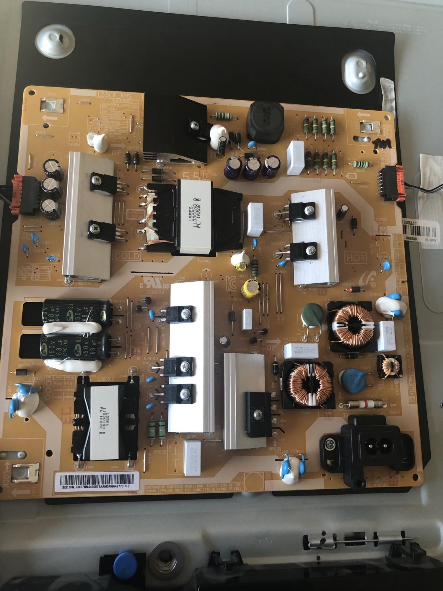

    Hi.
    I’m working on a Samsung UN49MU7000F that has no standby LED indicator.
    No POWER

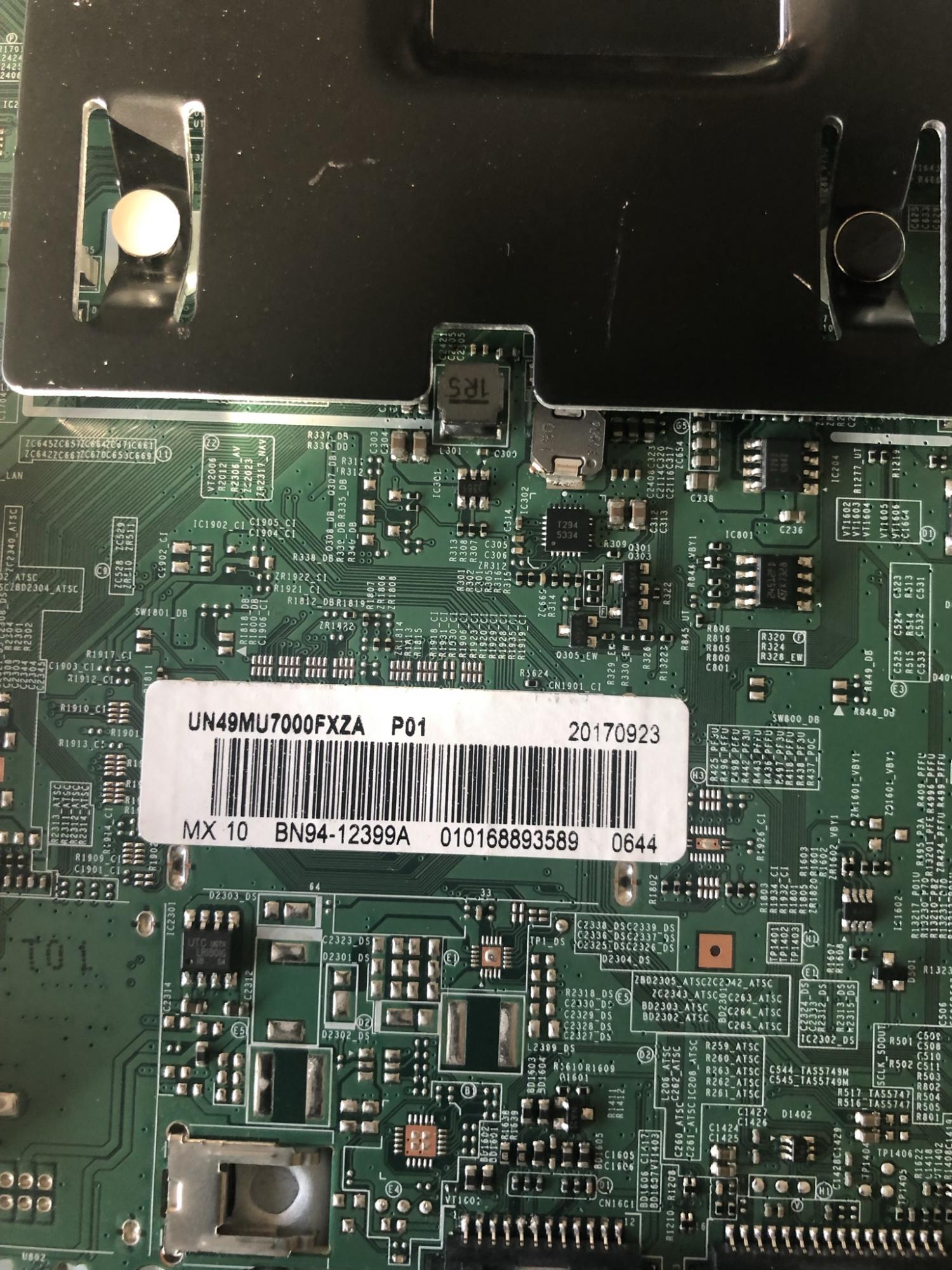

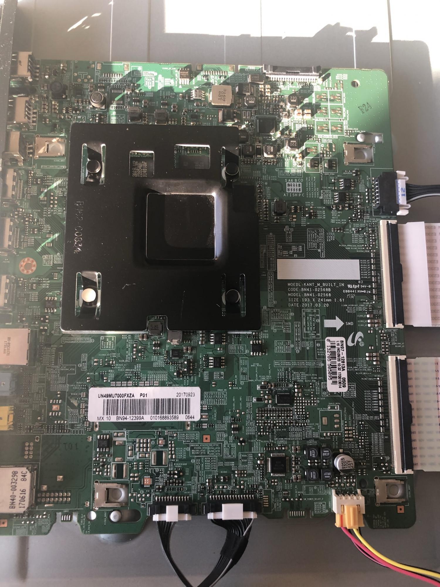

    The power supply board is part number BN44-00876A
    The main board number is BN94-12399A
    I am stuck.
    I have replaced both pwr supply and main board with no changes.

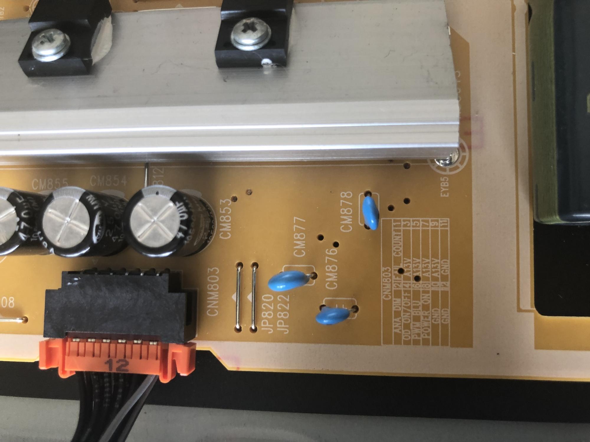

    Here are some of the readings from my multi meter on various locations on my power supply
    MAIN BOARD UNPLUGGED. BACK LIGHTS ON PLUG CNL802 85 volts
    Backlights are all illuminated and in operating range.
    MB PLUG CNM803. - UNPLUGGED
    PIN 1 FAN COUNT - Open
    PIN 2 ANA DIM - Open
    PIN 3 A13V. - 12.89
    PIN 4 OD ON/OFF - 2.163
    PIN 5 A13V. - 12.89
    PIN 6 PWM BLU - 2.106
    PIN 7 A13V - 12.89
    PIN 8 PWR ON - 1.665
    PIN 9 A13V - 12.89
    PIN 10 GND- GND
    PIN 11 GND -GND
    PIN 12 GND-GND
    STB VOLTAGE TEST POINT ON BOARD 12.89. (Should read 7.5 and 11.8)
    With MB PLUGGED IN. NO BACKLIGHTS.
    MB PLUG CNM803 READINGS
    Pin 1 FAN COUNT open
    Pin 2 ANS DIM open
    Pin 3 A13V 9.03
    Pin 4 OD ON/OFF open
    Pin 5 A13V 9.03
    Pin 6 PWM BLU 34 ohms
    Pin 7 A13V 9.03
    Pin 8 PWR ON open
    Pin 9 A13V 9.03
    Pin 10 GND. gnd
    Pin 11 GND gnd
    Pin 12 GND gnd
    STB VOLTAGE AT TEST POINT 9.03
    I’m just not sure of what voltages should be reading at CNM803.
    Any help would be appreciated!
