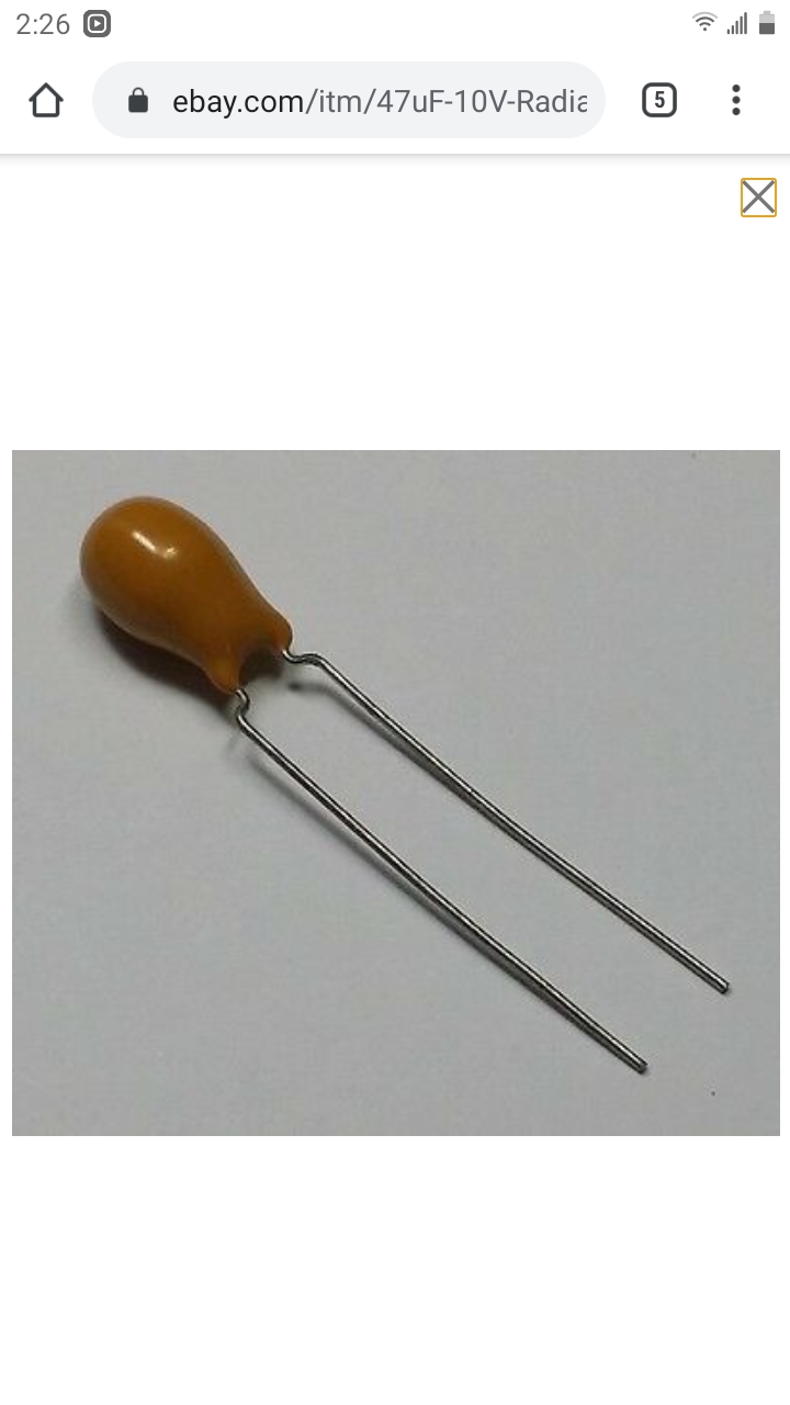

    I just ran out of my supply of 47uf 10v tantalum capacitors. I can't remember what size I bought that fits the pads, they were the perfect size. I bought some before the last batch, but they were too big and I had to attach wire to them and then solder to the board. Anyone remember what is the perfect match?

    I have Digikey 399-4981-1-ND in my inventory. Kemet 47UF 10V 3528.
    I would also recommend buying a set of plastic digital calipers for measuring components. Lots on ebay for under $10.

      I wonder if these would work, they aren't polarized. Be easy to mount too.
