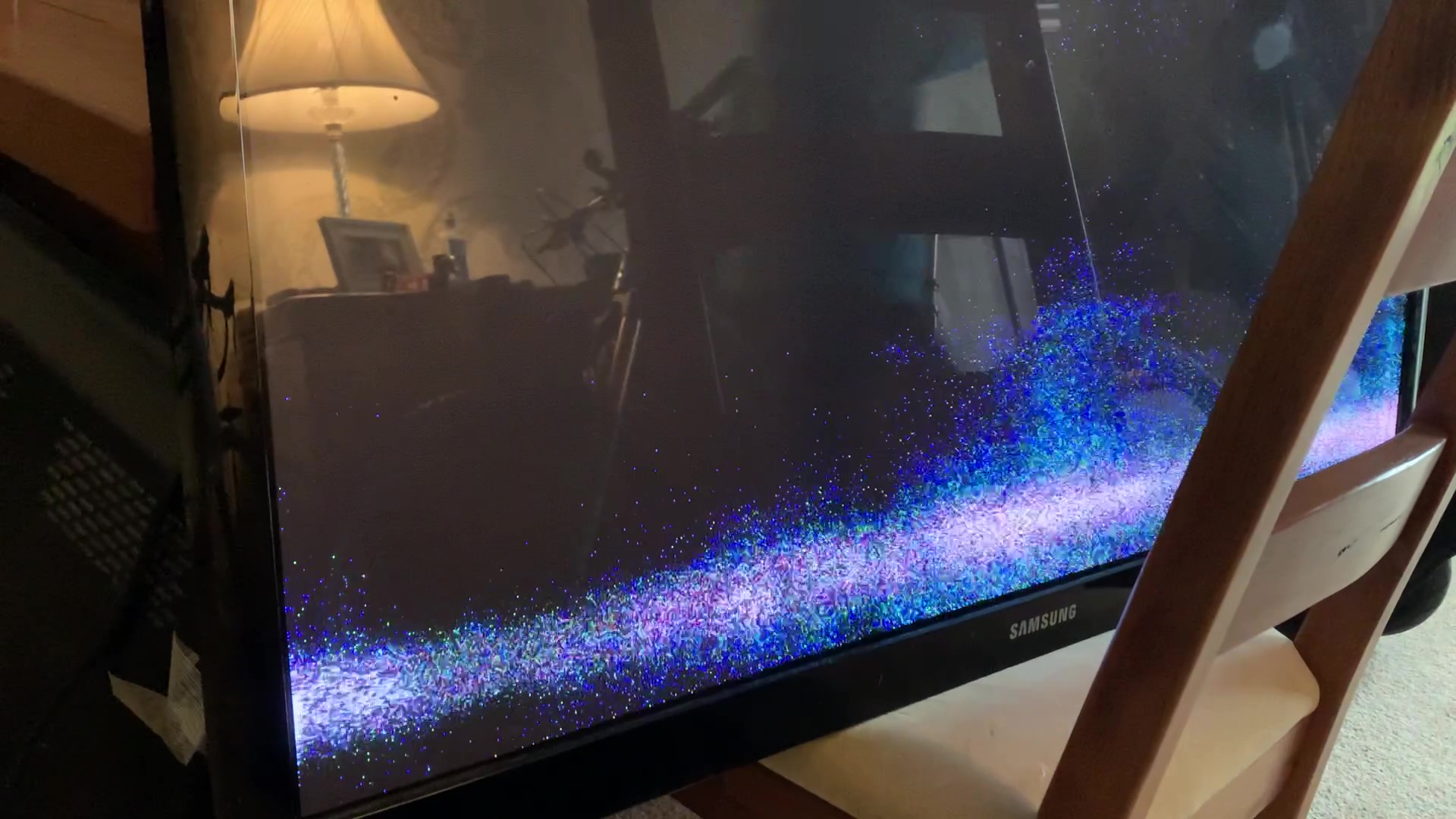

    Having messed about replacing the numerous IGBT's on both Y-Main (2 repair kits) and X-Main IGBT's which constantly blow, I decided to buy replacement secondhand boards to replace both Y and X Main. I saw the screen come up for a second or so in various colours and sparkles before pop, all four IGBT's on the replacement X-Main have blown.
    Could the panel be a fault? Is there a way to test it?
    PSU has been bench tested with dummy load across Vs.
    Vs=213v and Va=57v, all other rails are also there, 15v, 5v etc.
    Y-Main buffers tested with no s/c.
    Any help appreciated.
    Thanks.

    Added photo.
    I power down the set immediately after this screen appears on the plasma to prevent another X-Main blow up.
    Any advice?
    Thanks.
