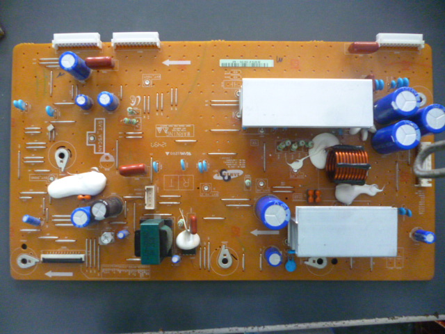

    I received a Samsung Plasma TV that does not turn on but a sound is heard when connecting to the 110 VAC socket
    By disconnecting the x-sus, y-sus, and main boar cards, I determined that the SPMS was delivering the correct voltages.
    By connecting only the Xsus, Vs stays at 208V
    Connecting the Xsus and Ysus drops the Vs voltage from 208 V to 10 V
    connecting the main board alone the voltage Vs drops below what is indicated on the label 208 V to 10V
    connecting the X-sus and the main board also drops VS to 10 V

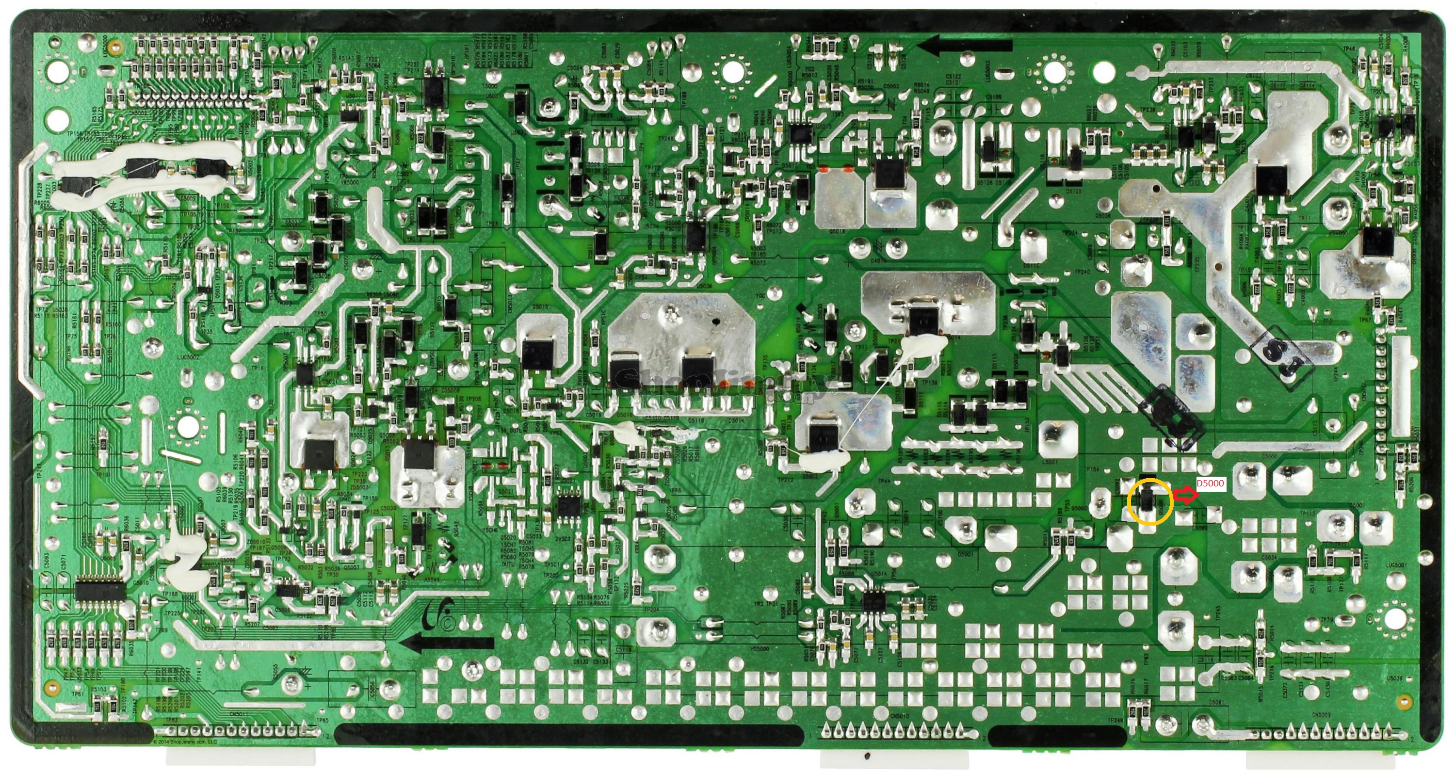

    I found some bad diodes and IGBTs, already identified from other posts in this and other forums.

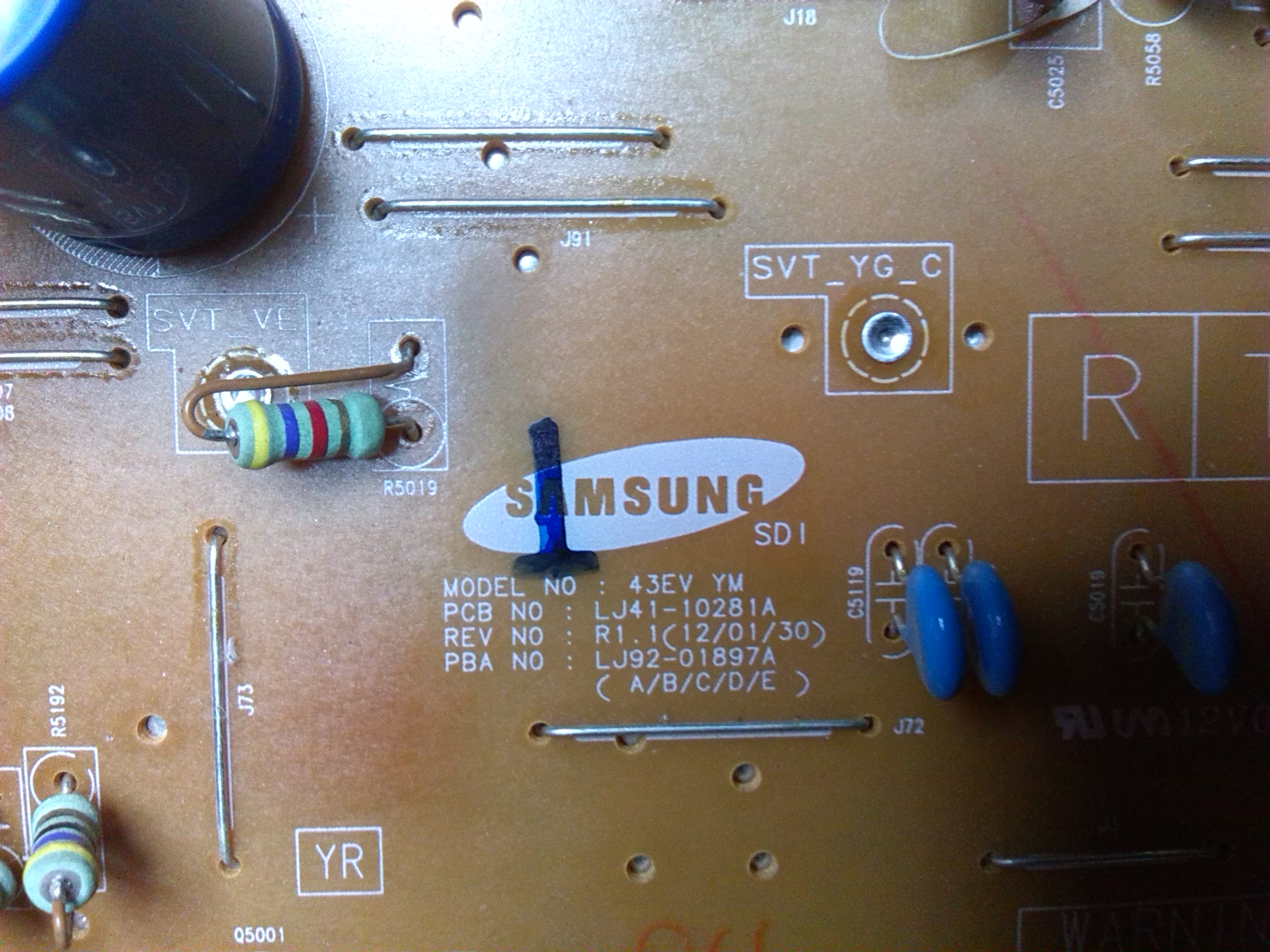

    but I still need to identify the D5000 diode that gives continuous in both directions is from a Y-sus board of Samsung plasma TV PL43E4000U1F, Y-Sus card LJ41-10281A LJ9201897 very similar to LJ41-10136A
    sorry for any error, I use a translator to communicate
    I appreciate your help
