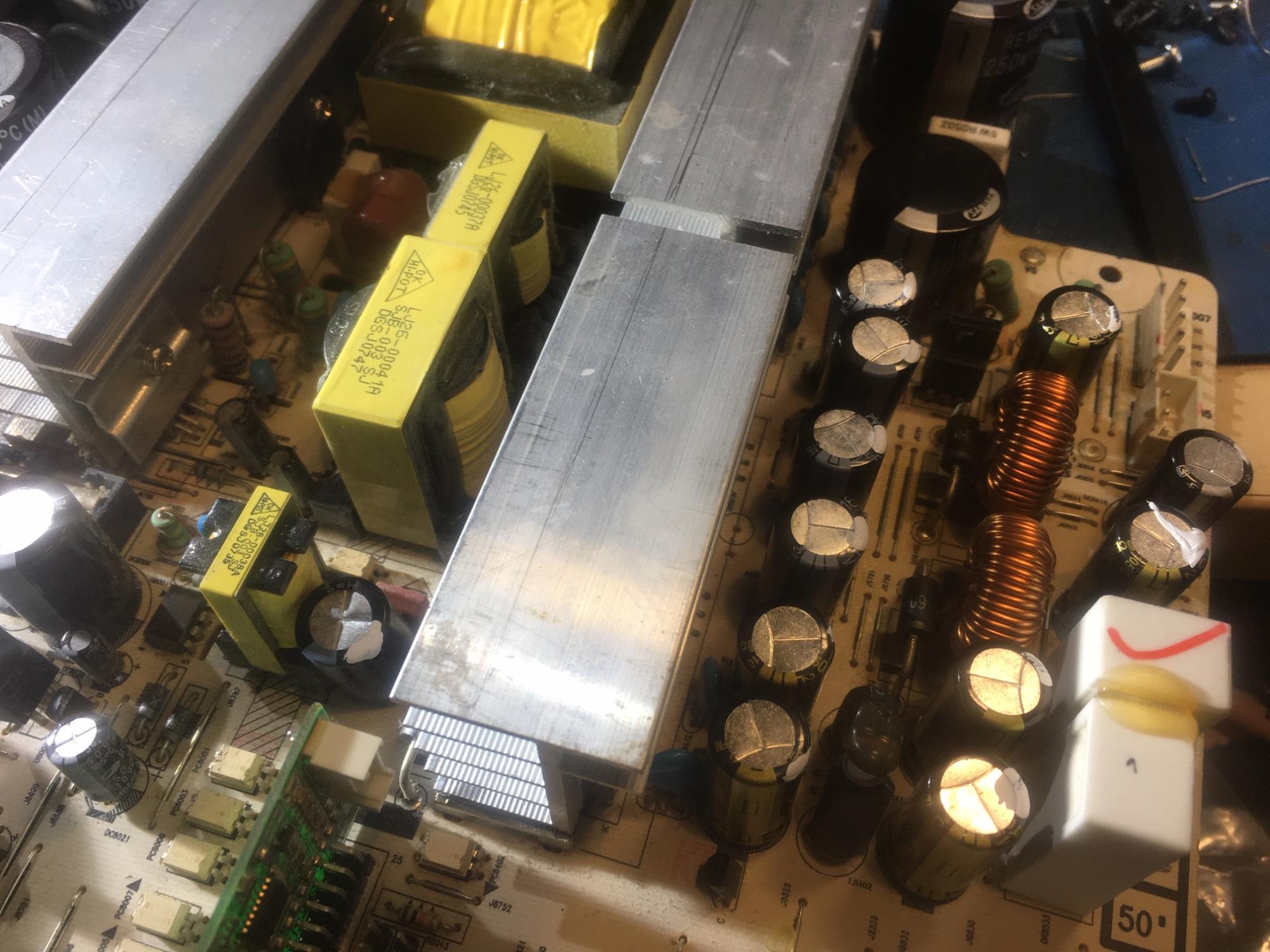

    I been tracing thru the PSU board, in or out of the TV the symptons are the same.
    The little board gives a flash code of 3 blinks which the indication of Vg.
    Front of the TV gave the indication of 2 blinks (i think).
    I replaced all the caps as per cap kit, quite a few visually damaged ones but measurements were not bad.
    I hear relay clicks, pretty quick in shutting itself down. I been following some online videos, but so far not got there, anyone have a quick tip?
    The caps with tippex/white mark on the edge are replaced.

    Re: Samsung PS-507-PHN PSU / PHILLIPS 50in TV
    How to test LJ92-01511A PS-507-PHN power supply
    https://www.youtube.com/watch?v=D0PPC9Pi0hc
