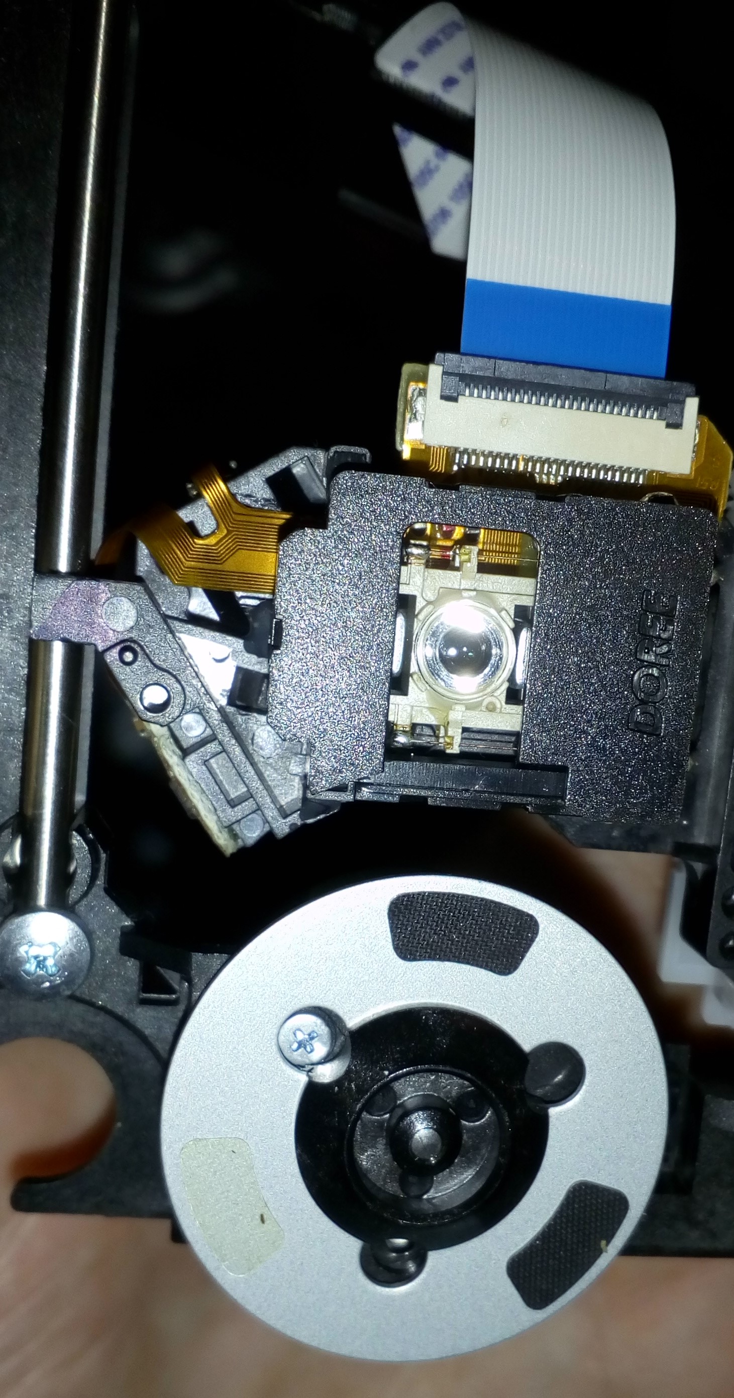

Toshiba DVD player disc stops spinning

      Re: Toshiba DVD player disc stops spinning
      Changed the cable same problem.
        See the motor that rest the DVD disc on, one of those stickers has come off. I put some electric tape on it and it plays fine.
          yep that would do it
