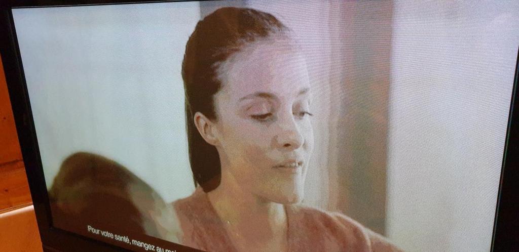

    Hi, I have a plama samsung (ps50c96hd) and the picture is very bad.
    I'm new in this forum so i edit this post, sorry for that...
    The picture :

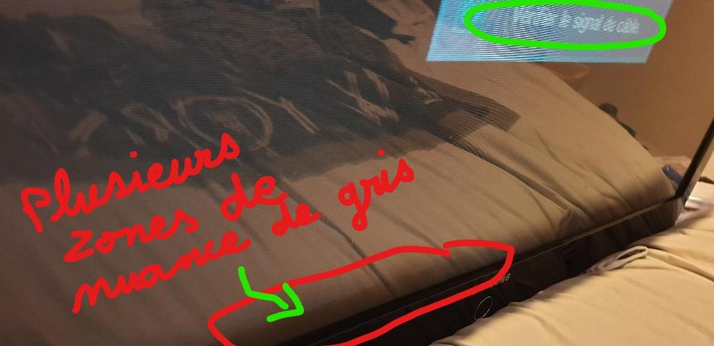

    With no signal there are grey point :
    I have control all the voltage (Vs, Vsc, Va, Ve...) all is good.
    On the Z card (on right) i just replace a bad capacitor (25v 680mf) but no effect.
    I have change the t-con module but no effect...
    If you can help me plz

    I have change the t-con (control) and the power-card but no effect.
    The problem :
    https://youtu.be/GxG9rA_kXFw
    Thanks a lot for any idea...

      Good evening, I reconnected the television without the x-main control card and ... the image remains exactly the same, there is only the sound that has disappeared. It's strange, is not it? Thank you
