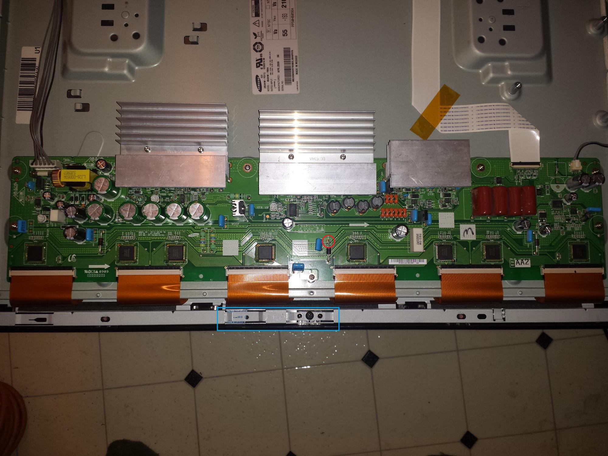

OK, show me a picture of your control board with this set up, I need to check it is all correct.
Re: PN50B450 - Turns on, Sound good, I think Backlight is good, No Picture

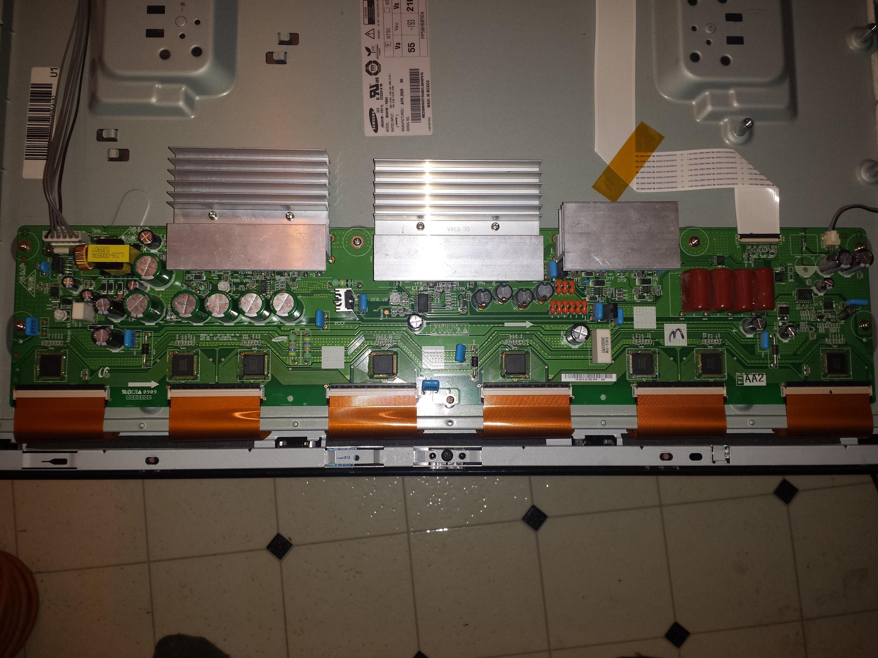

Ask and ye shall receive. Still no Test Pattern, the included photo is what I did per instructions.
I received the Y-Main repair kit and have begun replacing sets of FETs. So far, I have replaced both IRFP4332 and the one in U5407 still gets ridiculously hot.

OK, looks good
With this setup still connected as is, please try to check the Vsc voltage on the Y-main.
Also, we need to check Vsch, for this, we will need to see a clear picture of around the scan drive ("buffer") chips on the Y-main.

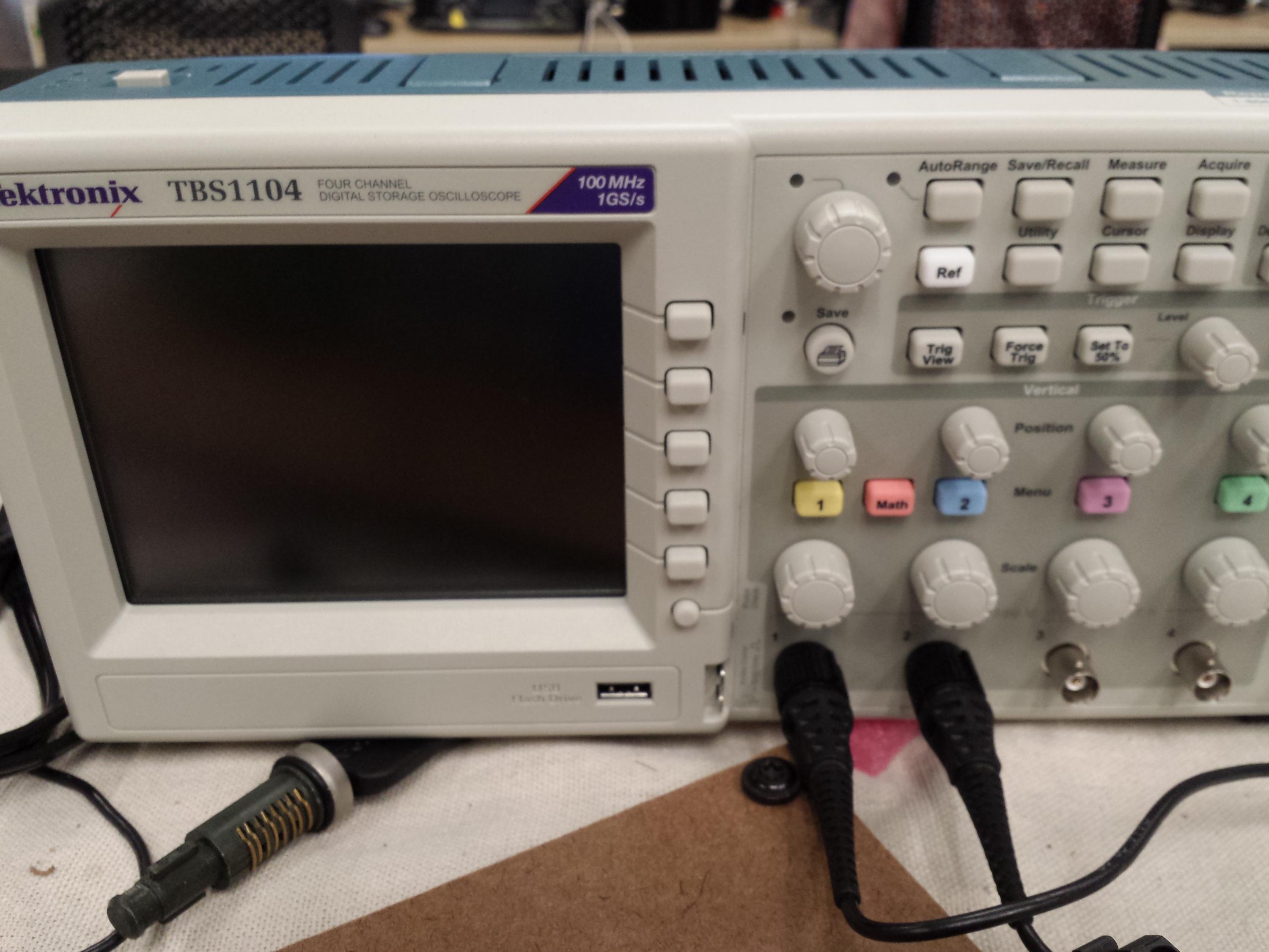

Also, do you have any access to an oscilloscope?
That's the address buffer
OK, scope is good. Show me a pic of what you got.
Sorry...meant the scope!

Sorry, got delayed...
See this
Scope probe tip (using hook) on red area
Ground on black area. Make sure it's secure.
Caution: Sustain output is up to 400V DC! Keep hands well away during probing, and make all probe changes with TV power off.
Scope probe on 10X.
Scope V/div on 10V/div, make sure scope is also set to 10X.
Timebase 50ms/div, trigger AUTO, type EDGE or LINE, source LINE (if EDGE).
Connect to Ch1 and enable and run the scope then stop it when you see something.
Show me what you get with the set powered on in test pattern mode.
