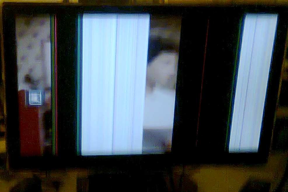

    I have a Samsung P2770HD TV/monitor. A year ago the power supply went. I taught myself enough to be able to determine there were bad caps, and taught myself to solder in some new Rubicons from DigiKey ... All seemed well again.
    A short while later, a thin (e.g. 1 pxl) vertical line appeared. As time went by, some more thin lines of various colours appeared.
    Then, entire vertical bands appeared, about 6 cm wide (appear to be the same width as the connectors inside on what I believe is the T-Con board). Some of the bands are black, while others a collage of colours. Some of the bands will be black on some occasions, and collages on other occasions on power-up.
    The behaviour of bands is the same whether in TV mode or attached to PC.
    From what I have read on this forum, I am guessing this means a bad T-Con.
    I have "fiddled" with various cables, inspected boards, etc, but cannot see any obvious issues, or have any effect on the "bands".

    1) Attached is a picture of the "bands".

    This looks like a bad Panel. You could remove clean and re-seat the ribbon cables from the T-CON Bd to the panel and clean and re-seat the LVDS cable from the Main Bd. to the T-CON, as well.

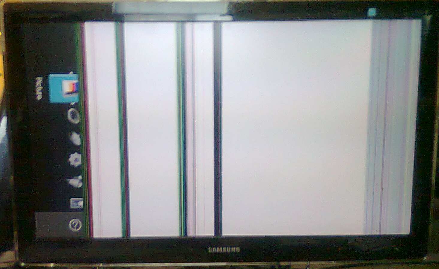

        OK, had a go at removing the panel from its metal "inner frame" so I could inspect how/whether I might clean/re-seat the ribbons from the T-Con to the panel.
        In the event, those ribbons are "glued" both on the T-Con and "panel/LCD/LED" side.
        I did clean the LVDS ribbon on the T-Con side. I did "un-lock" the ribbon on the logic board side but it did not want to come free, and did not wish to force it.
        ... put it all back together, and the result is per the attached jpg. Namely:
        1) what were "black bands" are now all "white bands"
        2) most of what were "coloured bands" are now "white bands"
        3) one "previously working band" is now a "white band"
        ... there is one "working band" left, so in a sense it seems to be worse now compared to "pre-cleaning".
        ... well, I have a nice LED Lamp/1080p radio :-)
        Should I take this to mean the panel is "toast", and not repairable?
