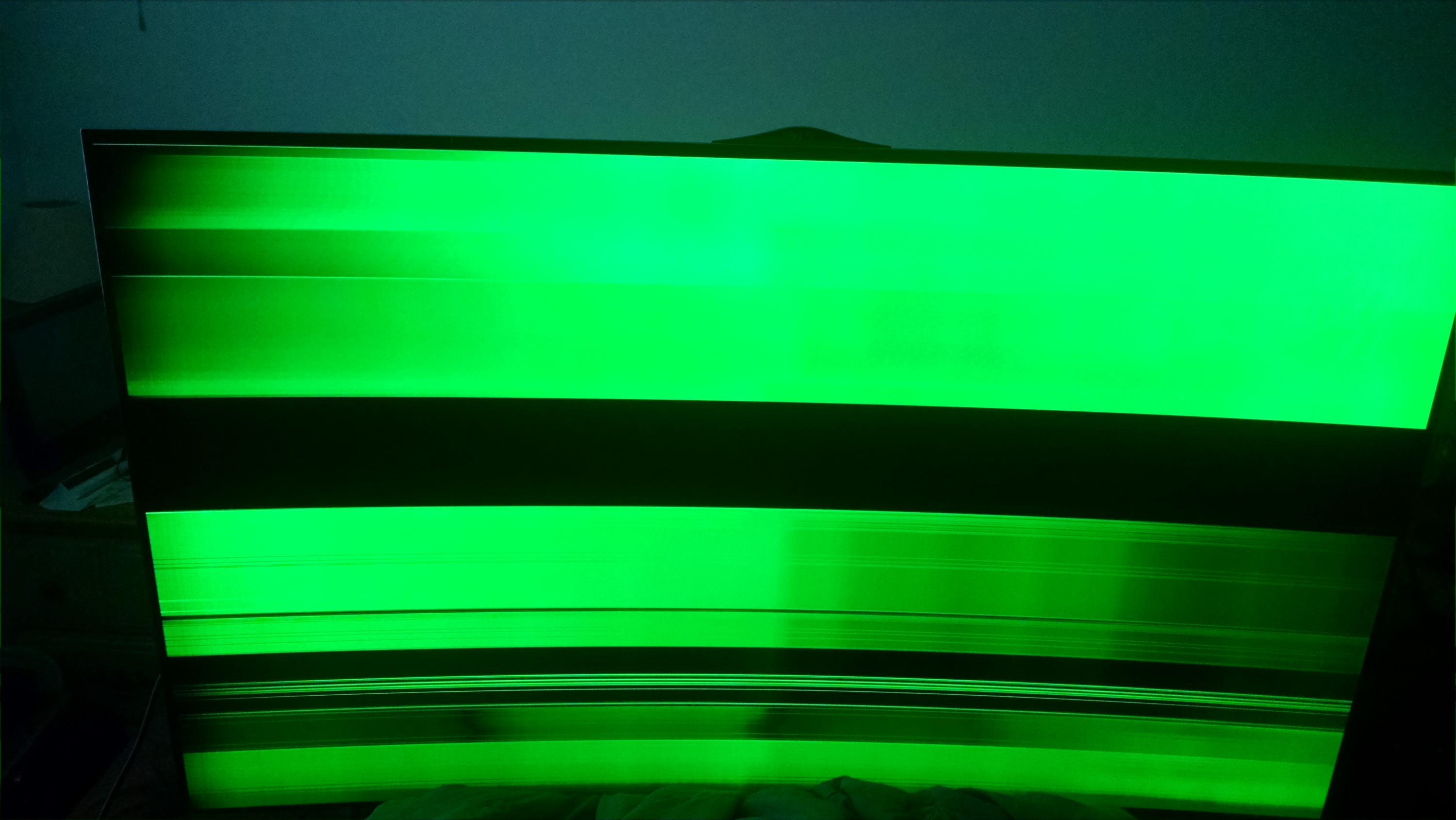

      Yes I did the test exactly as you said.
      this time the screen was green when it stopped changing colors, but the color bands go across the whole screen, I will get a pic next time

        if you want to spend money to have replacement t-con always up to you.
        i wrote before encourage you to have access to the edge boards of the panel. its easy just remove speaker and metal cover... take look there who know you could find fortune at the effected side LOL. remember always with high resolution focused photos helped allot

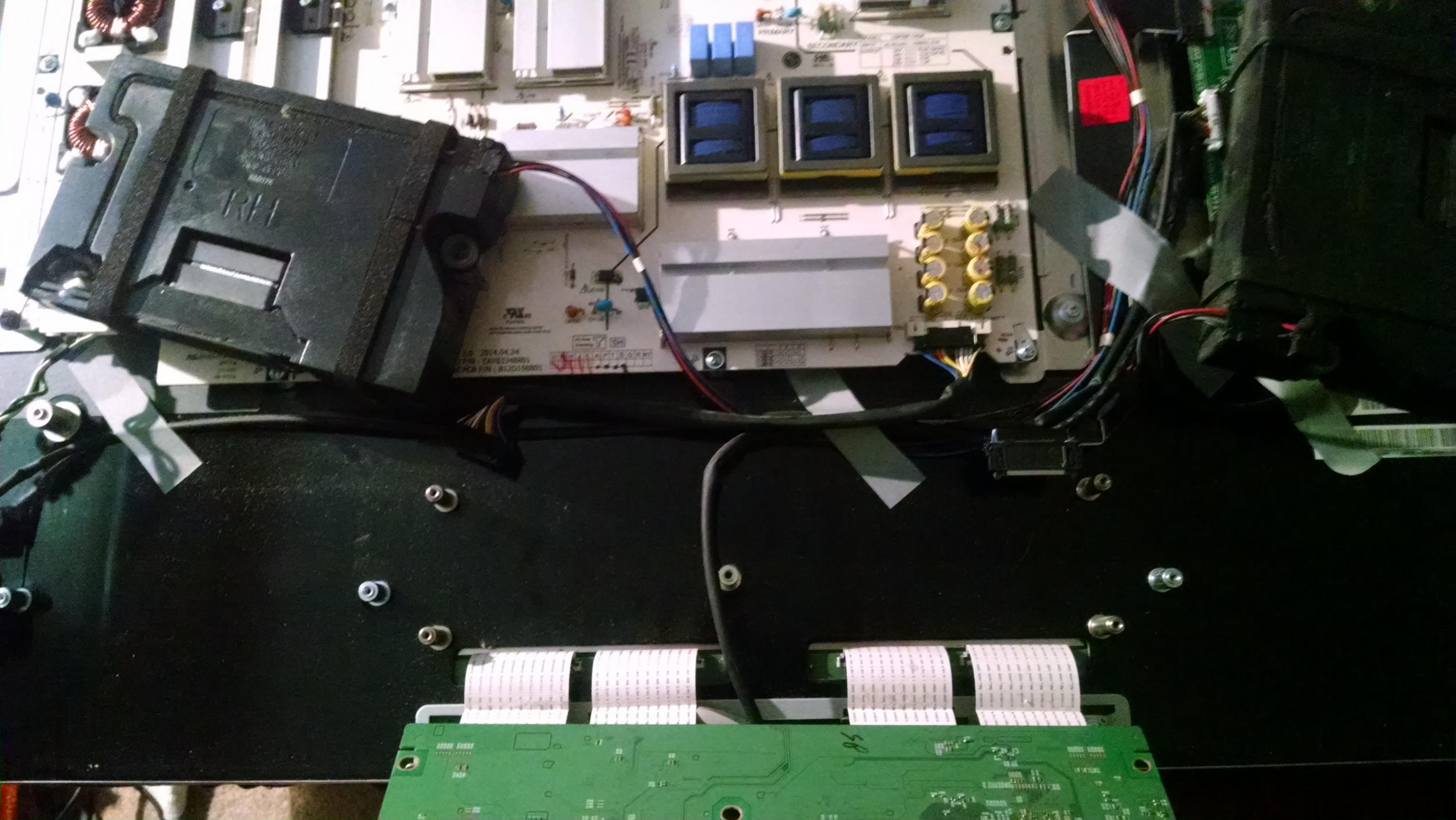

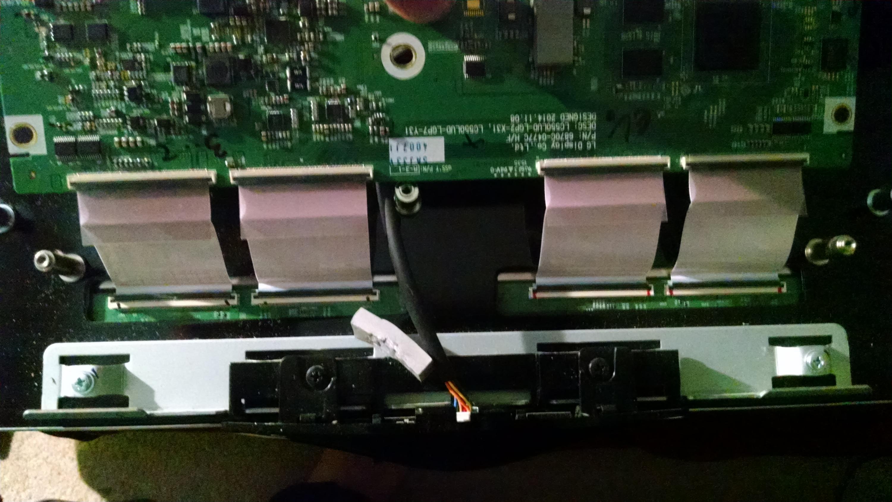

                  I was not able to access the boards, I would have to dremel the back apart to get there. I ordered a TCON as a last ditch effort, the one I received was the wrong part. There is an additional white rectangle with a number in it, and I am not sure if it has to matc (4007j) it may be a software version?
                  I let it run on self test for a while, and it started working with the old board.
                  In the service menu, the reason for power down says inv fault.
                  I was able to watch for an hour before it shut down again.
                  How do I run the pixel refresh utility?
                  The newer sets have a removable metal plate under the speakers to access the driver boards

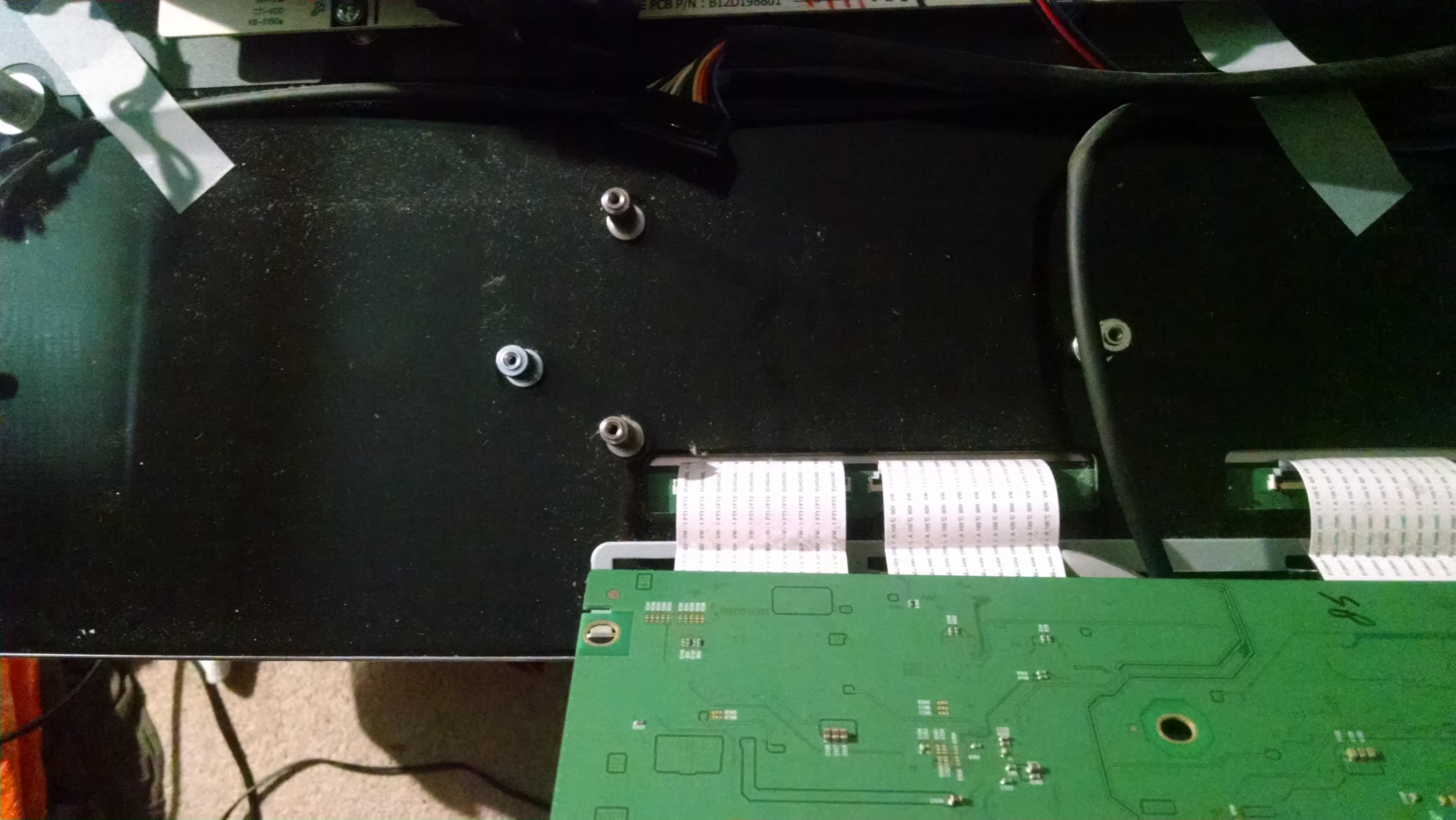

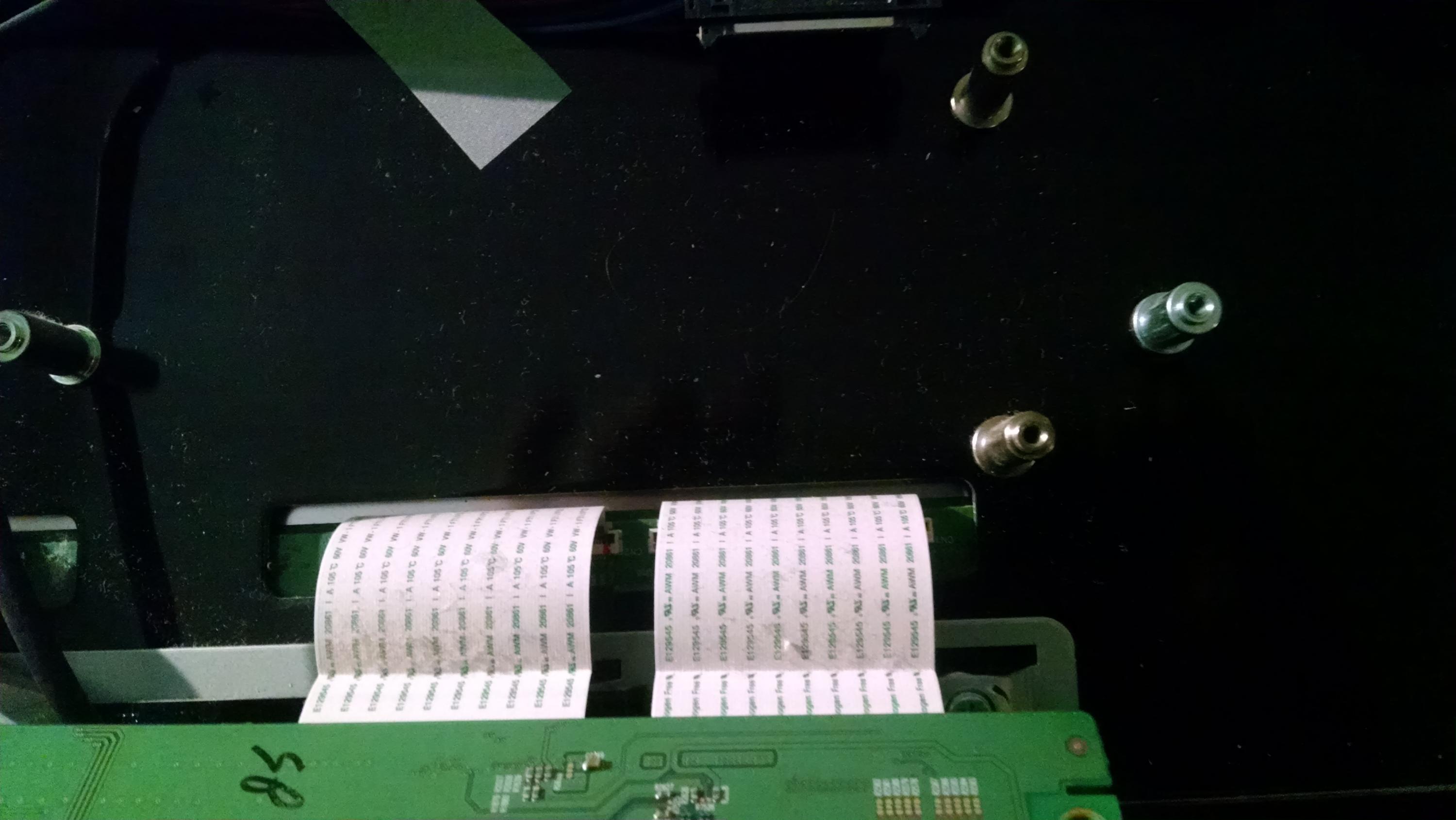

                            I was able to get pics to show that getting to the drivers would be imposible without destroying the screen.
                            Goshen NY, USA
