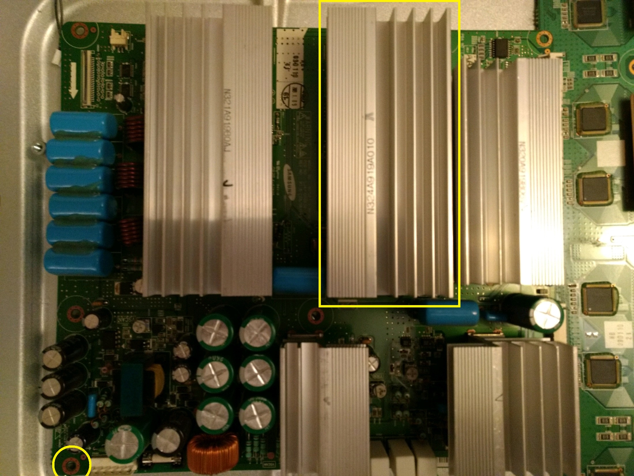

      Okay so here's what I did:
      Y-buf quick test: One probe on Y-sus connector pin, the other ran over the terminals to the display. No direct shorts.
      Y-sus test: Ground probe to ground (circled in Yeller). Touch collector gate and emitter with the positive probe on the fets under the heat sink outlined in yellow and all indicate short to ground, or very close. Other fets on the board do not do that.
      So I'm thinking at least one of the fets under that heat sink has to be shorted to ground and because its in-circuit, all of them will indicate shorted?

        That is correct. Usually rule of thumb is to replace all ones that read shorted. Even if the others were not in that same bank. Also there could be a chance that a gate drive IC has been damaged.

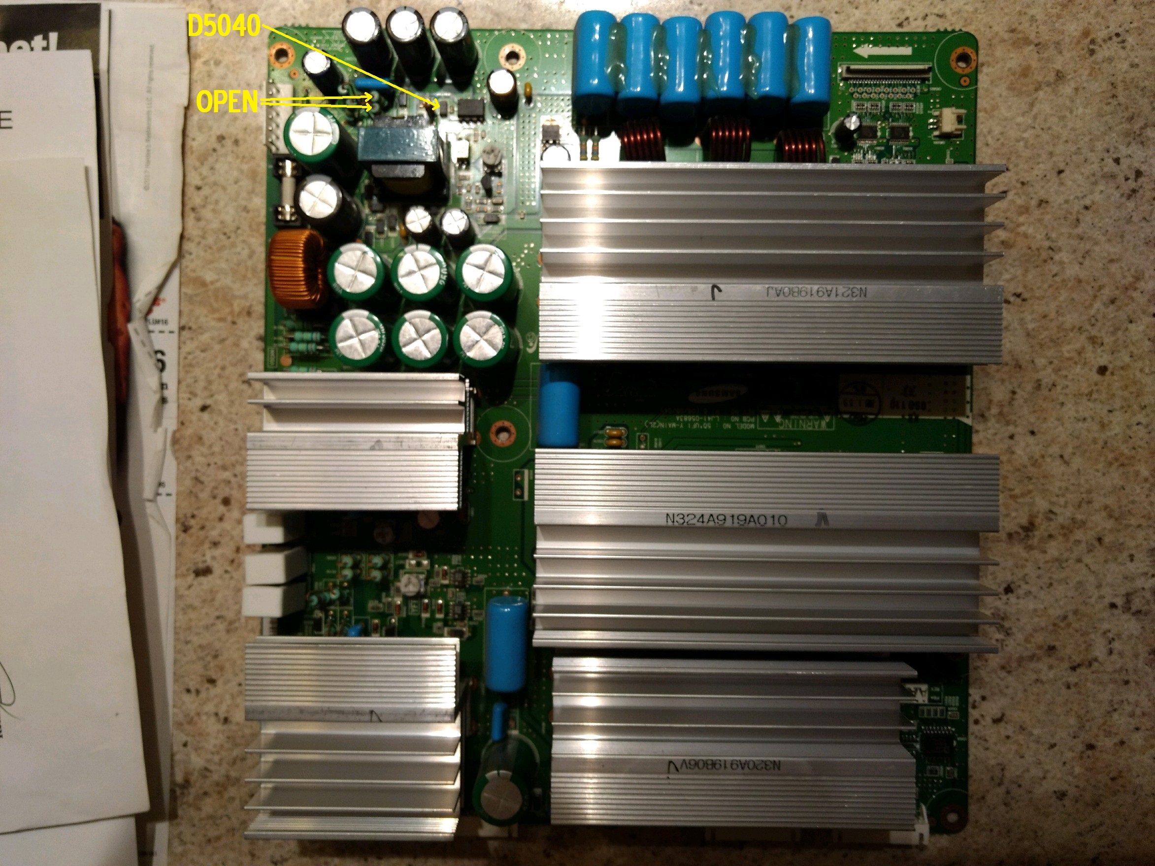

              So I pulled the Y-sus board and checked it out some more. Looks like Resistors R5117 and R5118 are open and Diode D5040 passes current both ways. Looks like the damage is a bit more extensive.....
              Can anyone tell me where the gate driver IC is and if it can be checked with a DVOM?
              They call me......."threadkiller"
