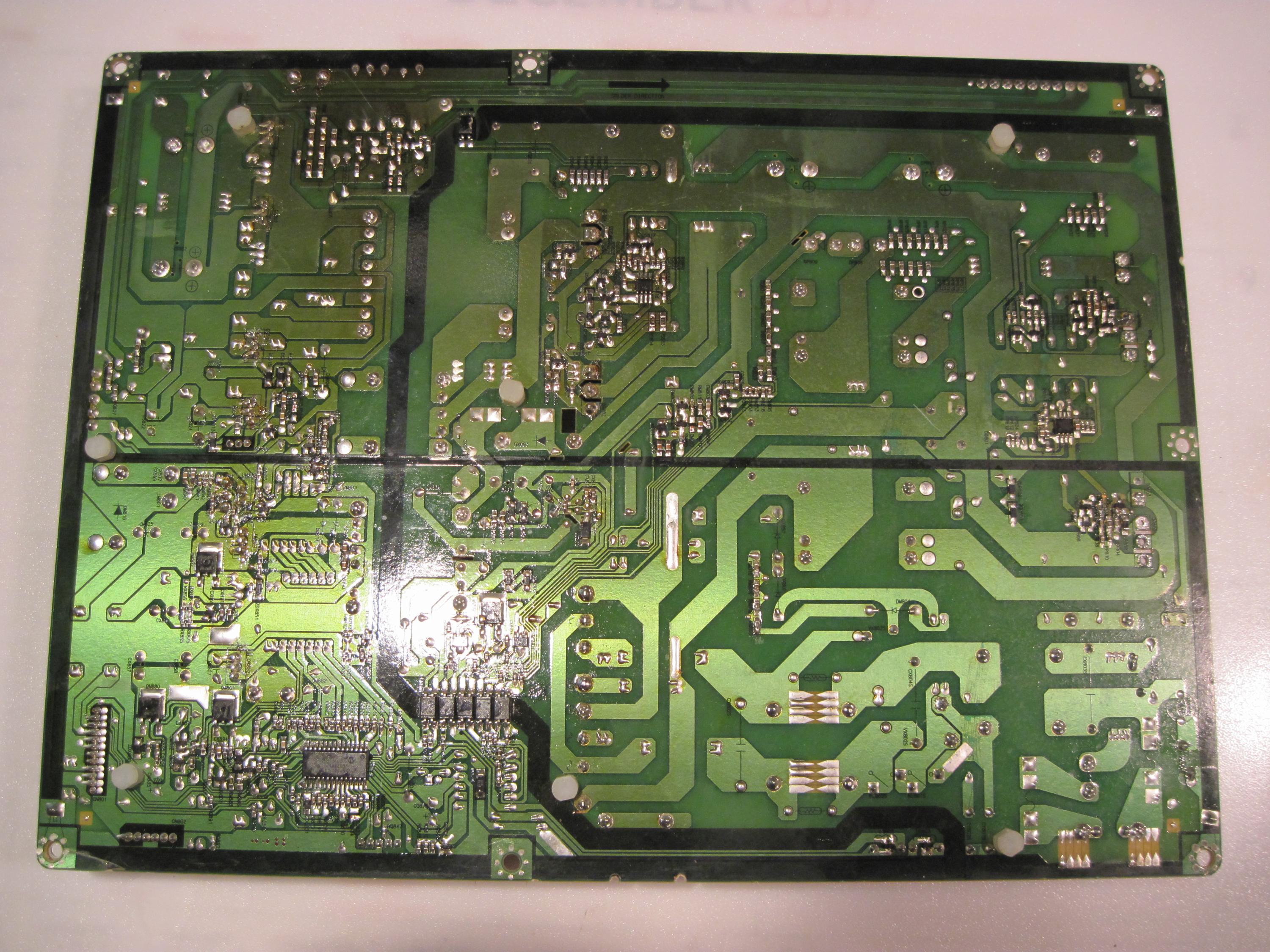

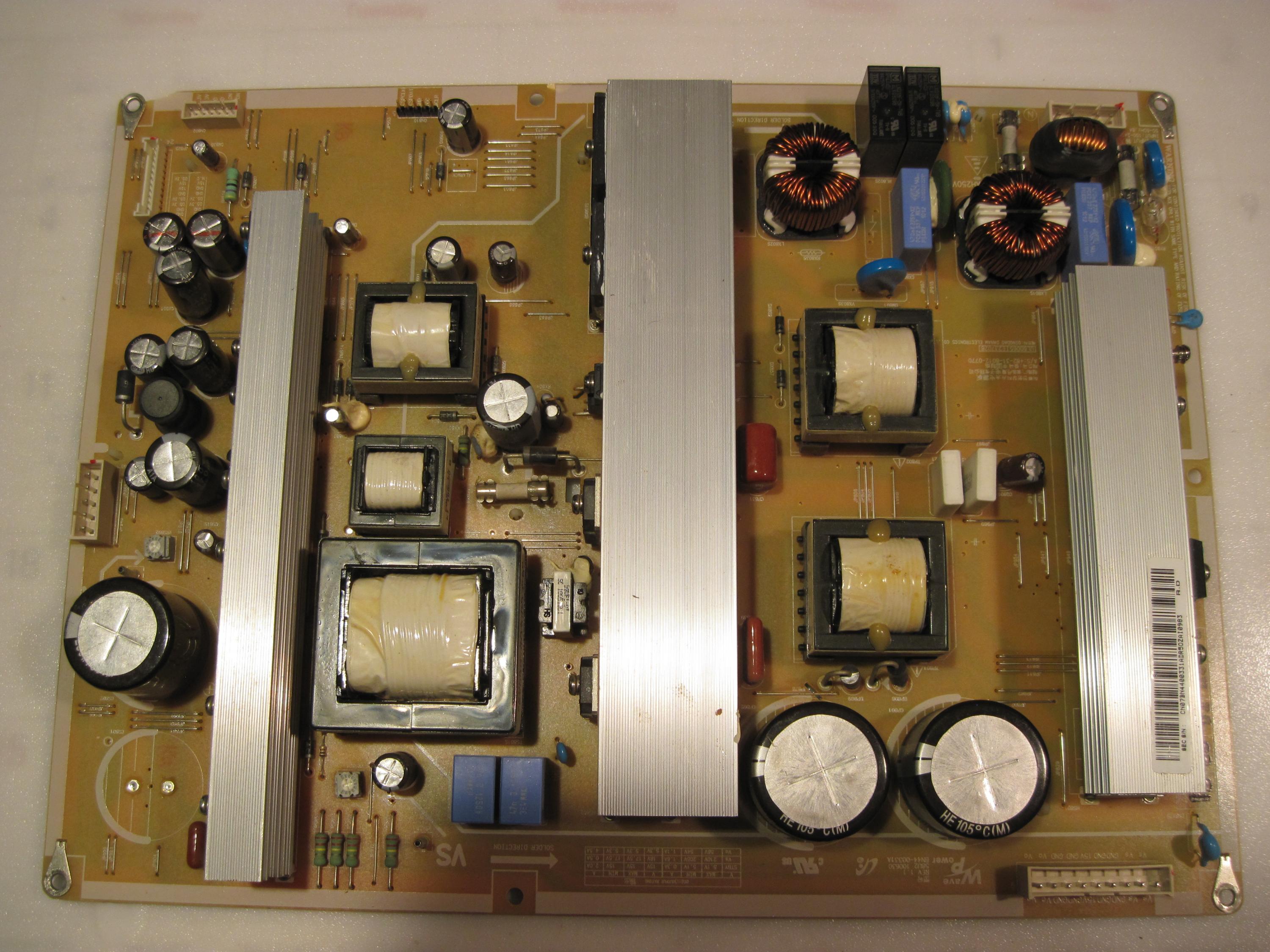

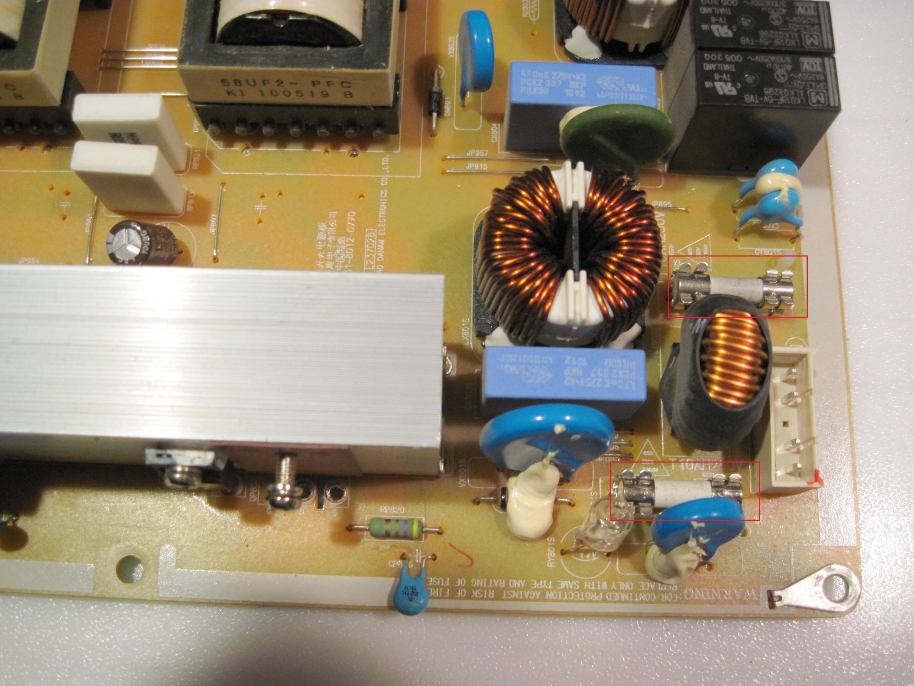

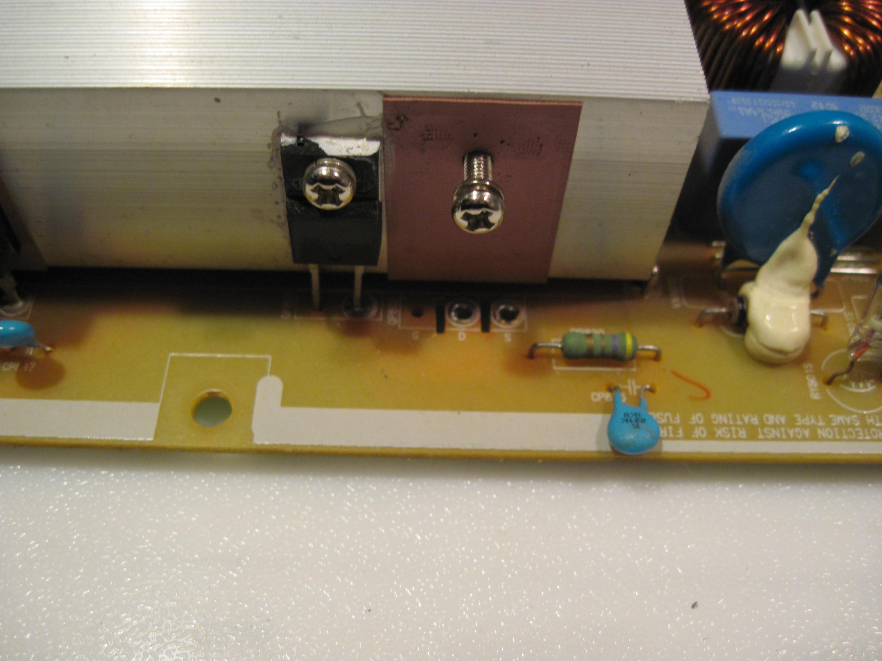

    Bought this one on craigslist for 20 bones. TV would not turn on when I got it. I found the QP802 MOSFET blown and both the F801S, and the F802s blown. The FET is a 20N60C3 I replaced it and both fuses, turned on the TV, ran for about 5 minutes, and blew it again.

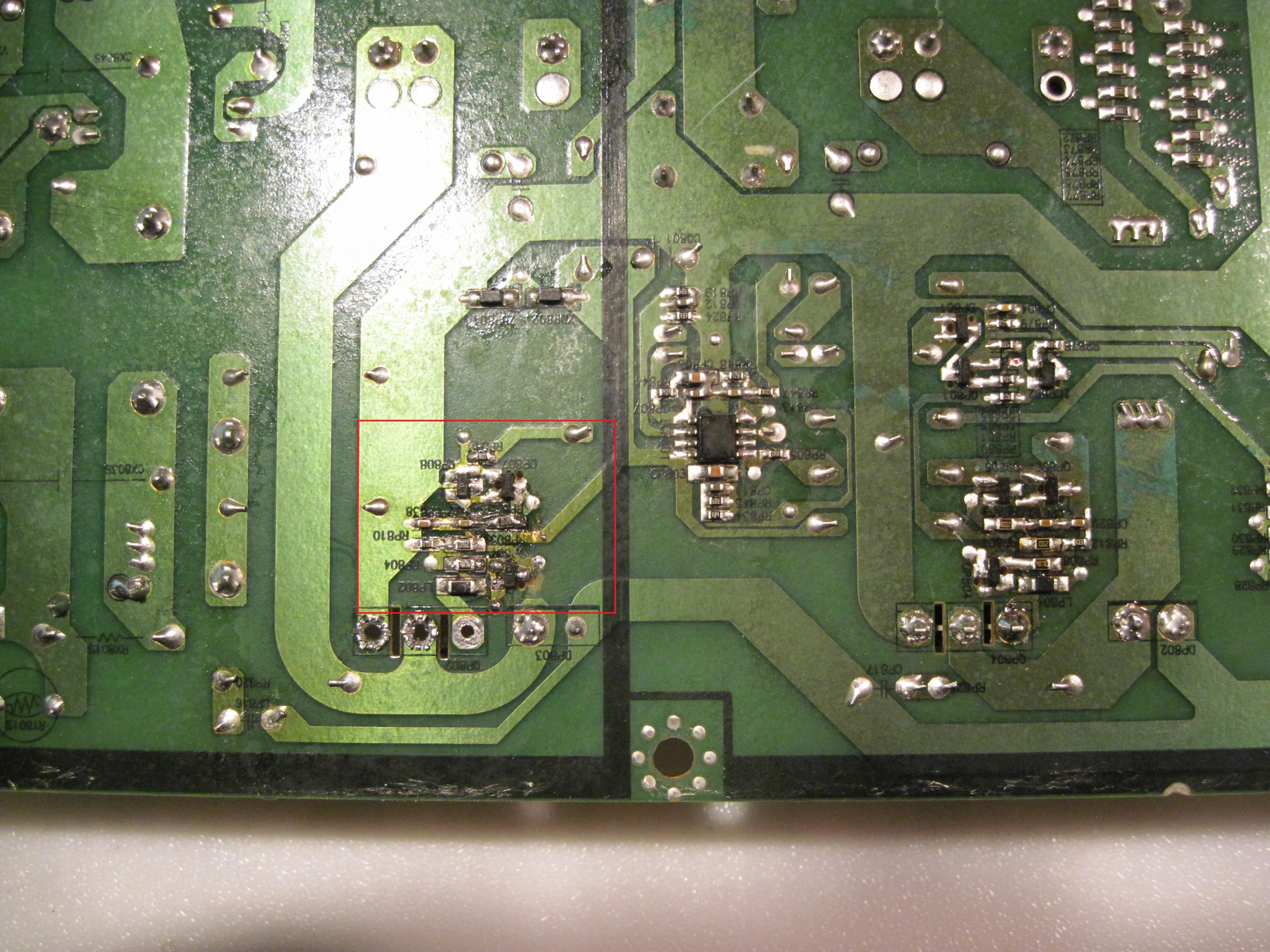

    I have checked the components near the FET, and didnt find anything bad. The only component I am not sure of are the SOT23's that say B6 on them. Not sure what they are.
