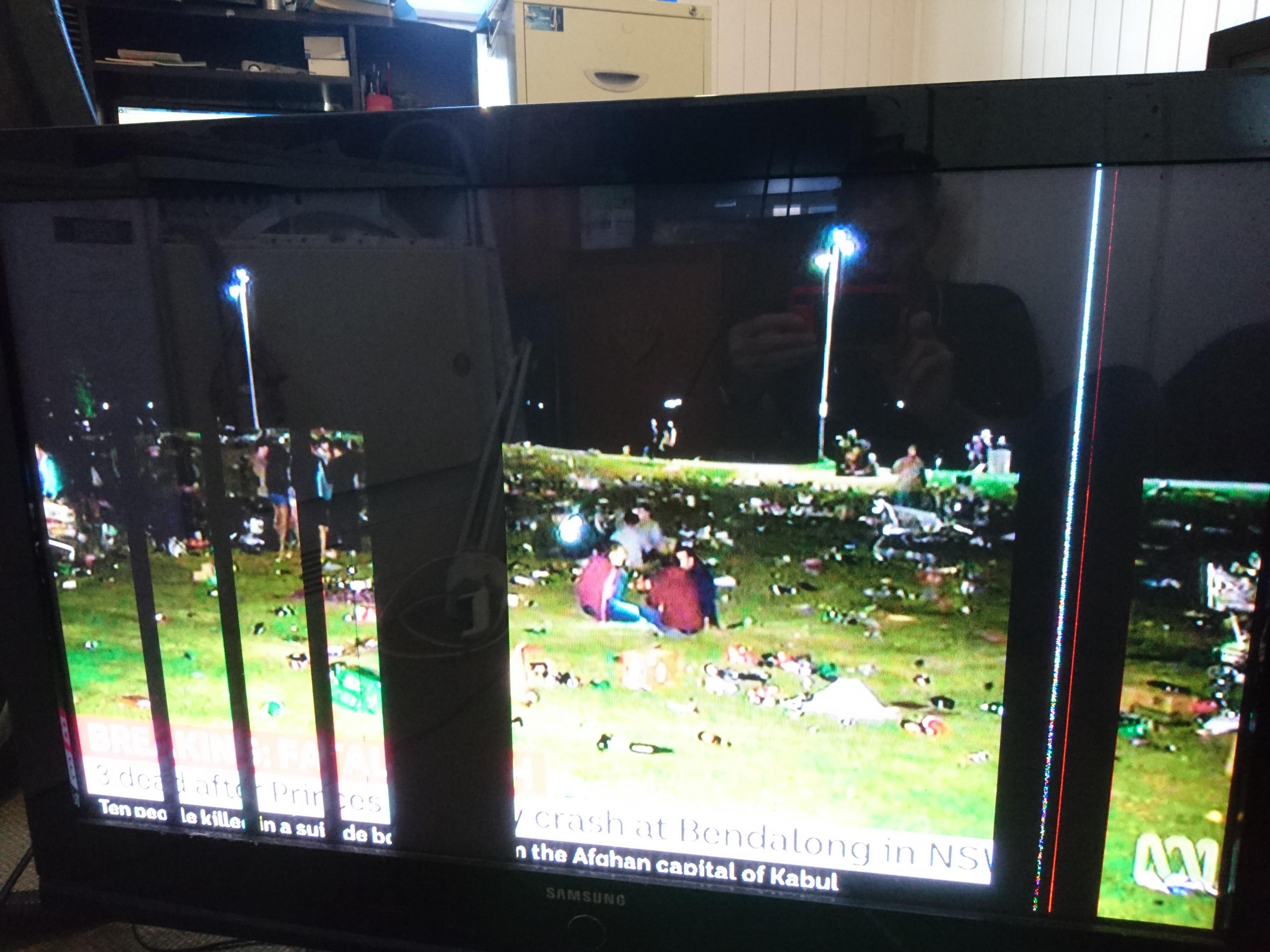

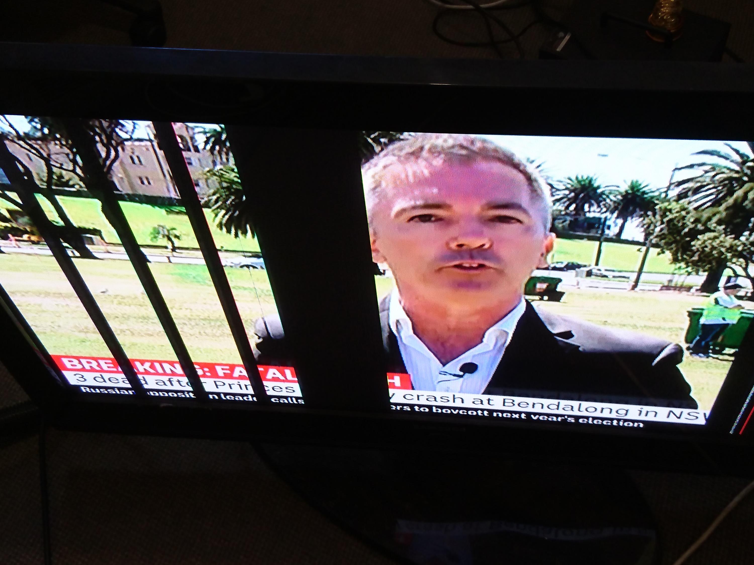

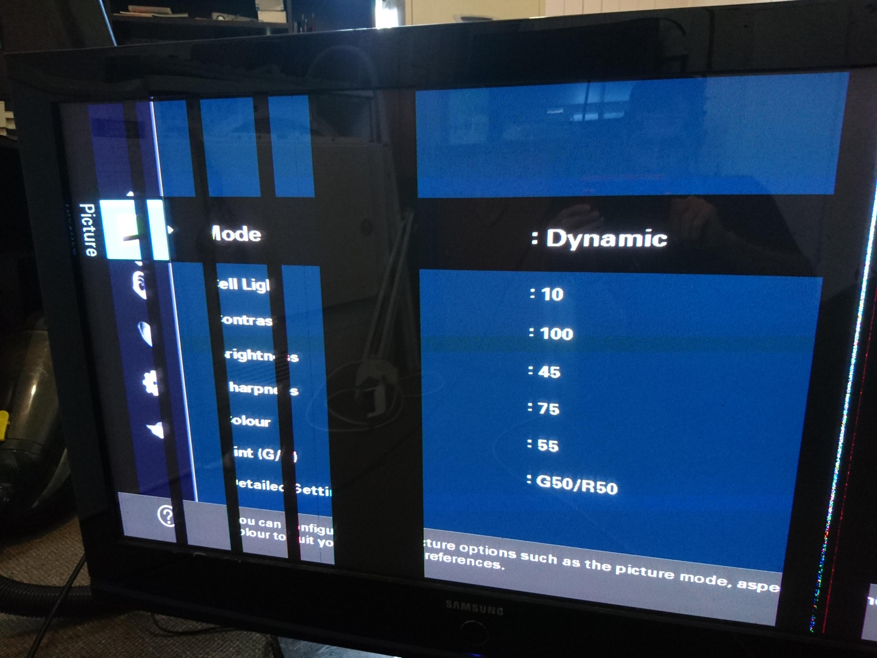

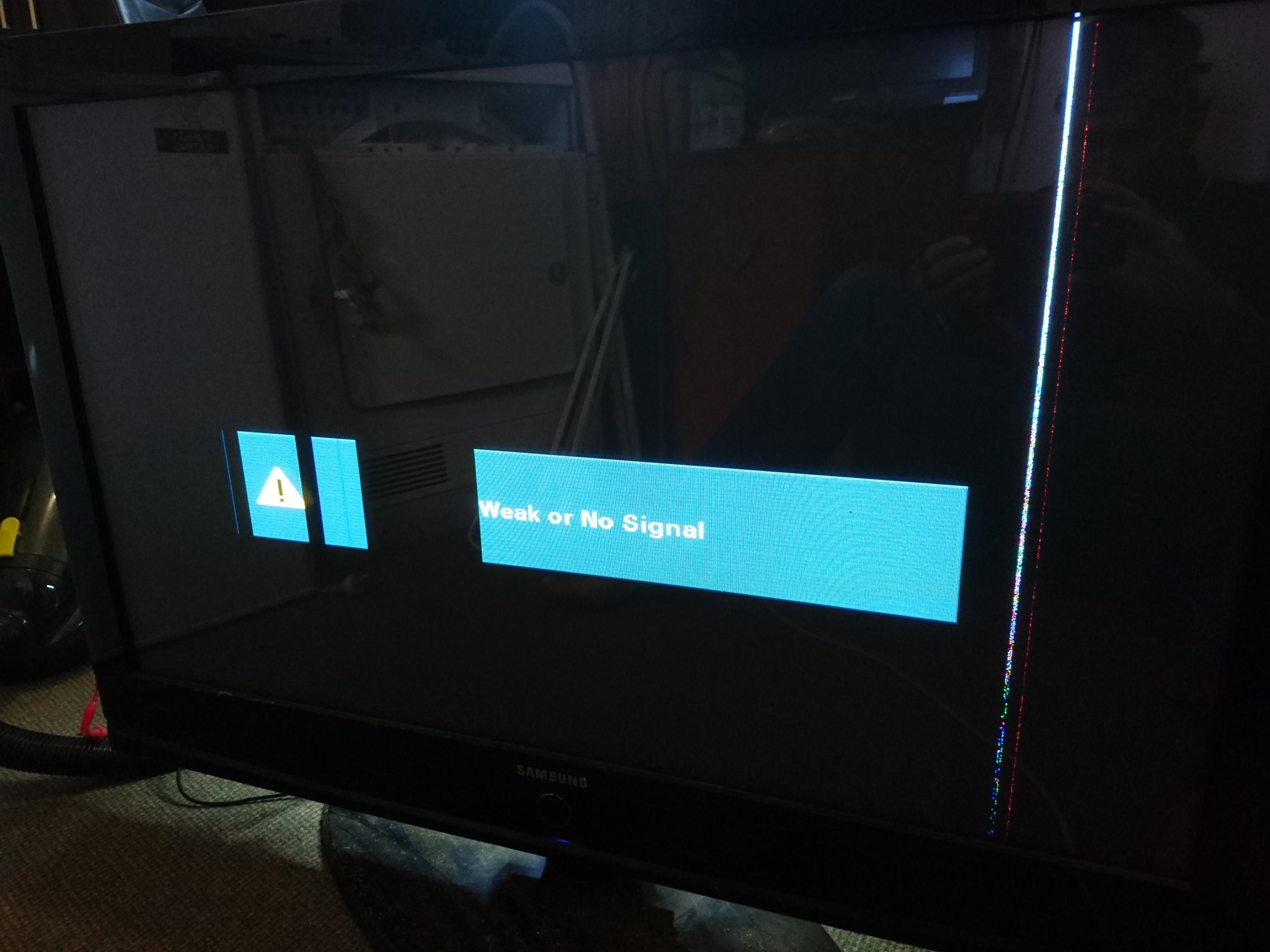

    Before I rob this Samsung Plasma for parts , can anyone confirm this is indeed a bad panel .
    All Voltages are correct and I have removed and refitted all ribbons connectors etc in the X Buffer Boards, with no change at all.

    Cof bonding
    • happyade123
      • Feb 2015
      • 92
      Re: Samsung PS42A410C1D
      Chip On Film Bonding, is that what you mean nagaraju.g? I take it this is not fixable?
