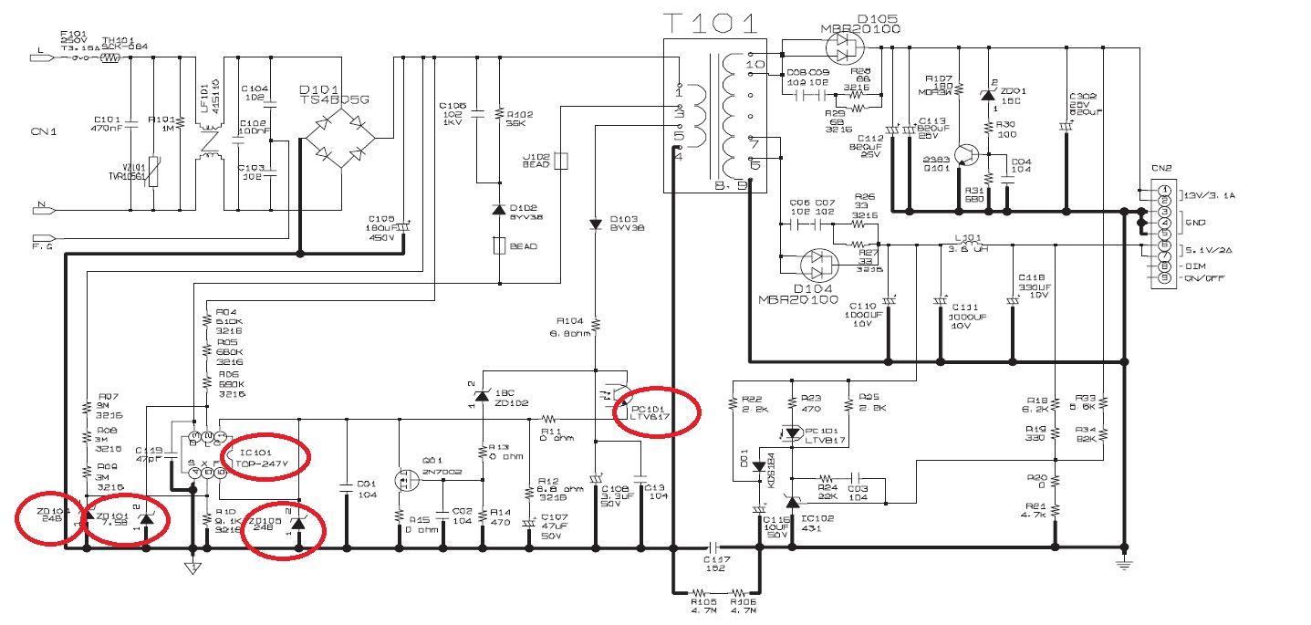

    Hi guys, I've a problem with this TV. I repair switching exploded but it switch off after 10-15 minutes, probably because some components get hot for wrong value.
    I'm looking for correct value of ZD 101, ZD 104, ZD 105. I've got schematic diagram but I can't undestand correct value of these zener.
    Thanks in advance!

      Re: samsung bn44-00115a power-inverter
      ZD101 is 7.5 v
      ZD104/105 are 24v
        Thanks a lot! After I connect correct zener, TV is turns on about 30 minutes, after that it turns off for few minutes and repeat this sequence each half an hour.
        I changed IC101 because it was exploded and PC101 because it was always warm.
        I tried to change D102 and D103 without success.
        Could anybody help me, please?
            Hi guys, in red circle components I found fault. But TV switch off about after 20 minutes
            • tvtimmy
              • Mar 2015
              • 1160
              • usa
              Touch up as many solder joints as you can. Sounds like a heat expansion fault.
