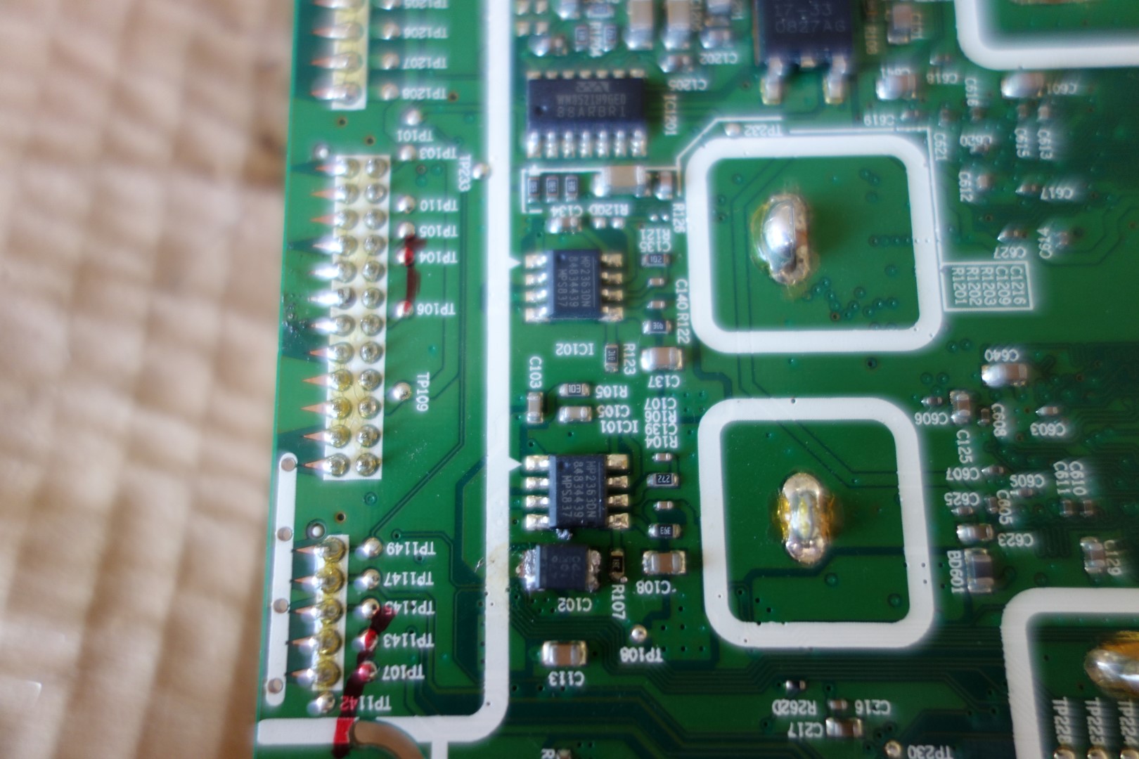

    Found the thread about C102 failures on the main board (BN41-00975C) so removed it and replaced it with an electolytic 47uF and TV started up.

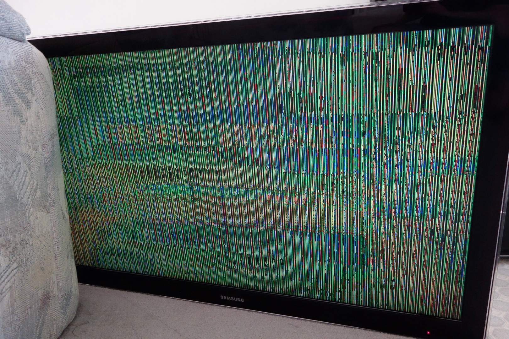

    Realized I had installed it backwards (positive end has marking on tantalums) so reversed it. Ran TV for a couple of hours. When I turned the TV off and back on again, got a green screen with vertical lines like the following posts.
    https://www.badcaps.net/forum/showthread.php?t=43532
    https://www.badcaps.net/forum/showthread.php?t=26125
    Ordered 47uF/10V tantalums (part #399-4981-1-ND) from Digikey, replaced both C102 and C131 and still have the same issues. Startup cycles a few times with green screen and finally suceeds after 2-5 attempts.
    Think next step is to replace IC101. Thoughts?

    I am tempted to put the old C102 cap back and add a 100uF in parallel to see what happens.
