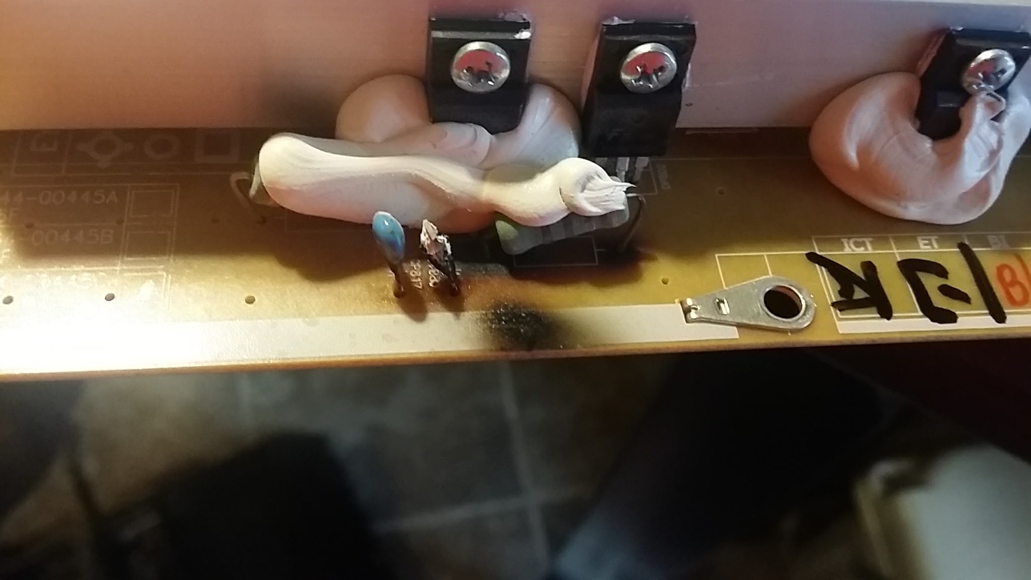

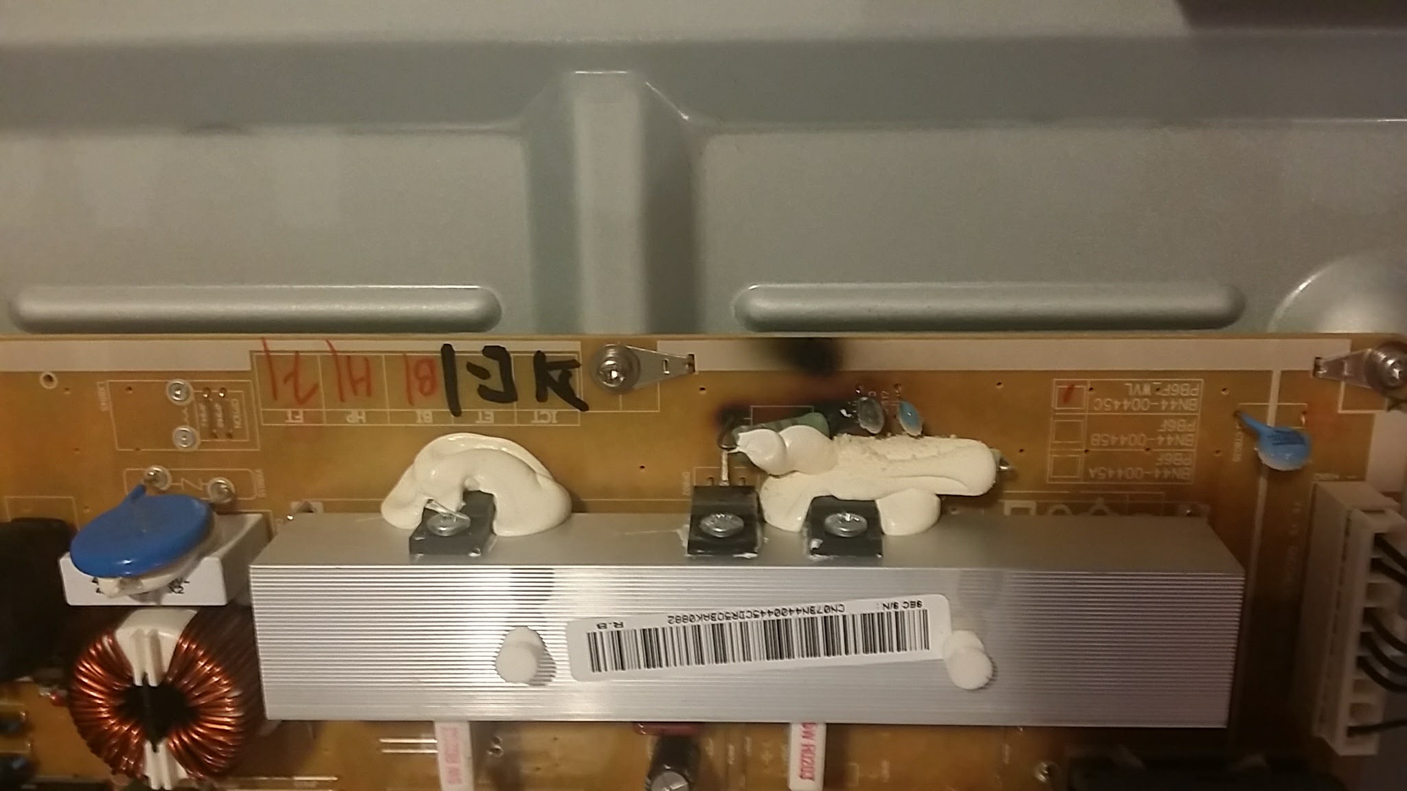

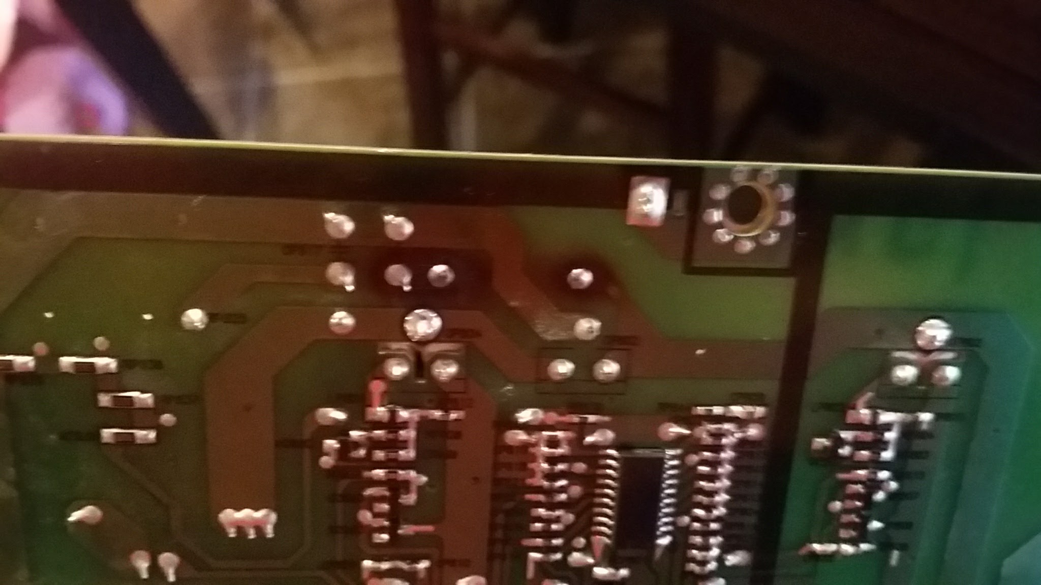

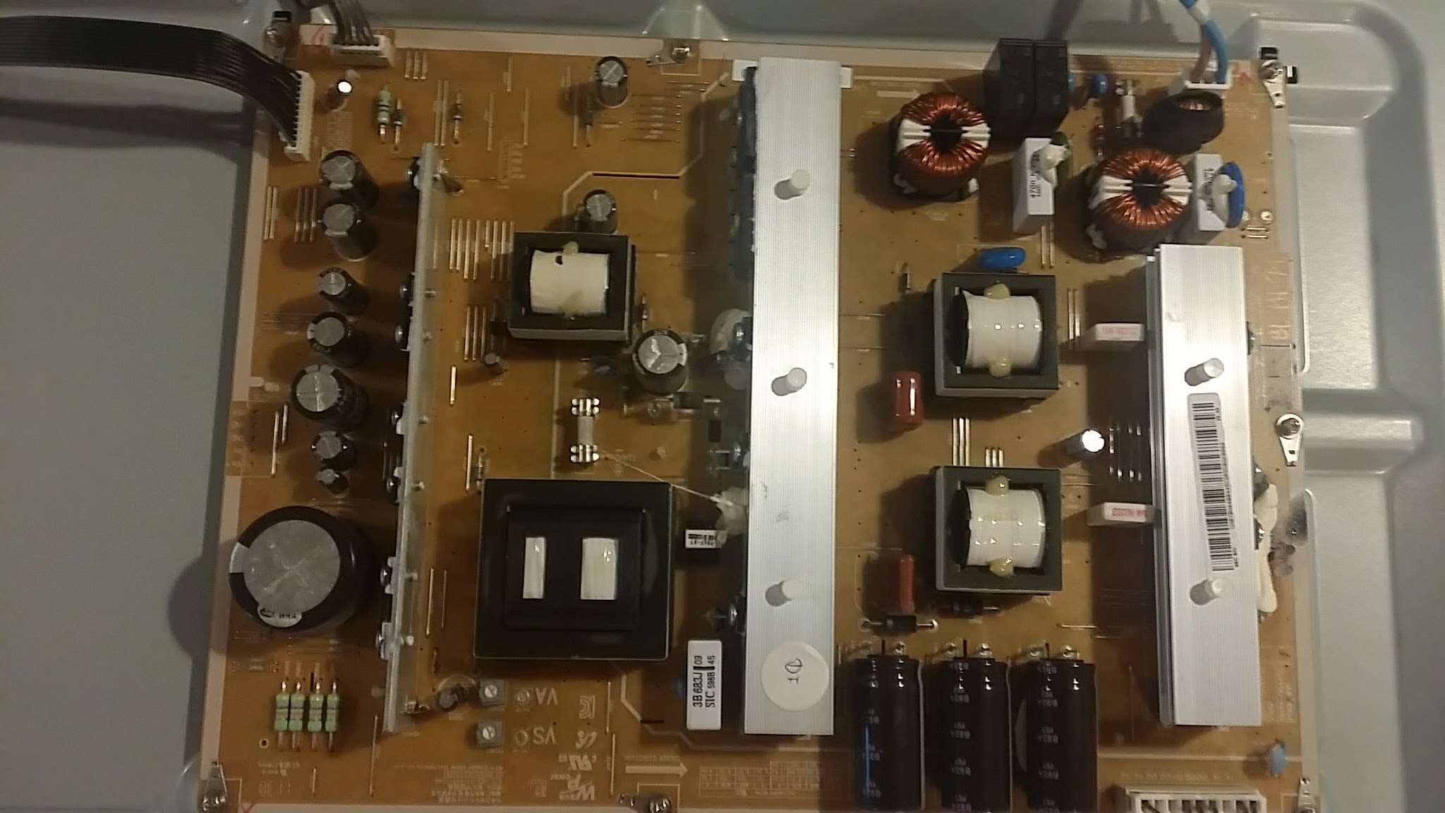

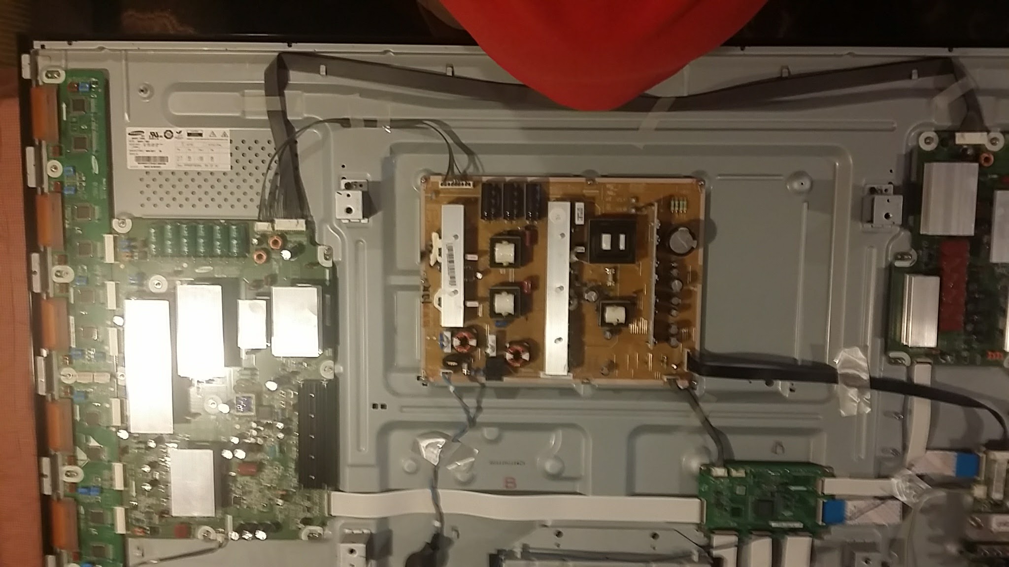

Samsung PN59D530A3F Plasma wont turn on
  • Goldenmonkey
    • Jul 2017
    • 13
    Samsung PN59D530A3F Plasma wont turn on
    my samsung plasma would not turn on last week. the red light just kind of clicks every 10 seconds or so.
    I pulled the back cover off and found some obvious damage on what I believe is the power supply board.
    I'm hoping I can just solder on new parts to replace the burnt up ones? the little round blue part and one next to it look like they need replaced. not sure if the board could have been damaged from this as well?
    I found a power supply board on ebay for about 200. not sure if there are cheaper options out there if I do need to replace the whole board.
    if so, what parts am I looking at to replace and where can I purchase them from?
    thanks in advance, any help is appreciated.
    Last edited by Goldenmonkey; 07-23-2017, 07:51 AM.
  • dick_barton
    • Aug 2015
    • 6643
    • Wales
    Re: Samsung PN59D530A3F Plasma wont turn on
    Not exactly the same model but close enough for you to get an idea of what's wrong.
    https://www.youtube.com/watch?v=dswtNRiZwN8
    Shopjimmy do a repair kit
    http://www.shopjimmy.com/samsung-bn4...repair-kit.htm
    Last edited by dick_barton; 07-23-2017, 08:09 AM.
    • Goldenmonkey
      • Jul 2017
      • 13
      Re: Samsung PN59D530A3F Plasma wont turn on
      do i need to replace all those square black things, or just the round blue one that is burnt up?
      or is the burnt up blue one a result of the black square ones not working properly?
      I did not watch the entire video, so sorry if that question would have been answered in the video.
      • Goldenmonkey
        • Jul 2017
        • 13
        Re: Samsung PN59D530A3F Plasma wont turn on
        found a used power supply board for $115
        https://www.ebay.com/p/Samsung-Pn59d...WVL/1700239826
        not sure if its worth just getting this and swapping it out?
        doesnt look like those numbers match up exactly with what is on my power supply board, so I guess that rules that one out
        Last edited by Goldenmonkey; 07-23-2017, 08:32 AM.
        • dick_barton
          • Aug 2015
          • 6643
          • Wales
          Re: Samsung PN59D530A3F Plasma wont turn on
          If you have the basic skills in using a multimeter and soldering iron then you could have a go at repairing it yourself. Should you be lacking the knowledge and skill then a replacement board may be the best answer.
          There are people who can carry out the repair at half the cost of that replacement board if you search on the internet for "BN44-00445C repair"
          http://www.coppelltvrepair.com/p/135...-shutdowns-etc
          • Goldenmonkey
            • Jul 2017
            • 13
            Re: Samsung PN59D530A3F Plasma wont turn on
            I watched the video, seems pretty straight forward. I am going to try and repair it myself.
            • Goldenmonkey
              • Jul 2017
              • 13
              Re: Samsung PN59D530A3F Plasma wont turn on
              where do i find the part number for my power supply board?
              I get no results when I search for this number that is on the board
              RM445CA1BAH2JY
              Is there somewhere else on the board or tv I should be looking for the part number?
              • Goldenmonkey
                • Jul 2017
                • 13
                Re: Samsung PN59D530A3F Plasma wont turn on
                there is also this number
                which looks like it has the BN44-00445C in the middle of the number.
                • dick_barton
                  • Aug 2015
                  • 6643
                  • Wales
                  Re: Samsung PN59D530A3F Plasma wont turn on
                  The board is a BN44-0445C
                  • Goldenmonkey
                    • Jul 2017
                    • 13
                    Re: Samsung PN59D530A3F Plasma wont turn on
                    thank you
                    would this repair kit work for my tv?
                    http://www.ebay.com/itm/SAMSUNG-Powe...3D222130531776
                    the one you linked is out of stock. doesnt show a picture of all the parts, just want to make sure that round blue thing that is blown on my board is included in this kit.
                    • Hamie
                      • Apr 2014
                      • 1383
                      Re: Samsung PN59D530A3F Plasma wont turn on
                      Why not message the seller and ask if the 2 ceramic caps and resistor are included in the kit?
                      • Goldenmonkey
                        • Jul 2017
                        • 13
                        Re: Samsung PN59D530A3F Plasma wont turn on
                        good idea thanks
                        • terry locke
                          • Sep 2017
                          • 3
                          • canada
                          Re: Samsung PN59D530A3F Plasma wont turn on
                          hey there goldenmonkey i have the same tv couldnt find a good powersupplly tried a couple from ebay they never worked sent them back finaly swaped it out with a used board from china its out of a 63 in it looks different but works fine just had to adjust the va up to panel sticker value ive been working on this for months finaly fixed however i do have some extra boards (xmain y main lower buffer and logic board)
                            09-07-2024, 05:50 AM
                            09-06-2024, 11:40 PM
                            09-06-2024, 11:40 PM
                            09-06-2024, 08:40 PM
                            Samsung Galaxy Book Ion NP950XCJ-K01DE Notebook Specification for Upgrade or Repair
                            This specification for the Samsung Galaxy Book Ion NP950XCJ-K01DE Notebook can be useful for upgrading or repairing a laptop that is not working. As a community we are working through our specifications to add valuable data like the NP950XCJ-K01DE boardview and NP950XCJ-K01DE schematic. Our users have donated over 1 million documents which are being added to the site. This page will be updated soon with additional information. Alternatively you can request additional help from our users directly on the relevant badcaps forum. Please note that we offer no warranties that any specification, datasheet,...
                            09-06-2024, 06:20 PM
