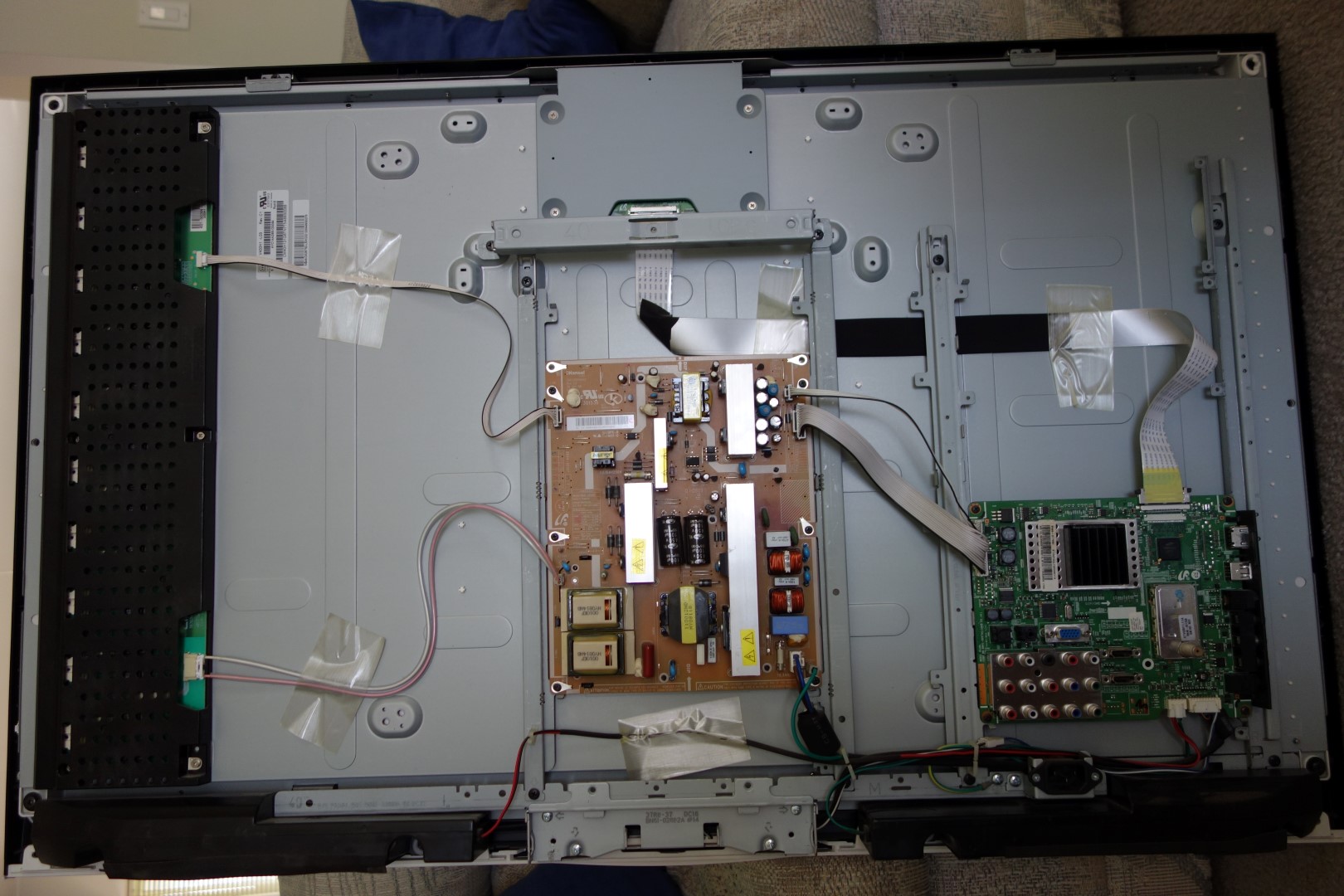

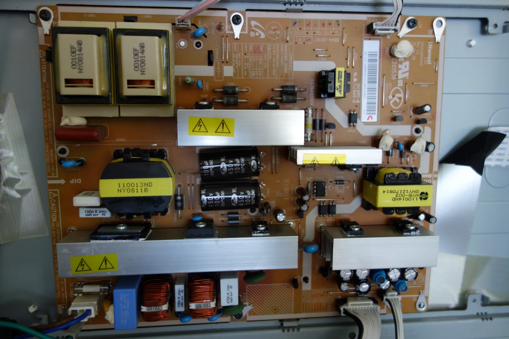

    The previous owner indicated the TV had color problems. When I plugged it in and ran it for a couple of hours, it seemed fine. The next day when I checked it, the screen had a reddish tinge and highlights. Taking off the back, I noticed a bulged cap on the PS board, CM810 which I replaced. Checking the picture again, it seemed ok but there is a slight flickering and there were also blue highlights once. Both disappeared when the TV warmed up.
    Voltage on the filter caps is 382V which is a bit low. PS Board is BN44-0197A (schematic available online). May try to boost that voltage a bit.
