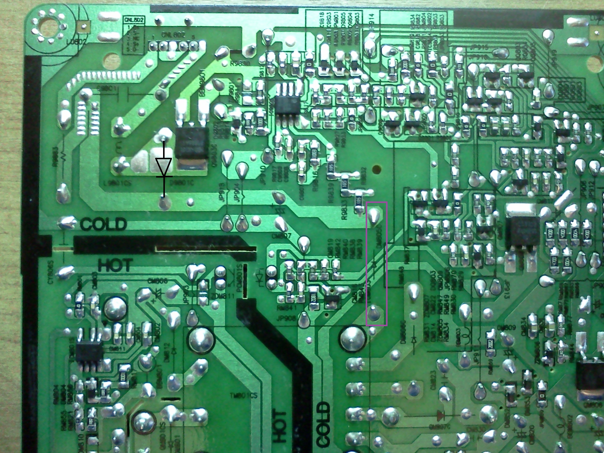

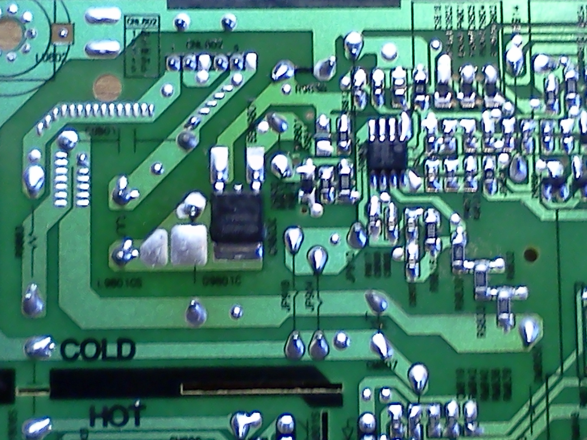

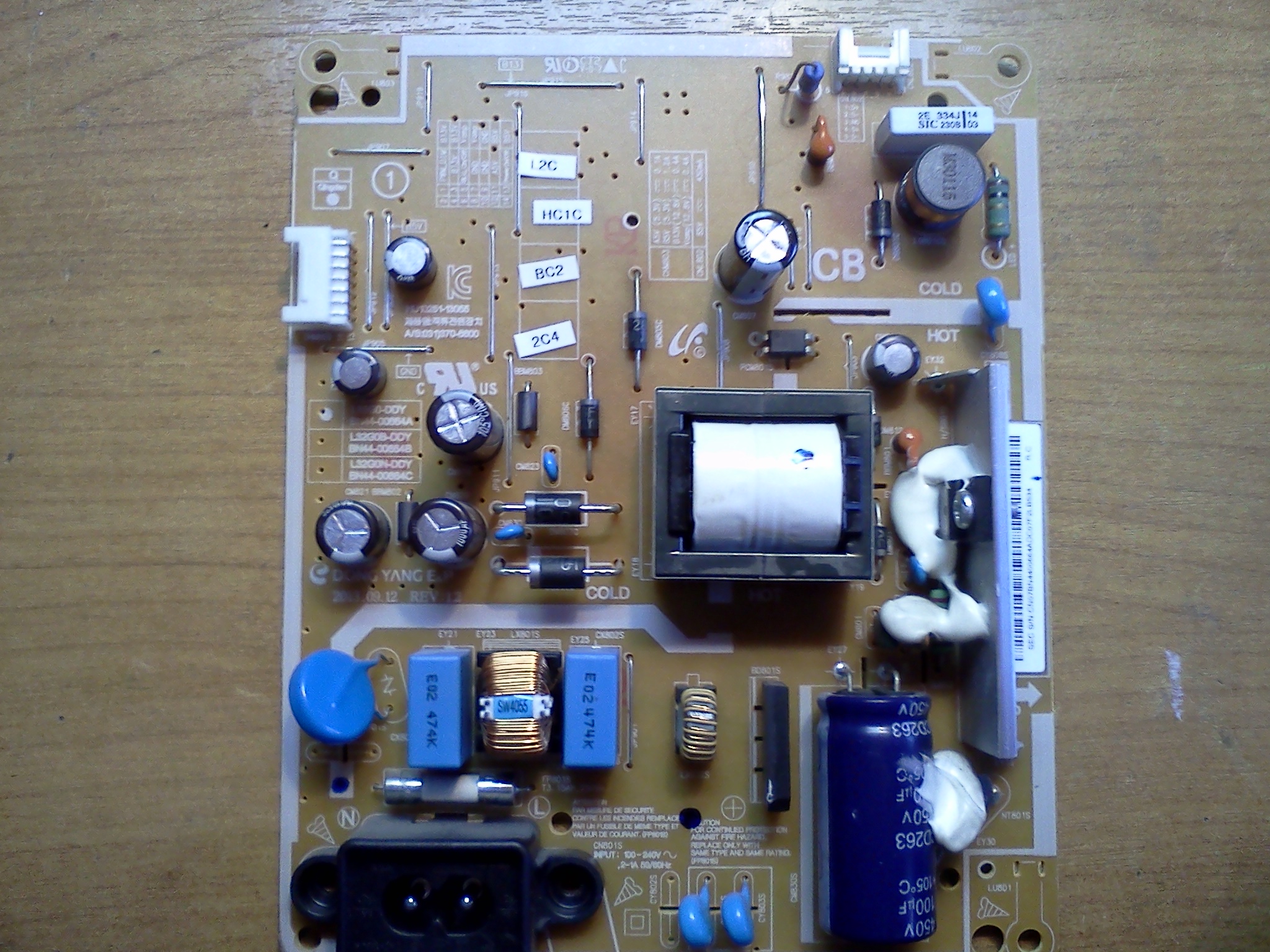

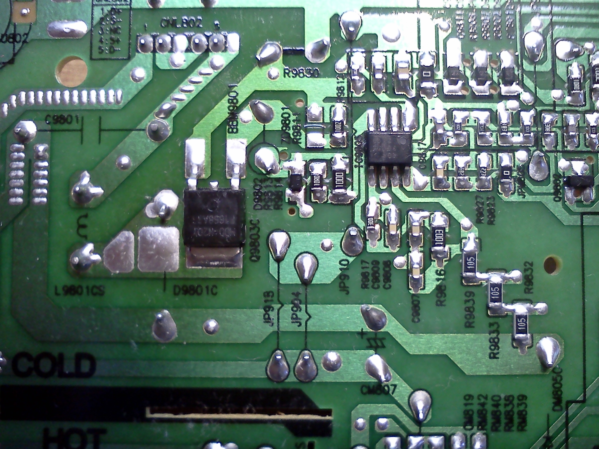

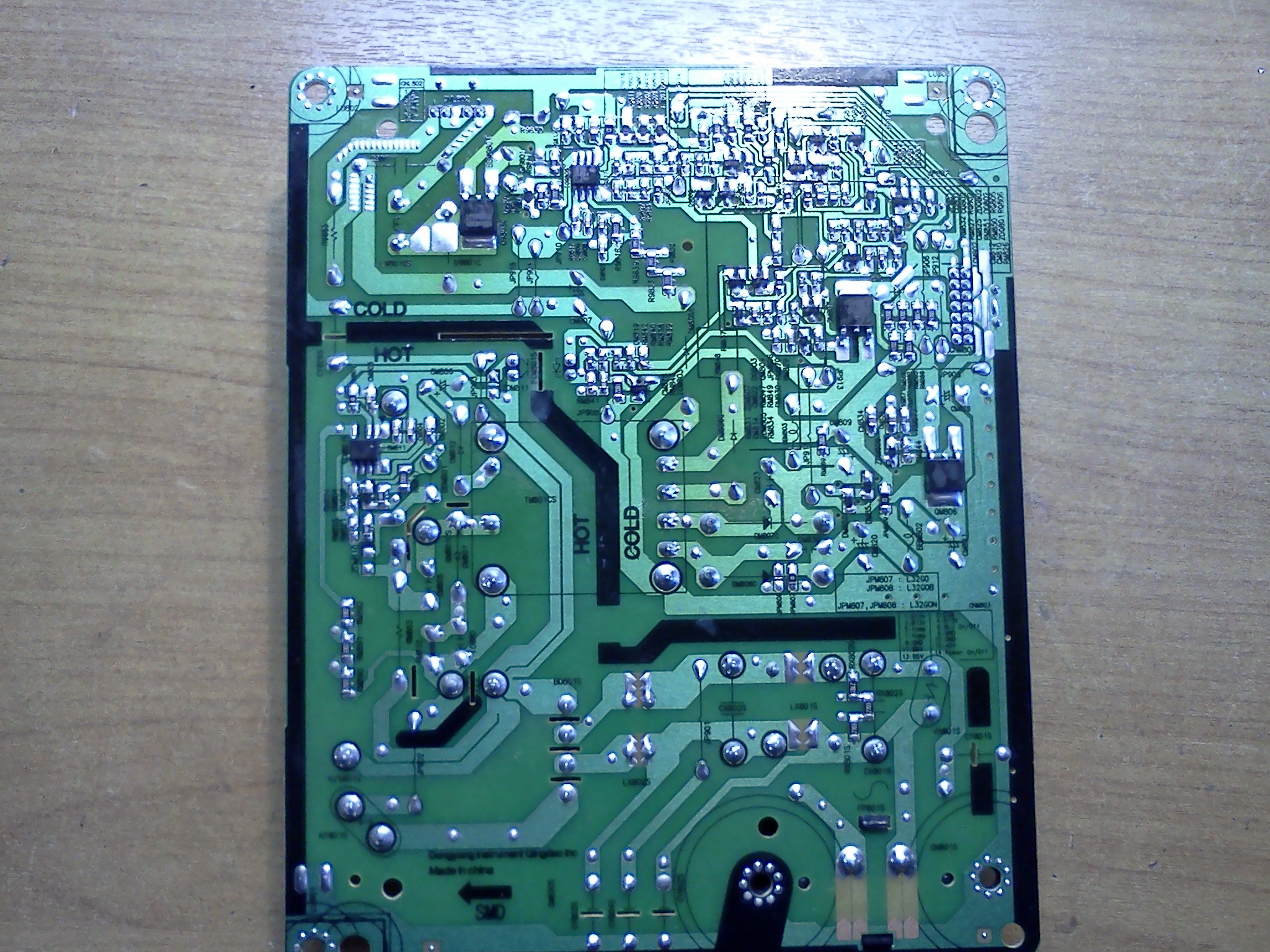

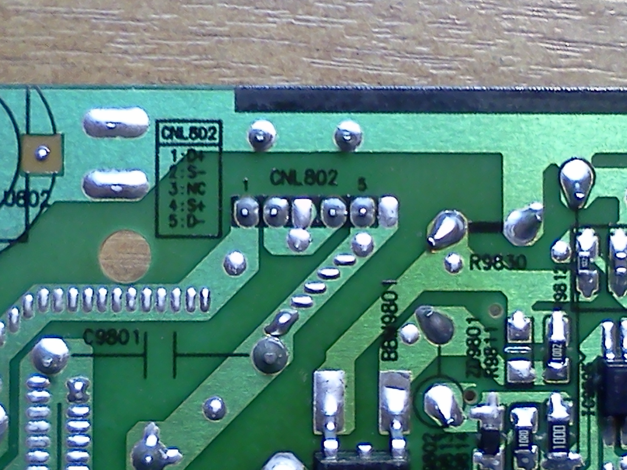

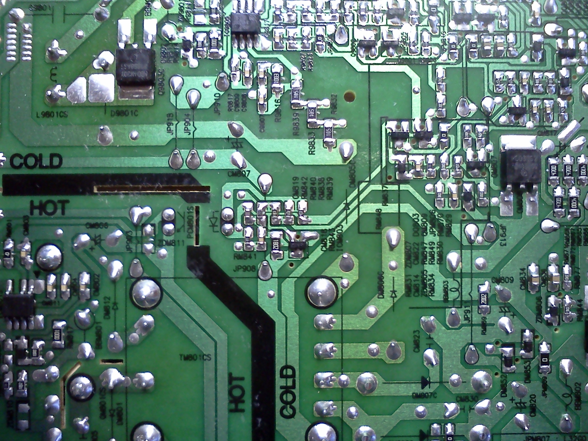

Samsung U32EH4003 problem.
  • HellasTechn1
    replied
    Re: Samsung U32EH4003 problem.
    On the chasis there is a sticker saying Samsung CY-DF320AGEV1H.
    made in hungary
    Last edited by HellasTechn1; 04-02-2017, 11:02 AM.
    Leave a comment:
  • dick_barton
    replied
    Re: Samsung U32EH4003 problem.
    What's your LCD panel make and model number as attached to the metal chassis.
    https://www.youtube.com/watch?v=EgRKJAqYqeo
    Last edited by dick_barton; 04-02-2017, 10:59 AM.
    Leave a comment:
  • HellasTechn1
    replied
    Re: Samsung U32EH4003 problem.
    Measure each Led connector pin using chassis as ground and post results please.
    Can you also post a focused picture of your power supply so that the legends can be read.
    I get 139.1 V from D+ (transformer's side) to chassis and 2.2mV "nothing" from D- to chassis (controller's side).
    In the purple bos is the diode that connects the transformer with D+
    Last edited by HellasTechn1; 04-02-2017, 10:56 AM.
    Leave a comment:
  • HellasTechn1
    replied
    Re: Samsung U32EH4003 problem.
    Measure each Led connector pin using chassis as ground and post results please.
    Can you also post a focused picture of your power supply so that the legends can be read.
    Will do !
    Originally posted by Andrew F. Ali
    Did you replace the one burnt LED on the strip or did you replace the entire strip? If you had just replace the one burnt LED and not the entire strip, I would think that your replacement LED was not the correct type or the solder connections you made were not properly done. Anyway, for the source LED supply to be burning one set only does not seem logical to me.
    I replaced only the burned LED. It is of same specs with the rest. As for soldering i can confirm that it's been done correctly since if i power each strip individually with 27V from my bench PSU, all LED's glow.
    It was probably just some random reason that burned the same LED.
    I beleace that the reason im getting such high voltage is that there is something wrong with the D- side.
    Last edited by HellasTechn1; 04-02-2017, 10:32 AM.
    Leave a comment:
  • Andrew F. Ali
    replied
    Re: Samsung U32EH4003 problem.
    Did you replace the one burnt LED on the strip or did you replace the entire strip? If you had just replace the one burnt LED and not the entire strip, I would think that your replacement LED was not the correct type or the solder connections you made were not properly done. Anyway, for the source LED supply to be burning one set only does not seem logical to me.
    Leave a comment:
  • dick_barton
    replied
    Re: Samsung U32EH4003 problem.
    Measure each Led connector pin using chassis as ground and post results please.
    Can you also post a focused picture of your power supply so that the legends can be read.
    Last edited by dick_barton; 04-02-2017, 09:00 AM.
    Leave a comment:
  • HellasTechn1
    started a topic Samsung U32EH4003 problem.
    Samsung U32EH4003 problem.
    Good day people !
    I came back to you with a new problem i came across.
    I have a Samsung U32EH4003 LED TV that keeps blowing the bottom LED strip.
    At first i locaded the burned LED and replaced it, thinking that thiss would be all. After powering it up it blew that LED again.
    I disconnected the backlight pwer connector from the PSU and the mainboard power connector and then i pluged in the PSU and measured voltage across pins 1 and 5 of the CNL802 (backlight connector) and it gives me 140V DC.
    There are 2 led strips consisting of 9 LED's which in series should require around 54V DC to work. Now no wonder it keeps blowing LED's but why is it giving me such high voltage ?
    I have attached pictures for you.
    From what i see the D+ comes from the transformet through DM805C diode
    and D- from IC9205 or IC9805 (isnt clear) through Q9803C MDD4N20Y mosfet
    Last edited by HellasTechn1; 04-02-2017, 08:51 AM.
    09-07-2024, 05:50 AM
  • howardc64
    Samsung UN55JU650DF network/streaming problem
    by howardc64
    Fixed a 9 year old UN55JU650 by replacing backlight. Original backlight LED was still working after 27k! hours but terrible picture of course. Few LEDs were out, 5-6 lens fell off (bright white spots) and another few popped off with slightest force. Surviving LEDs were all slightly blue so picture has a blue tint.
    This TV runs older Tizen OS (updated to latest version, see pic) and have problems with network (wifi or ethernet) connection. The Tizen UI frequently switch to coax input source while changing content sources. . If no good signal (coax not connected, no prior antenna/cable...
    07-09-2025, 12:44 PM
  • alro7779
    Samsung UN55MU6103F video problem; has colored stripes on the display
    by alro7779
    Hello, everyone!
    A co-worker gave me a 55-inch Samsung TV model UN55MU6103F so I can try to fix the following problem... As soon as I plug it in to the wall, the TV turns on, and the display shows a few stripes all over the screen. I took off the back cover and disconnected both ribbon cables that go to the display (one at a time) so by doing that I can narrow down the bad section of the problem, but in both cases the display turns black. I know there are some voltages that I have to check (VGH, VGL, etc.) but don't know what reading each has to show. If anyone could guide me on this,...
    09-27-2025, 11:29 PM
    09-06-2024, 11:40 PM
    09-06-2024, 11:40 PM
