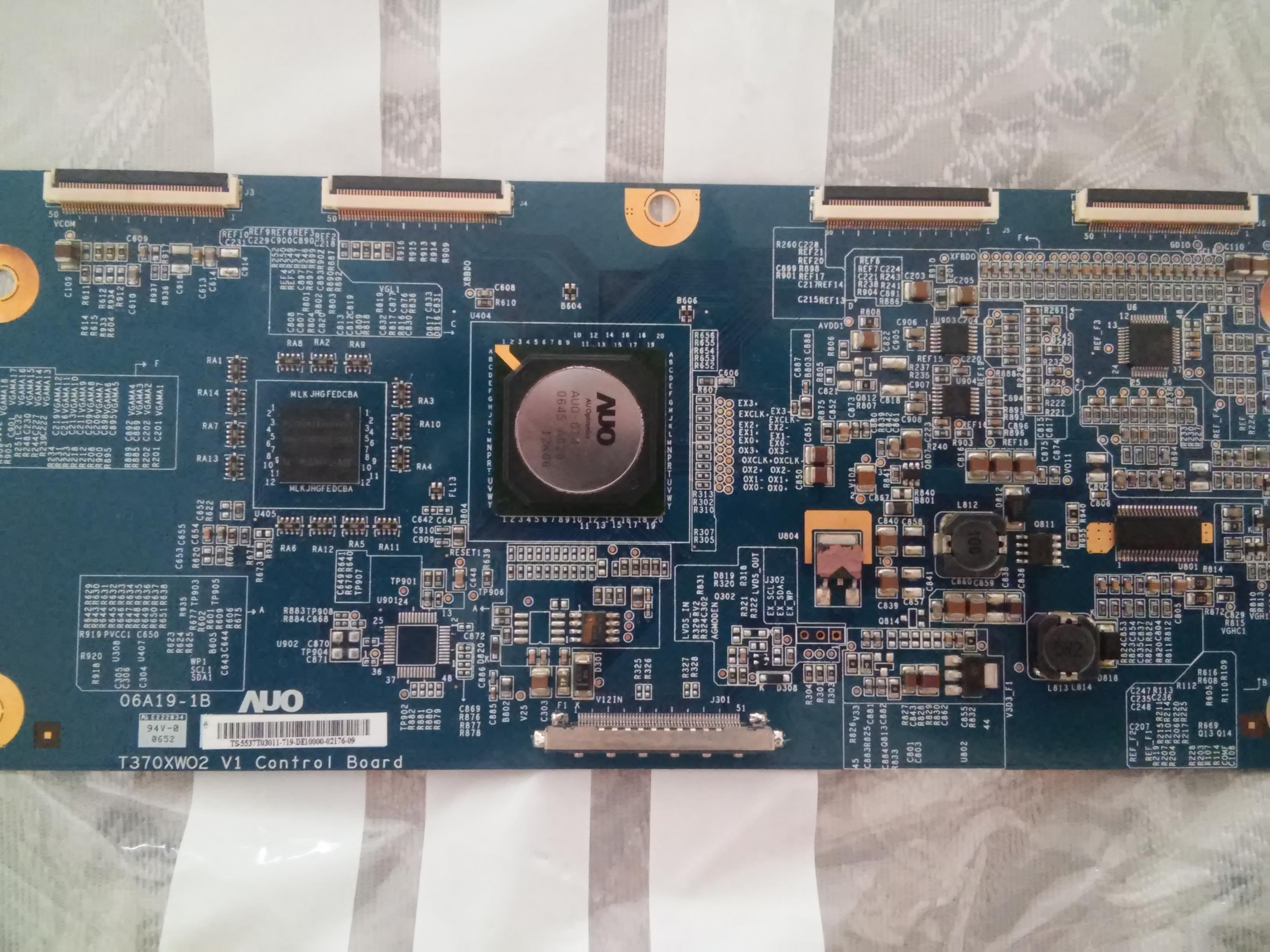

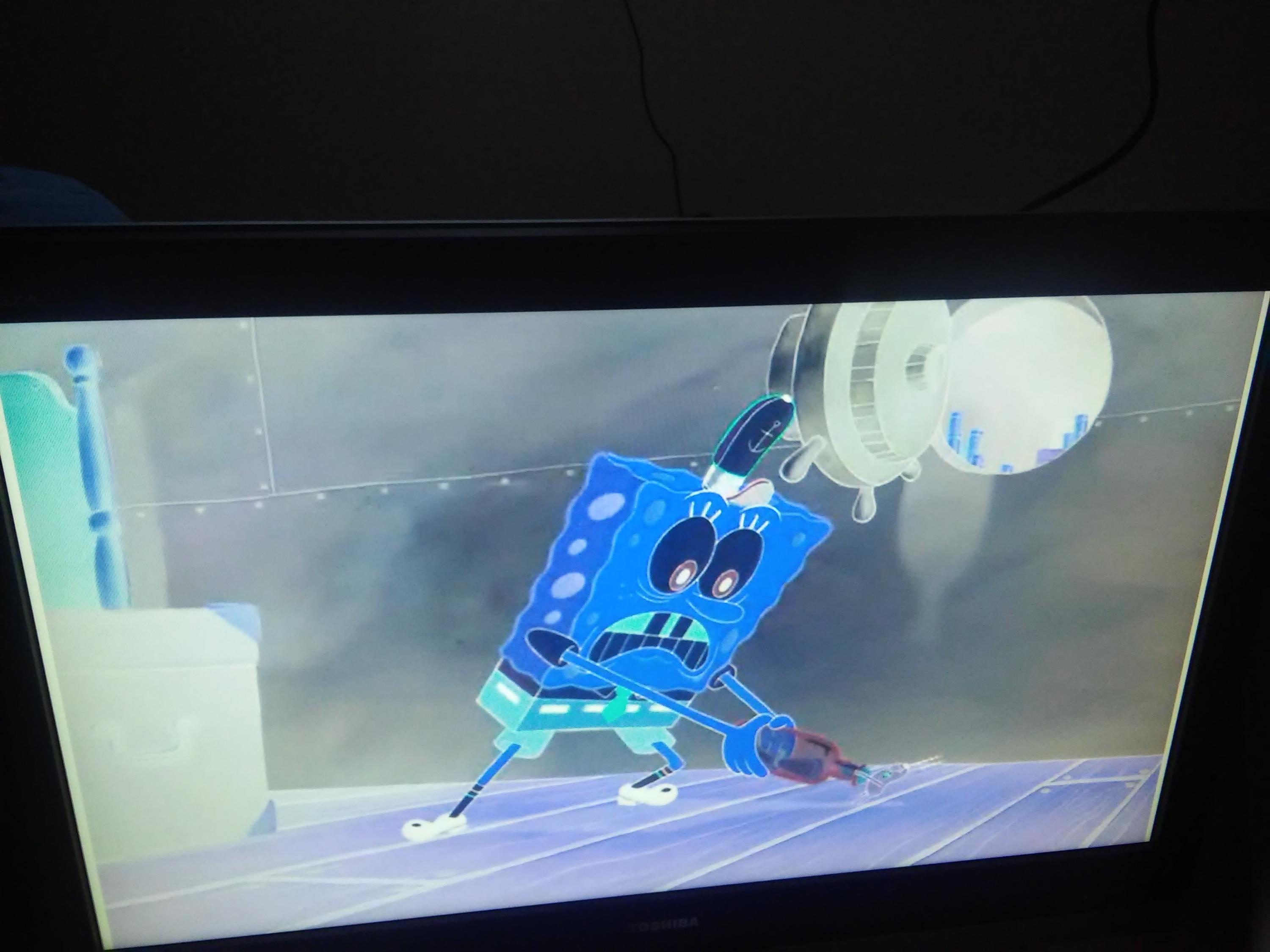

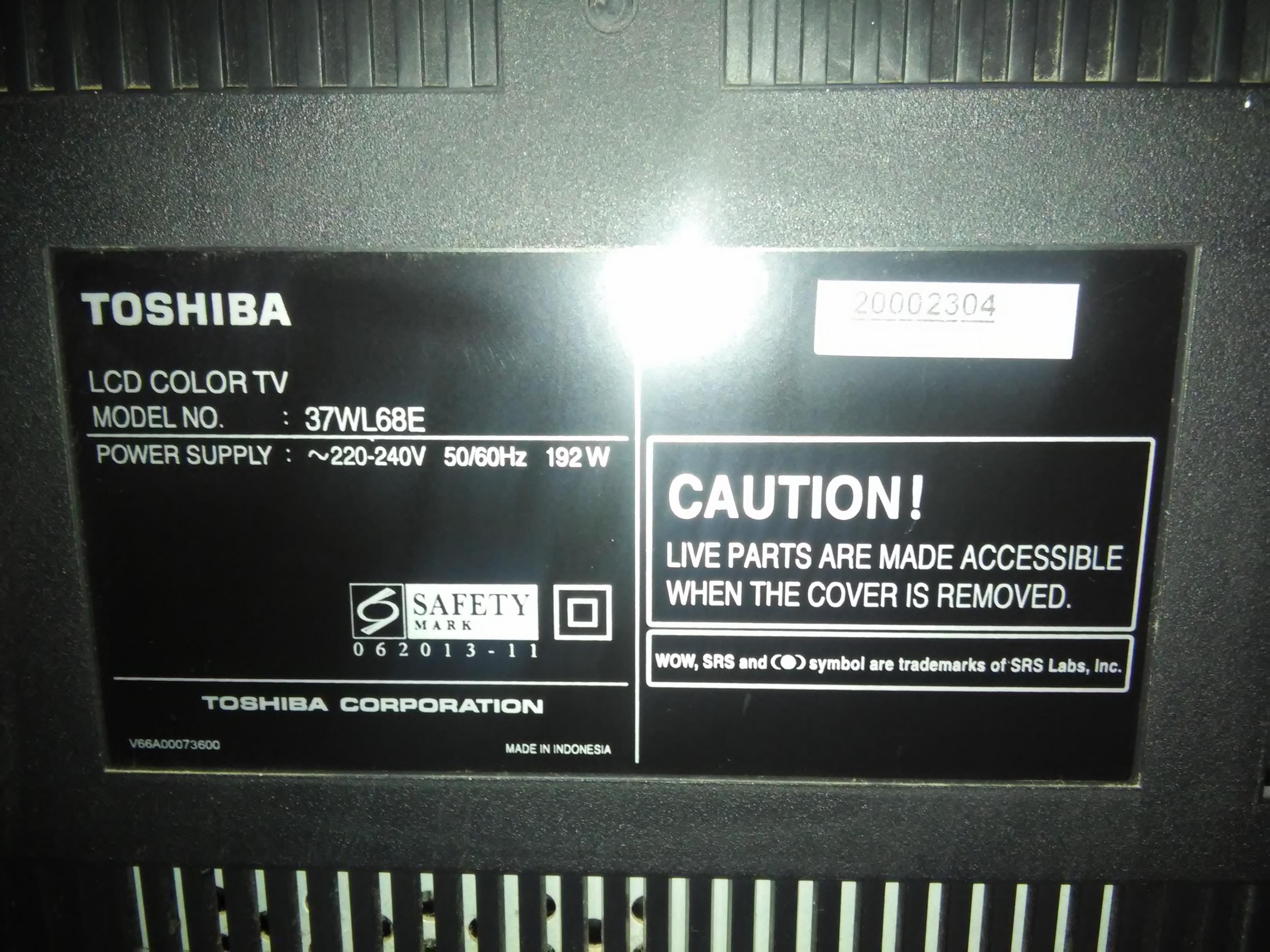

    This is my first thread,your help will be very much appreciated ,
    recently my friend gave me TV to fix,
    Toshiba model 37wl68e, when i turn on the TV i couldn't see anything on screen the menu was very dark,but sound was ok when i plug in an hdmi streamer the colors were very dark.
    The led in front of the screen was solid green which means power supply was ok.
    i Have replaced the t-con board model t370xw02 v1 with used part that i bought from ebay,when i turn on the tv i could see picture but with negative colors,
    I have entered the service menu and run self diagnostic test and all test result were OK.
    I initialize all the params by selecting the model id of the tv 37wl68a,but the colors was invert.
    Is the t-con that i bought is malfunction?
    I bought 2 T-con boards from the same seller replaced them both the same color problems occur.
    the ribbon between the main board and the t-con board looks fine.
    no visual damage of electric components on main board and t-con board.
    I have attached images of bad color on display.
    Please advise
