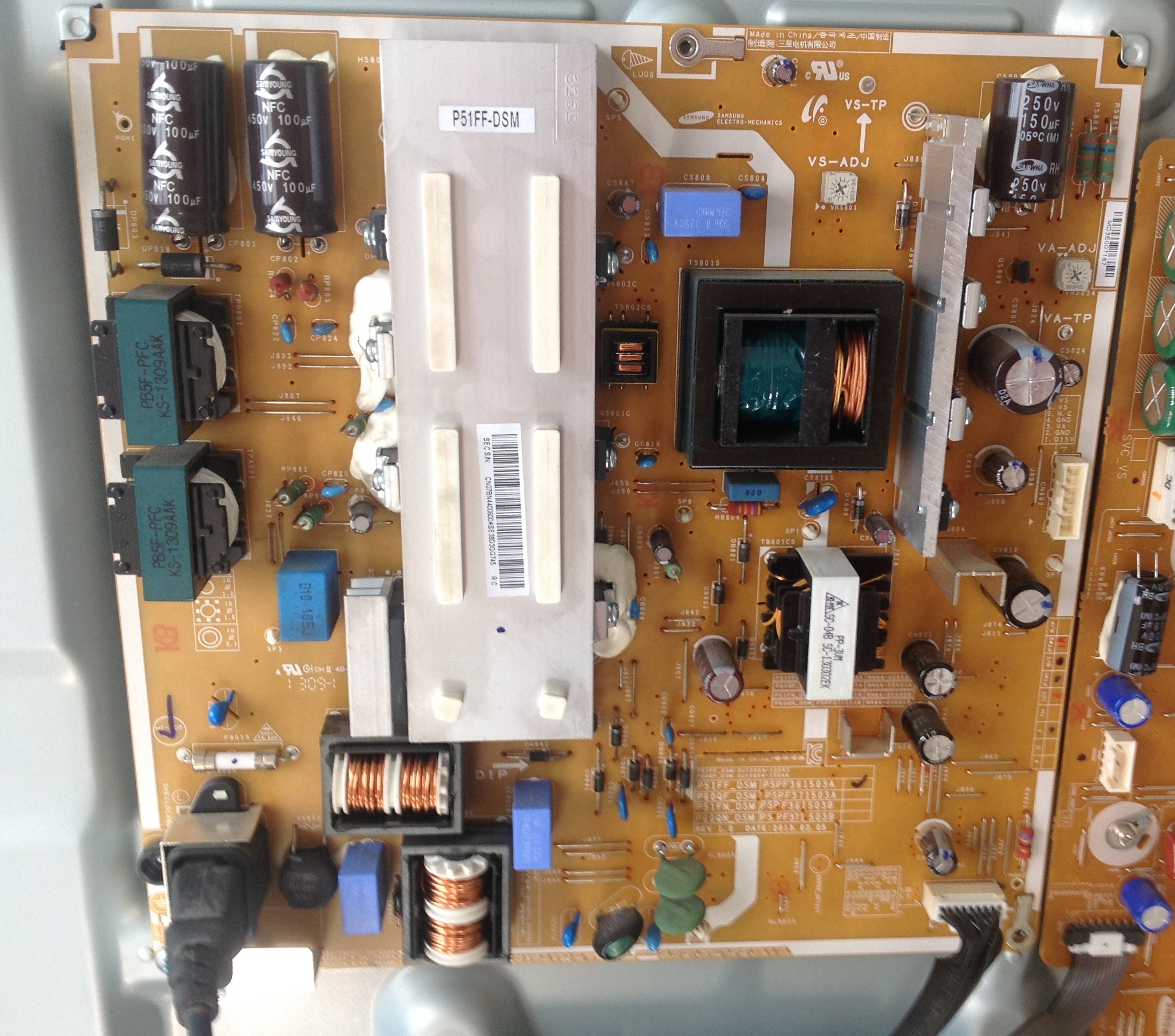

    Hi!
    The TV was working fine until I messed up with it. While turned on, I pulled out the power cord from the back of the unit. After moving it to another room, I plugged the cord back in. The TV is no longer turning on. And the red standby LED at the lower left corner of the unit does not light up anymore.

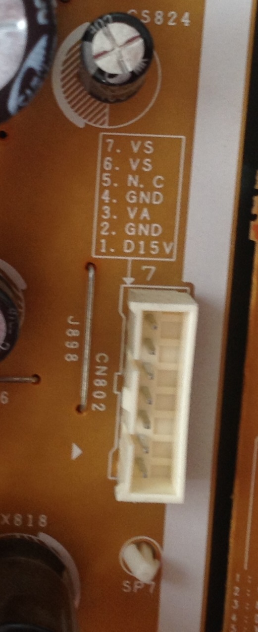

    The power supply module is marked P51FF-DSM. I get 0V reading between GND and D15V in connector CN802 (I get 0V between GND and any other pin in that connector)
    I need help in finding the offending component. I already checked the fuse, its still intact.
    Thanks in advance!

    Got it fixed.
    Something indeed got damaged when I pulled the plug. Something closer to ground zero.
    The conductor inside the cheap power cord itself broke. Replaced it with good one and everything is working again.
