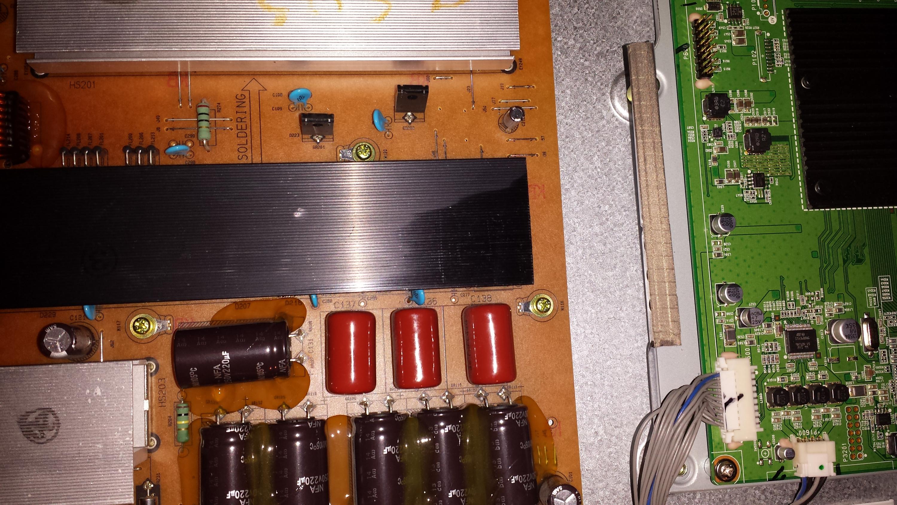

                My VZB is 110 and my VSC is 150. As per the information label all the voltages are dead that I have tested. All the boards show no signs of discoloration like pics of the same model from other posts. There is an unusual oily appearance to the lower part of the black heat sink on the zsus board, not sure if that is evidence of a problem. I have looked at the solder joints on both the z and y sus boards and noticed the circular cracking on several joints. Is it possible they could be the cause. I had mentioned I am not sure about sound output. Any suggestions how I can test for sound since I can't tell what input I am on or if the sound is still disabled through the audio menu [as I mentioned I had surround sound connected to the direct tv DVR] Any help is appreciated.

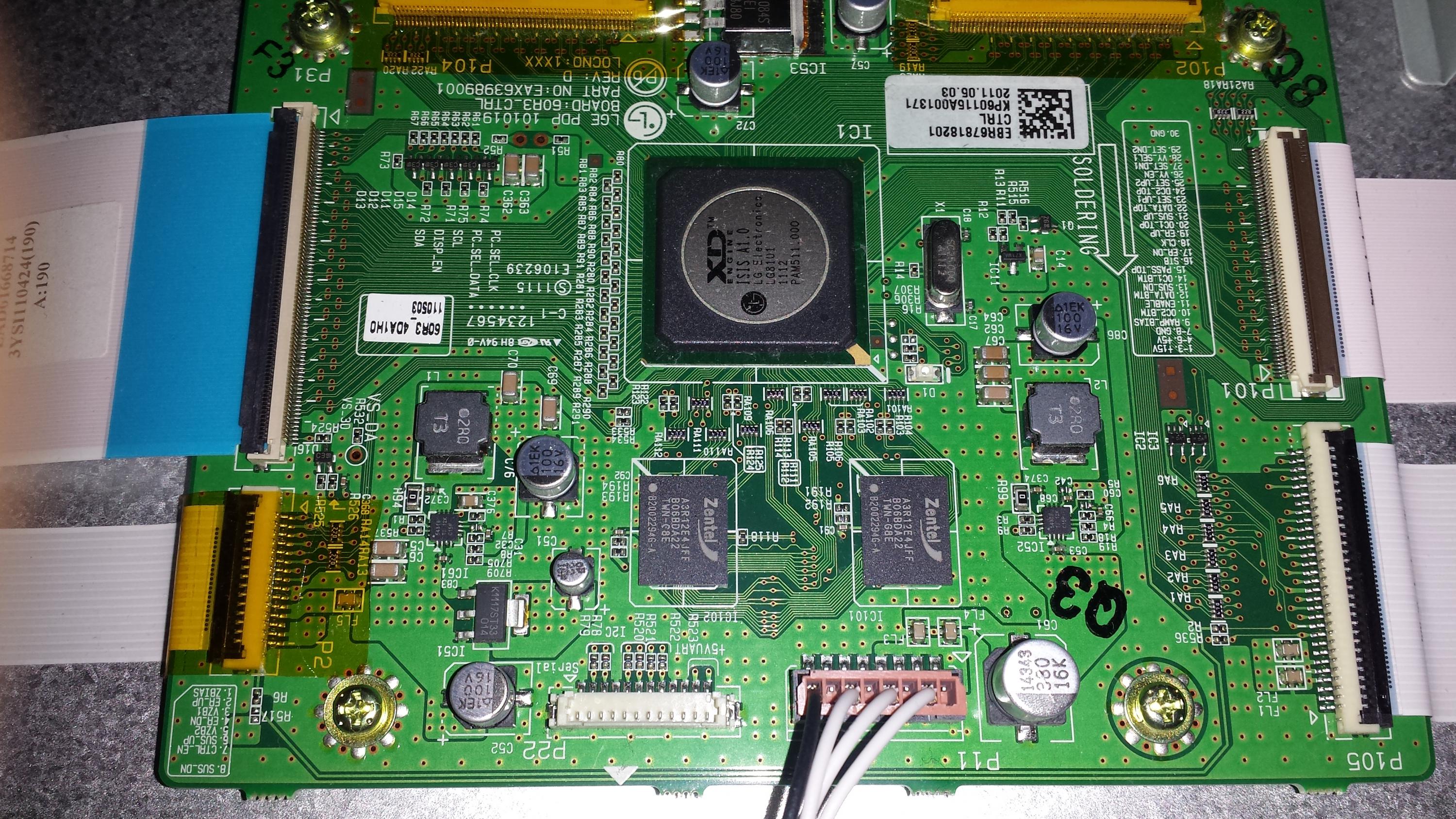

                    Picture of y-sustain and control board needed.
                      Re: LG 60pz950u no display
                      Thanks for your help, if you need pics let me know. Do you think the oily stain on the heat sink is a clue ?

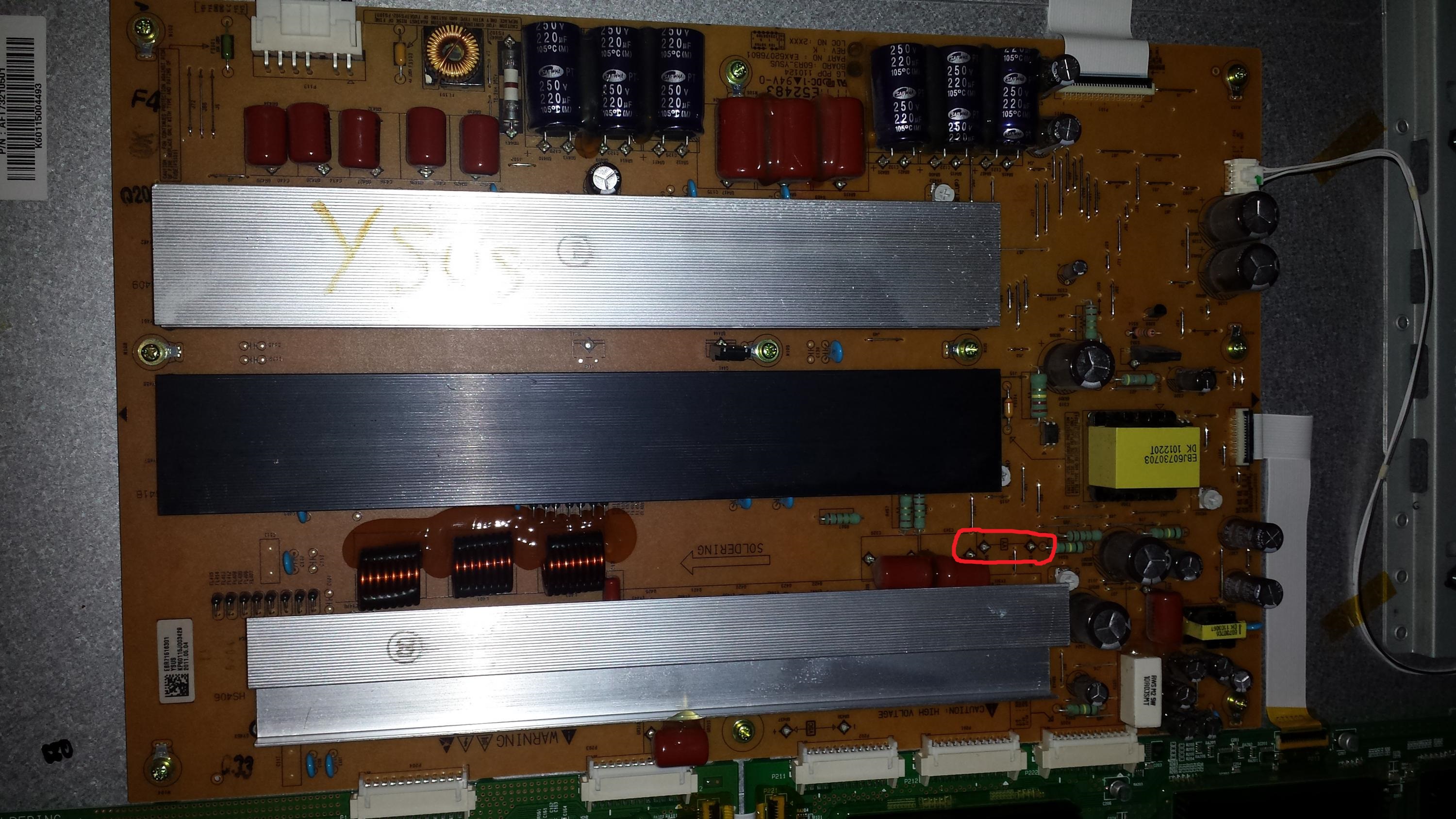

                        connect the 2 holes circled in the attached with a bit of wire (paperclip etc)
                        disconnect the lvds cable also marked in picture.
                        power on the tv

                          VY test point located here
                            vy voltage is -180, I will perform the other test and report back.

                                re-seat the cable on the Y-sus buffers that corresponds with the black line.
                                  if you cant get rid of the black line by cleaning the connections i'm afraid its there to stay.

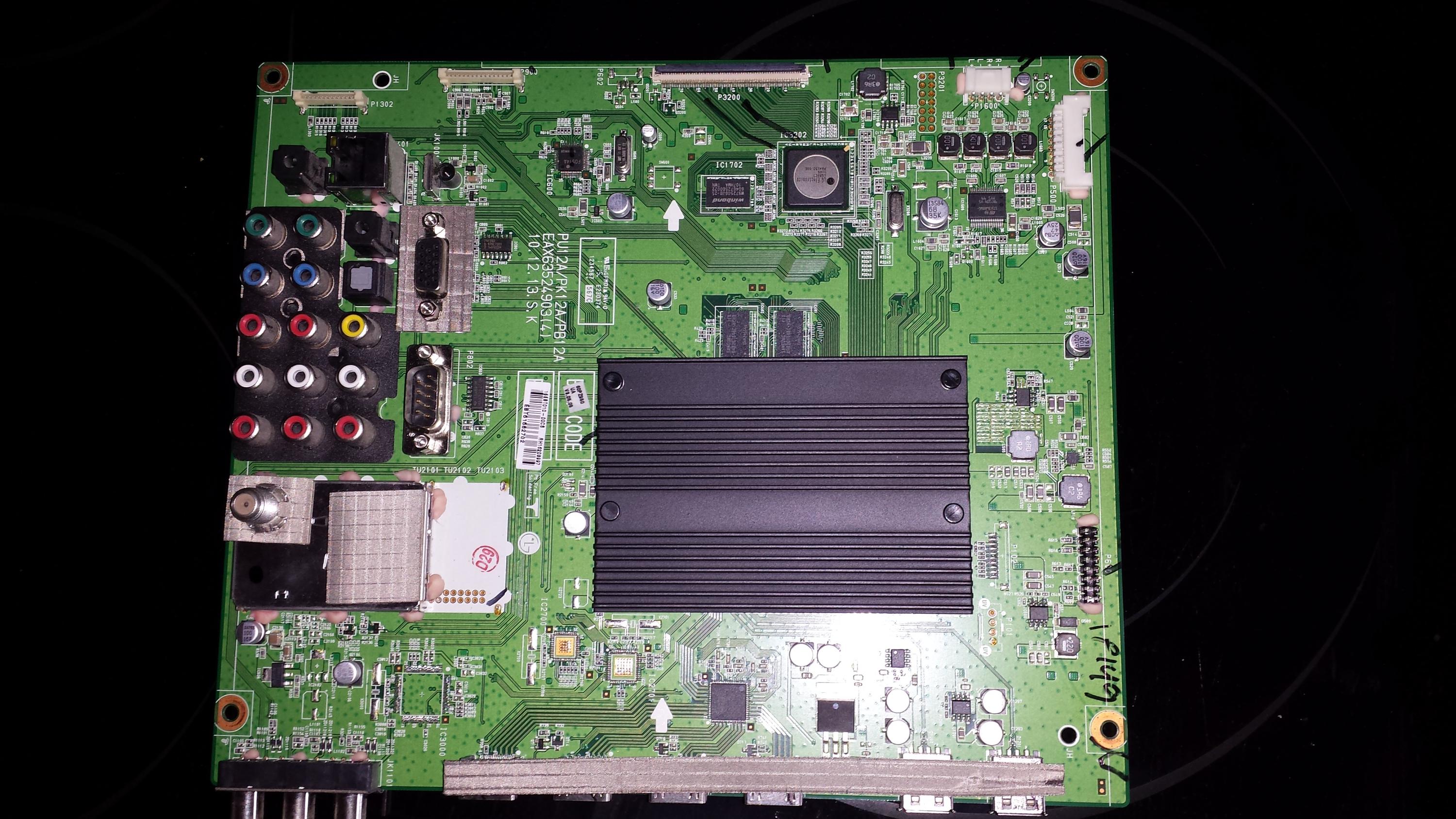

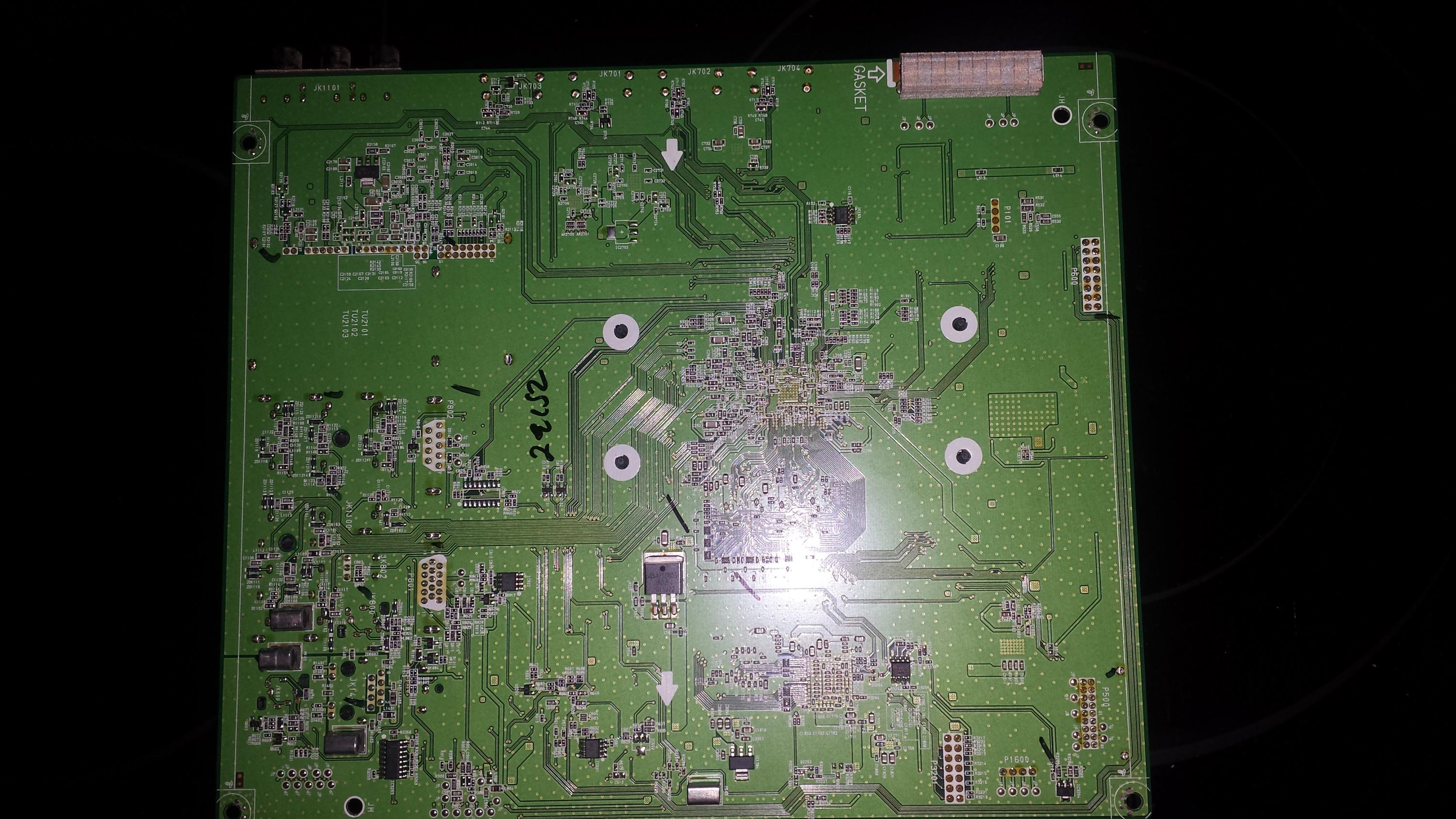

                                    Any way to repair the main board or is it trash. Where is the best place to buy one you can trust ?
                                      possibly can you upload a picture of the mainboard.
                                        First off, thank you very much for your help Hamie. This forum has been a great source of information, your knowledge on plasms is a huge asset to the forum. Just so I understand this, removing the ribbon disconnects the video source and jumping the connections starts a test which confirms the ysus and zsus are able to charge the panel proving no faults in any other board. I uploaded pics of front and back of main board. I did notice a few areas on the back of the board that look suspect. Are there common fault areas on these boards? If I am able to repair the TV I would like to add a cooling system to it. I can't believe LG produces plasma TV's without cooling fans.
