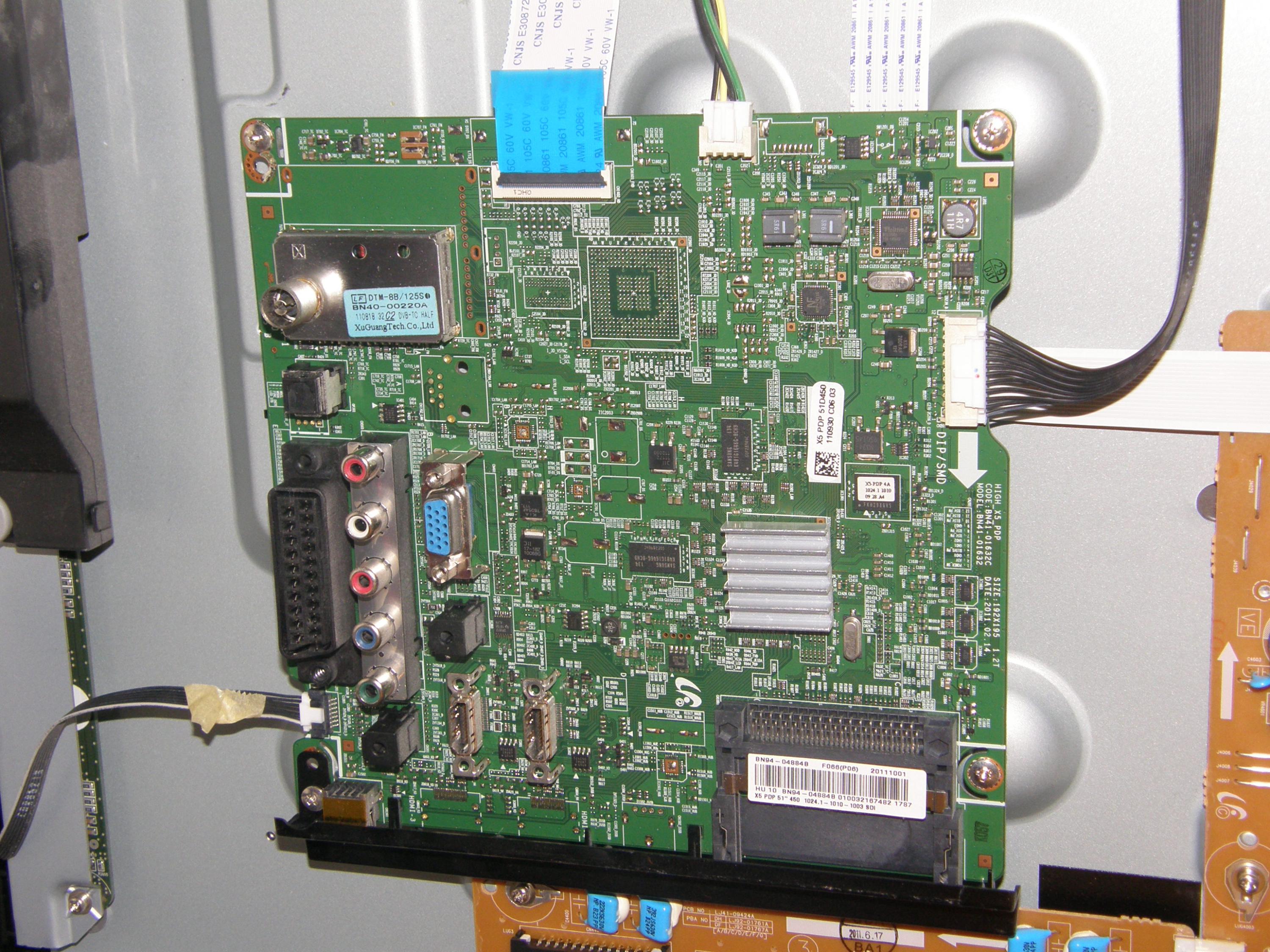

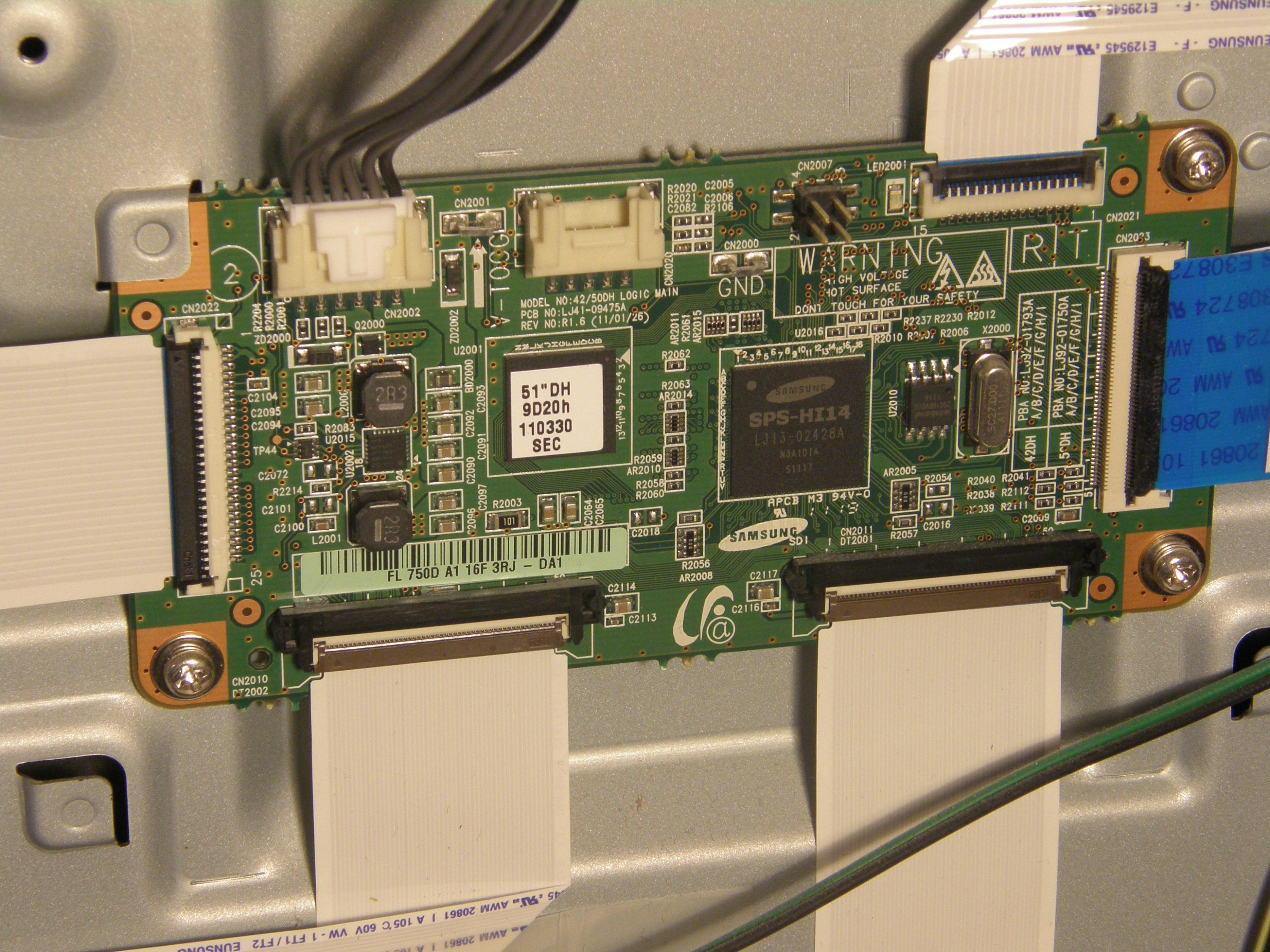

    Hello. I need help trying to fix my TV. It just stopped working suddenly while watching it and, since then, all I have when I plug it is the relay click and red led flashing 6 times. That's all, no image, no sound, no red led, although the red led flashes when I use the remote control. The logic board's green led flashes 5 sec on /2 sec off, which, according to the service manual, means DRV_RESET (no idea what that means). There is not voltage in Va and Vs. Never, not even for a second right after plugging the tv. However the voltages are correct in the flat cable that goes from the PSU to the main board.
    I have tested all the capacitor (they all look ok) for capacity and ESR and they are fine.
    So far, that's what I've done. What would be the next logical step?
    According to what I've read on this forum and I've seen on youtube I think I would have to use jumpers between pins in the connector that goes to the mainboard and try to force the backlight, but probably I'm wrong.
    l'm not a technician and my English is limited, but any help is greatly appreciated. Thanks in advance.

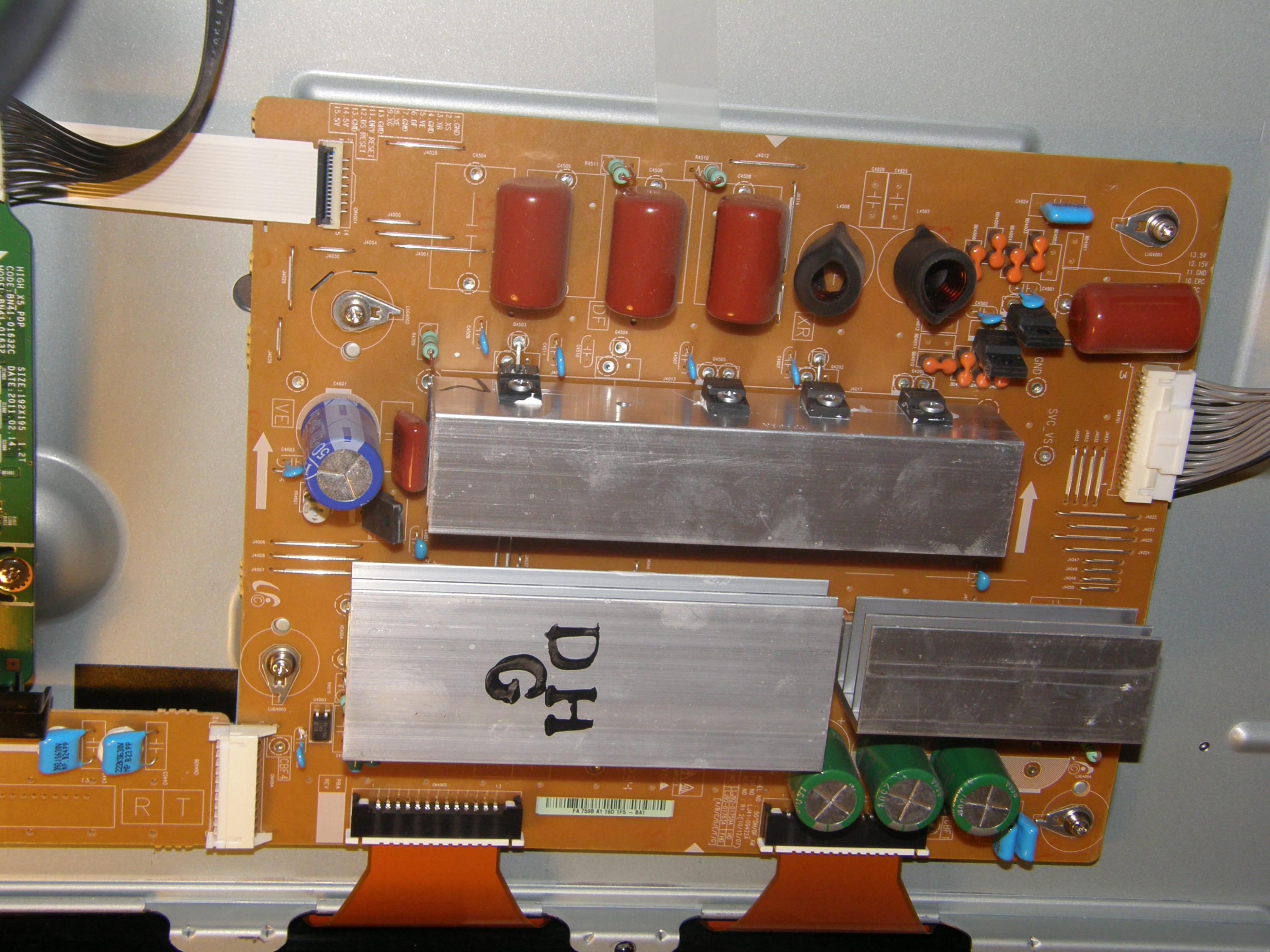

                OK, I would try connecting just the Y-main, see if the Vs/Va still rise. If not, it is the Y-main that is shorted. If it works, then connect the X-main to the Y-main and check again.

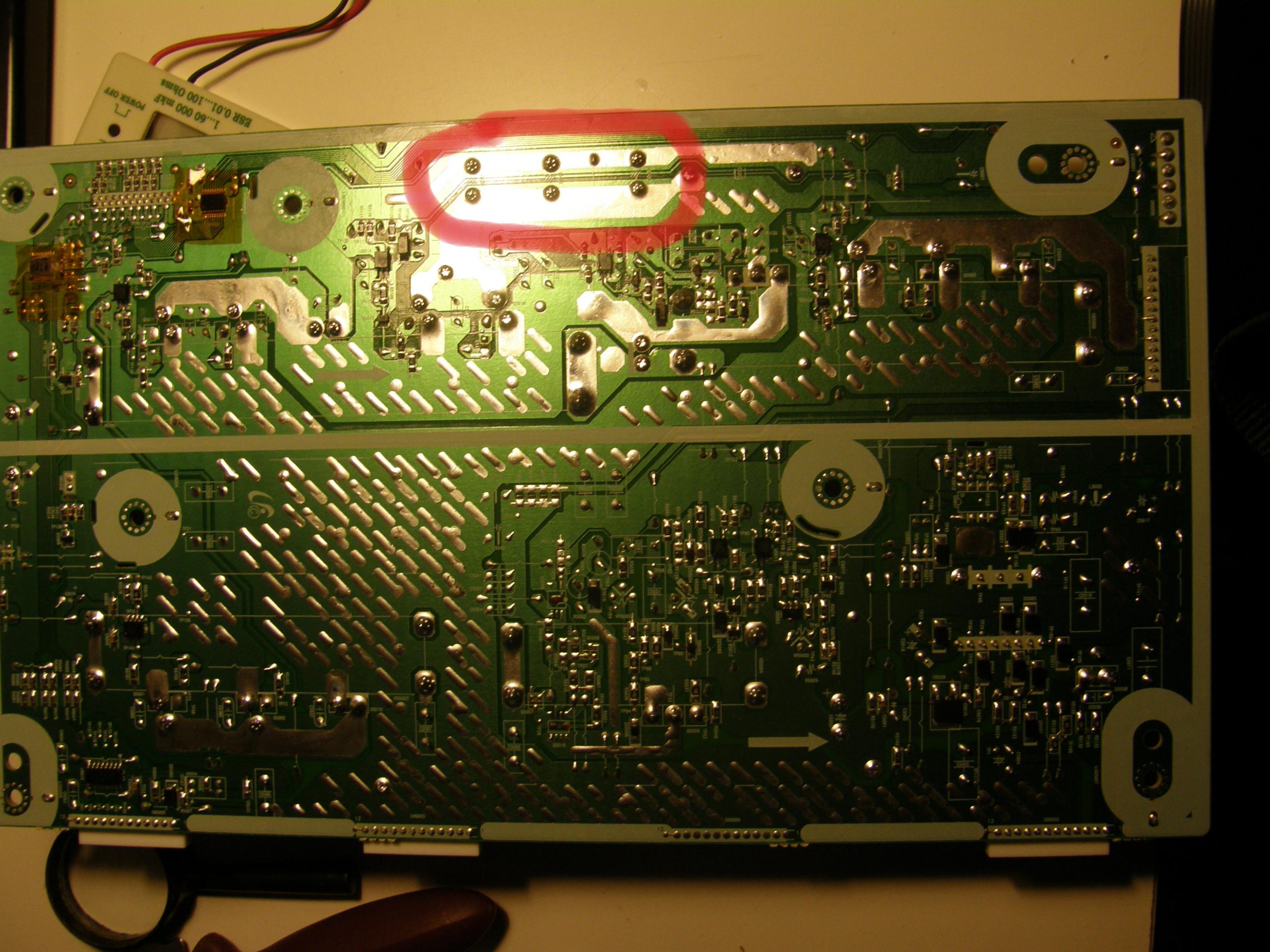

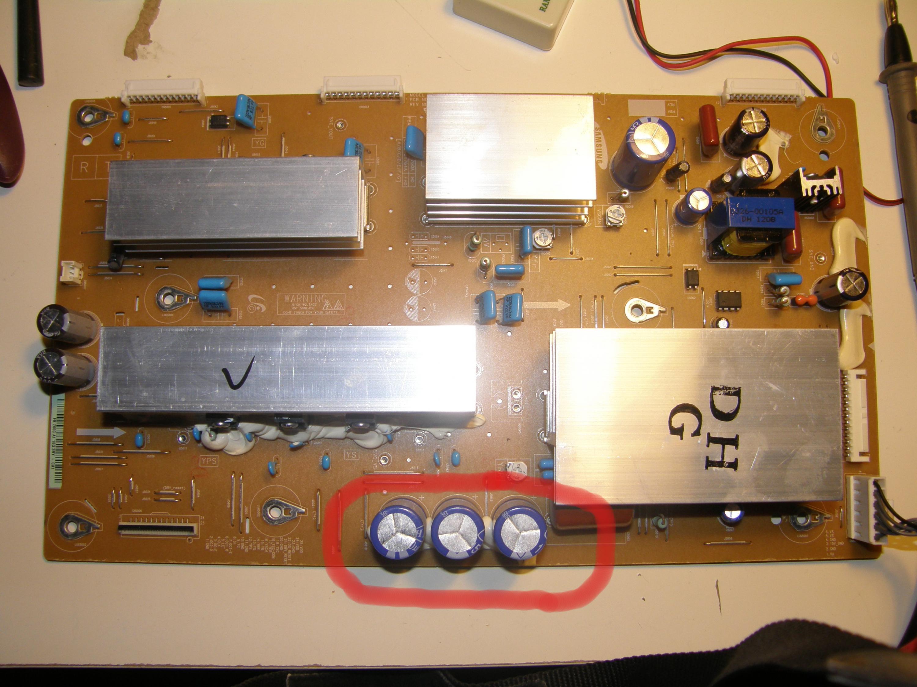

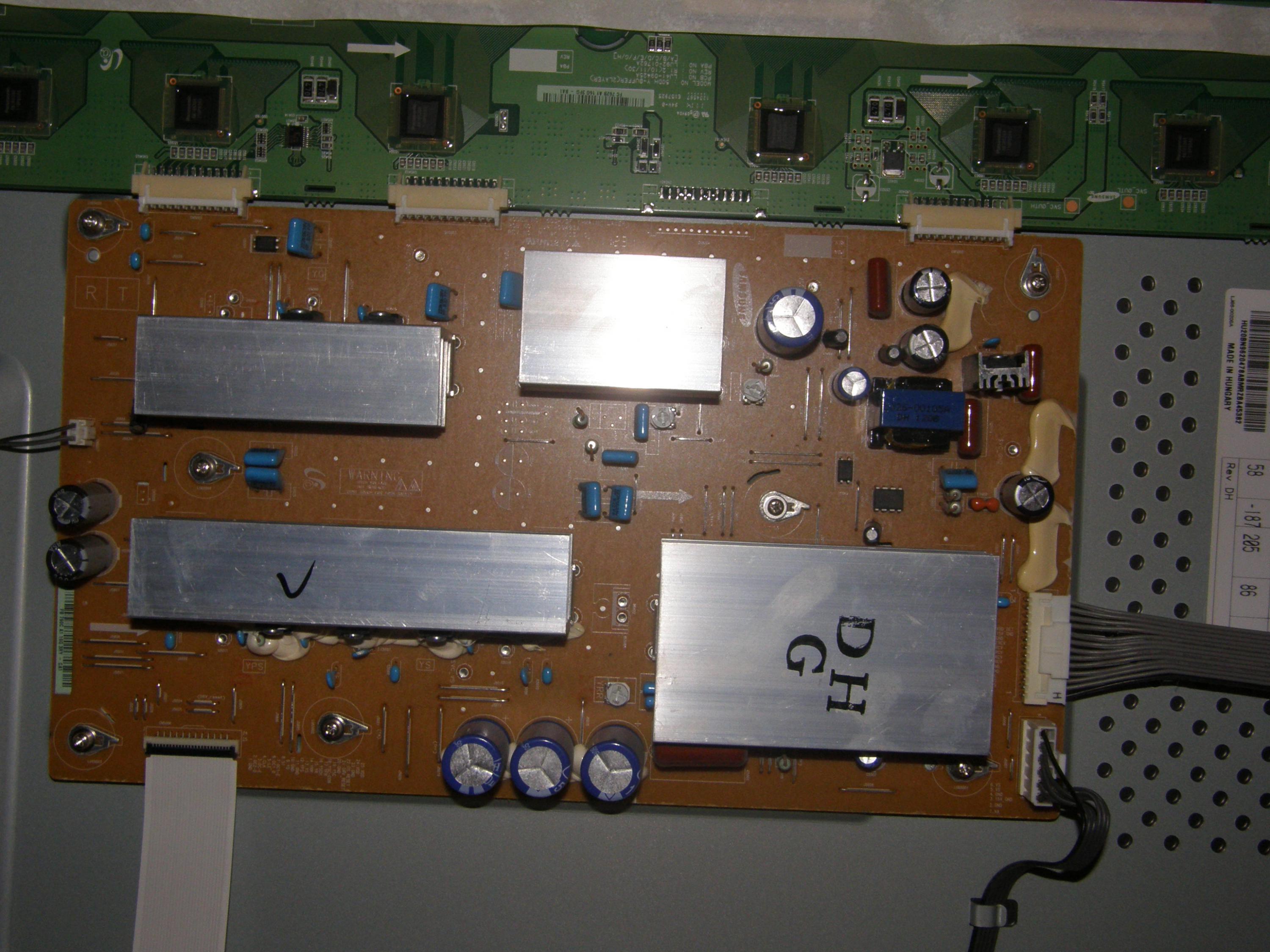

                    I am learning electronics while trying to repair the TV, so I'll probably say something very wrong, but testing the Y-SUS I detected something that seems suspicious to me.
                    As you can see in the accompanying pictures, in the Y-SUS there are 3 large blue capacitors in parallel (150uF 250v). My intuition tells me that these two wide tracks that they are soldered to should not be shorted, but they are.
                    Is that normal?

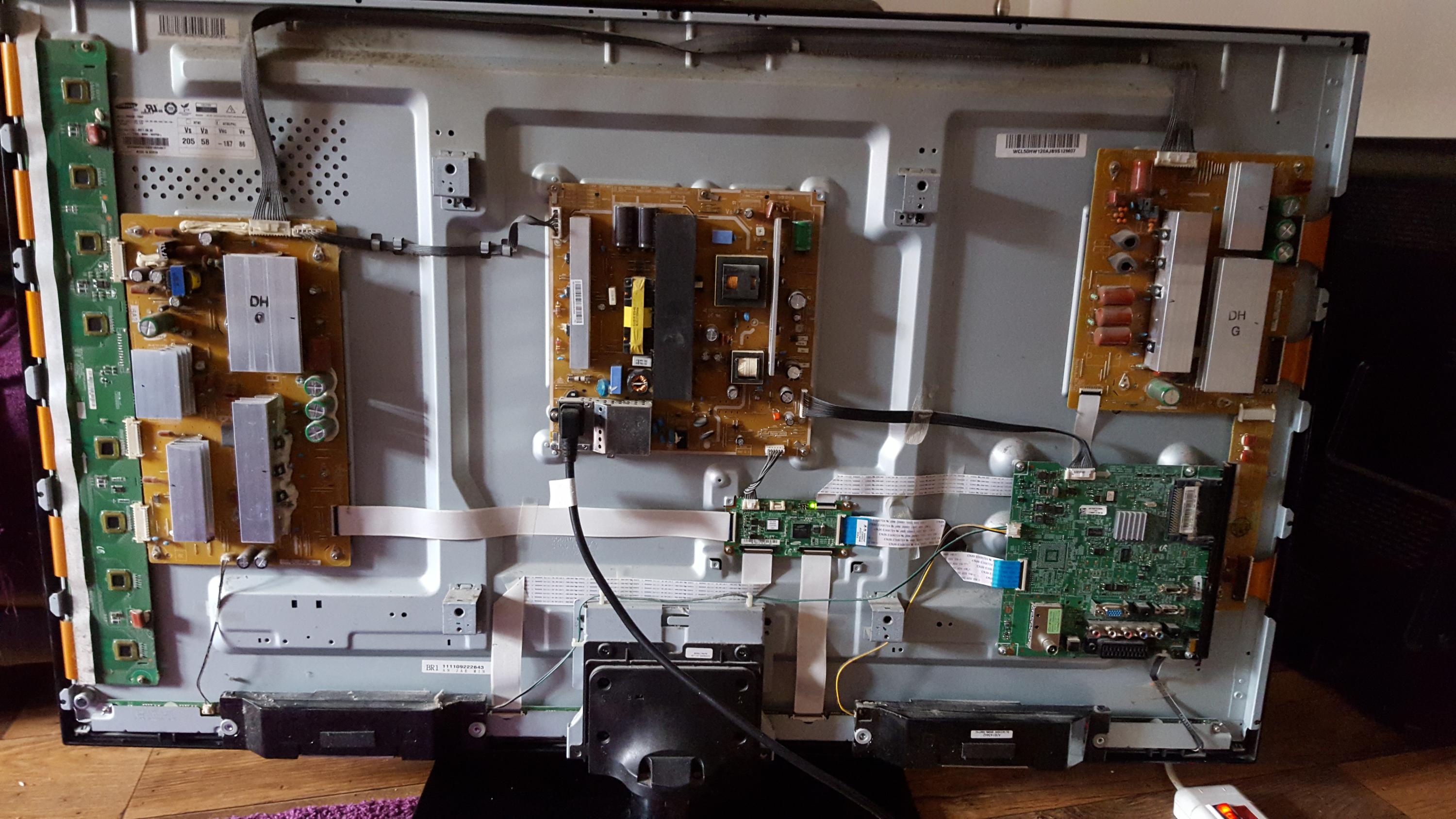

                      Hi. I'm having Similar problem with the same set. What I've noticed is that when I apply power, the picture briefly illuminates (white noise, when not tuned) and then screen goes completely blank. the Red light flashes 6 times and goes out.... I do get the initial click as previously mentioned..
                      Anyone any suggestions? btw, I'm not a qualified repair man, although I have rescued many sets by replacing capacitors etc on PSU's etc. What are the boards mentioned in the previous solution(s)... x/y main / sus etc
                      Can someone show me a pic of which board is which?

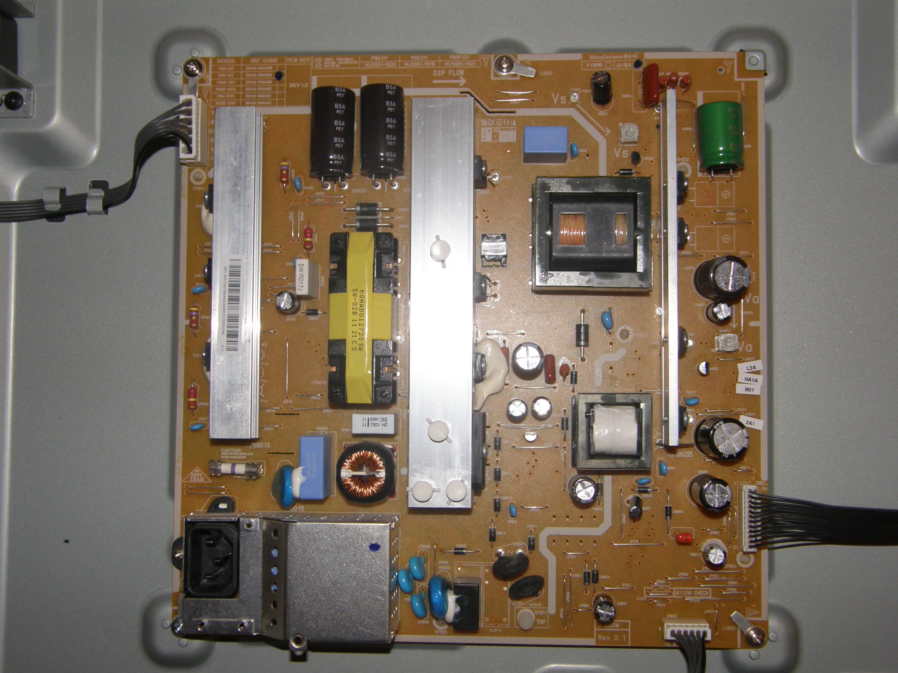

                        Re: SAMSUNG Plasma PS51D450 no power
                        here is a picture of the back of TV... Can someone show me which board is x / y etc and I could probably begin assessing what is going on with it....
                        • Hamie
                          • Apr 2014
                          • 1383
                          Y-sustain to the left.
                          X-main (z-sus) to the right.
                          Disconnect the harness that connects the power supply to the to y-sus and check vs and va voltages.

                              Hi. After trying to repair the shorted Y-sus for a few months I finally decide to buy a second hand Y-sus board. The TV works perfectly again. Thanks tom66!
