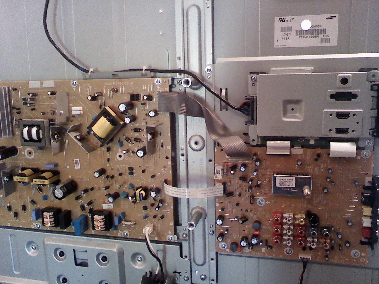

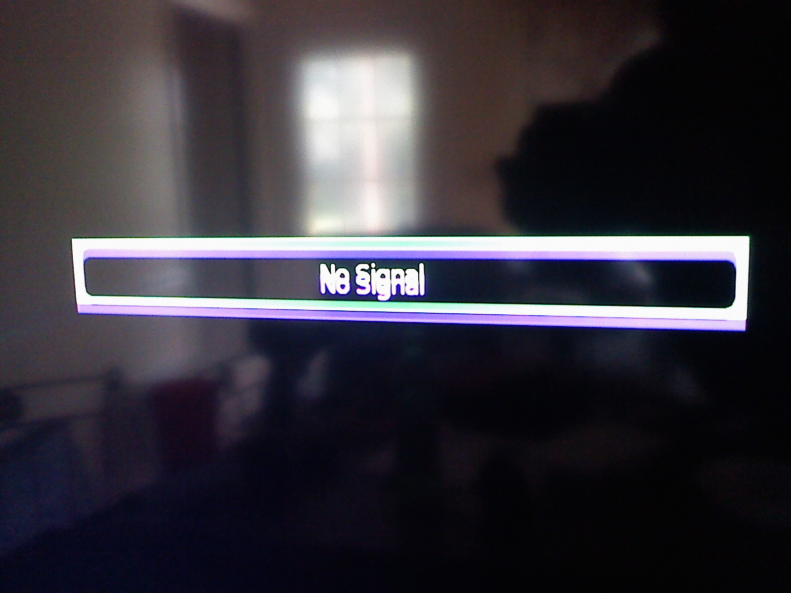

    LC401EM3F Color Convergence?
    I know there is no such thing as convergence any more but it is the only way I can explain it. The Model doesn't have a Tcon just a connector from the Digital main board to the LVDS that's connected to the panel. I have replaced the Digital main board and ended up with the same results. I have put pressure on the tabs from the LVDS to the panel no change. The panel is a Samsung Lta400hm09 . Any thoughts on where to start looking Kinda stumped.

    Re: LC401EM3F Color Convergence?
    If it doesnt respond to pressure on the tabs--It'll be the panel itself.....
    TELEFIX
      Known issue with these Samsung panels. Bad panel, unfortunately.
        Thanks to both. had suspected it might be so. lets call this one dead and closed
