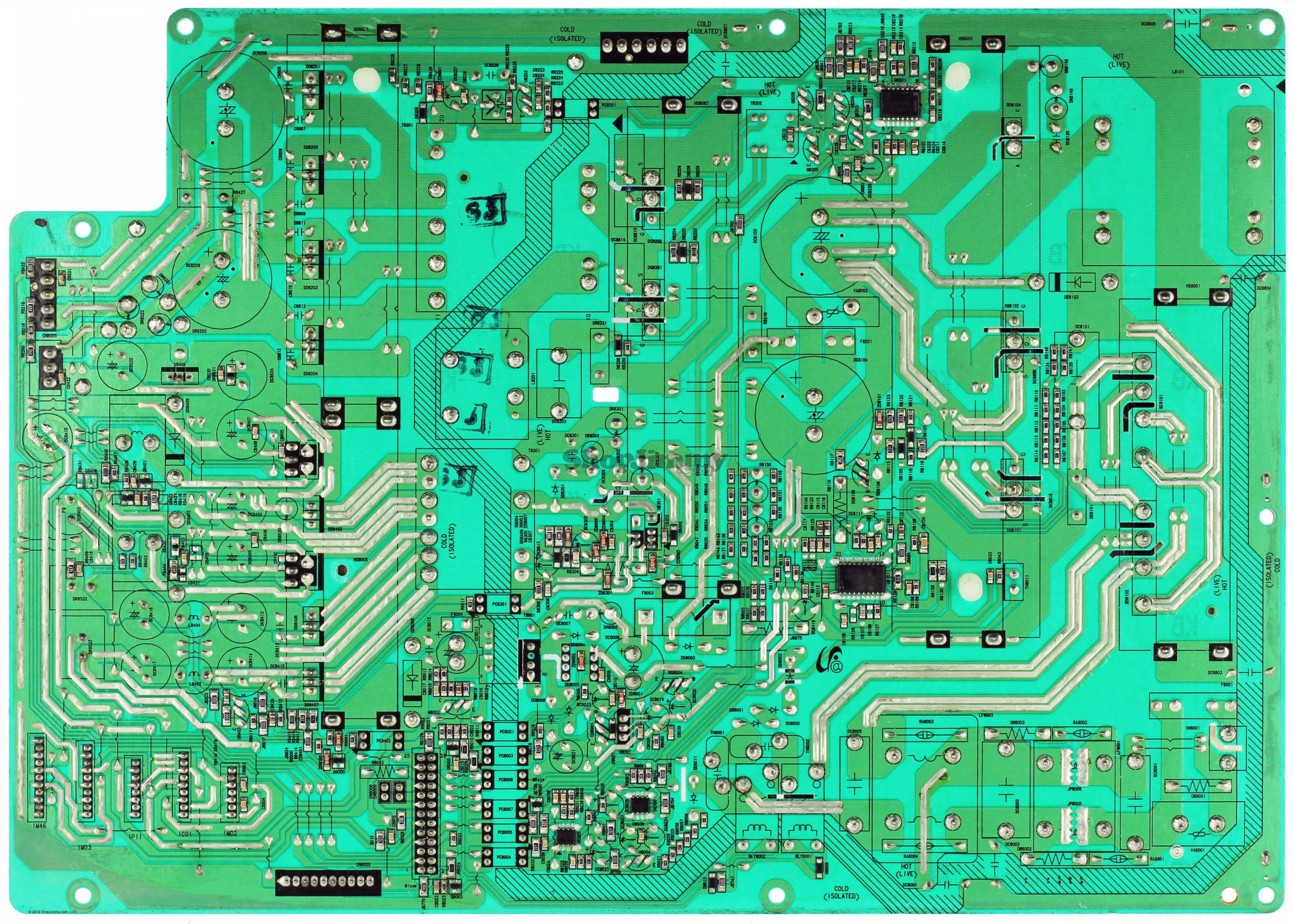

    I have attached an image of the back of the power supply. I had a zener diode ZD8001, that was open in both directions.
    From my understanding, the zener in question is of type: Rohm LL-34
    If this is the case then the part number for the zener would be: RLZ30B
    Is this correct? What can I use as a substitute?

    I'm really looking for a substitute, because I can't seem to source the RLZ30B

      Found an equivalent zener diode manufactured by ROHM. It's a different package, but identical specs.
      The part number is: TFZGTR30B
