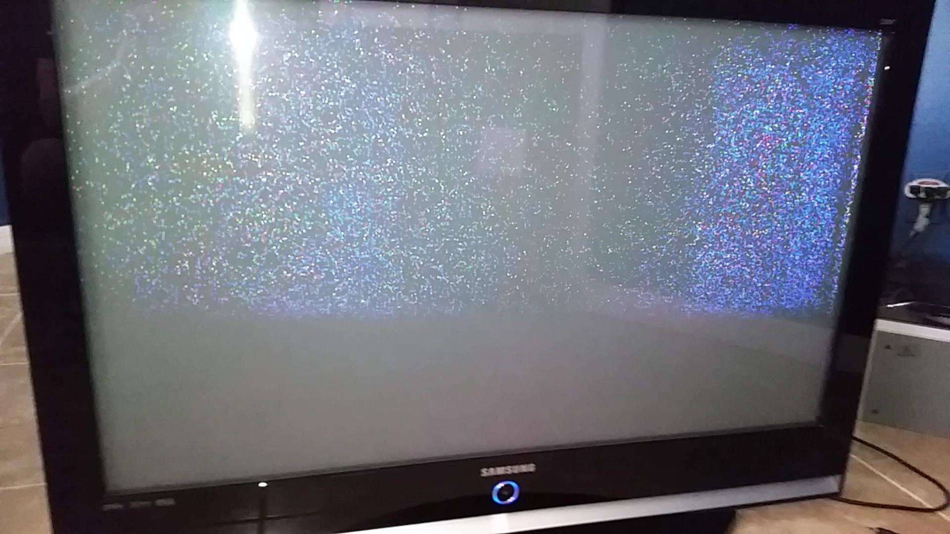

    Samsung HPS4253X/XAA plasma.
    This plasma won't turn on.
    When I plug it in I get a flash of "sparkles" of all colors for less than a second (see pic#1).
    Afterwards it's just relay clicks--powering on and off with no picture.

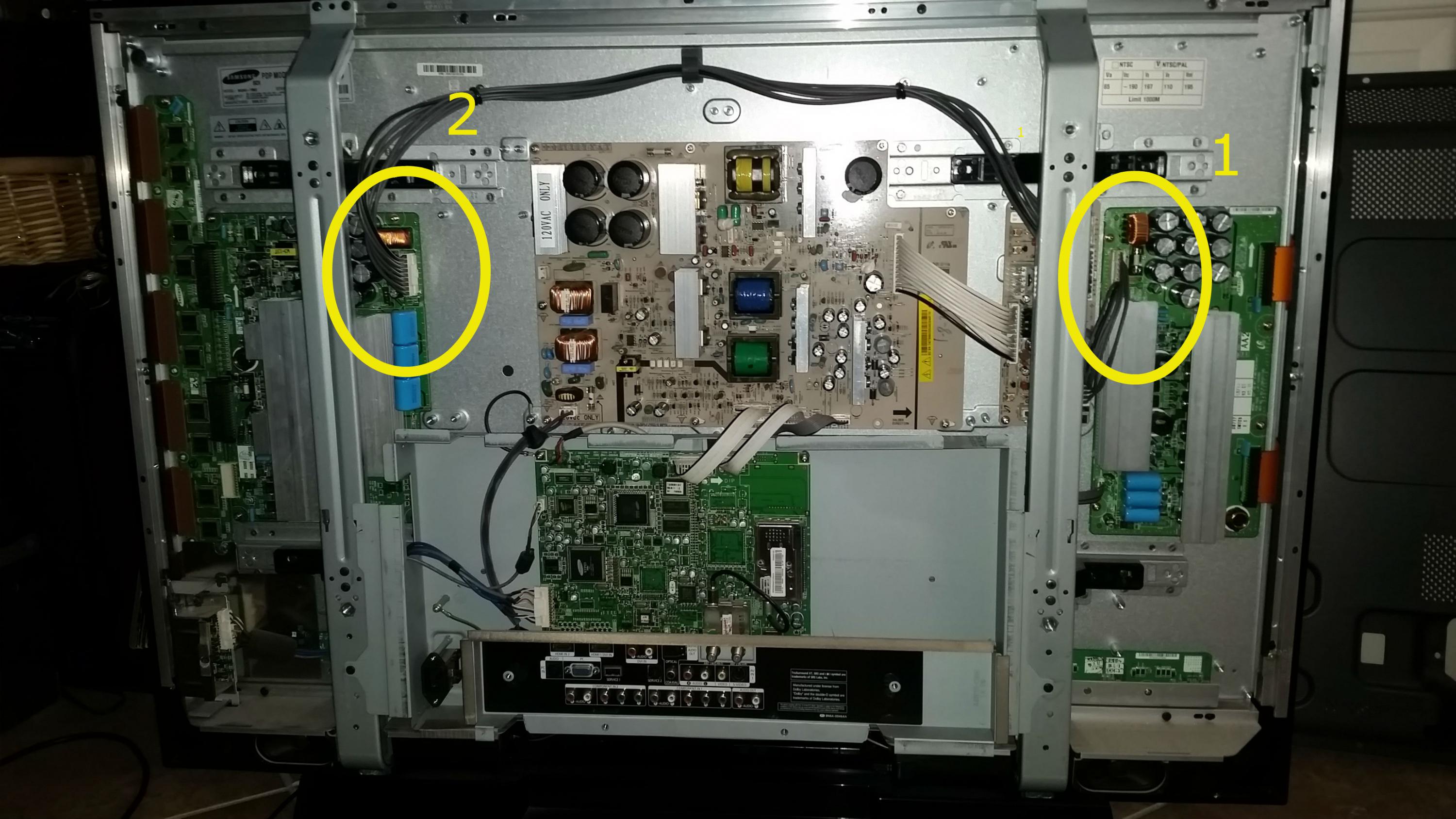

    I took off the back cover to check out the y/z sustains. (see pic#2)
    I unplugged the z-sustain (yellow circle #1) and I would get the same result--sparkles for a split second.
    Then I alternated and unplugged the y board (circle #2). When I unplug this one there is no sparkle, just a black screen.
    I don't see swollen capacitors or any other visual damage. Also, my readings for Va, Vsc, Vs, Ve, and Vset all check out according to the table on the tv.
    How to fix?

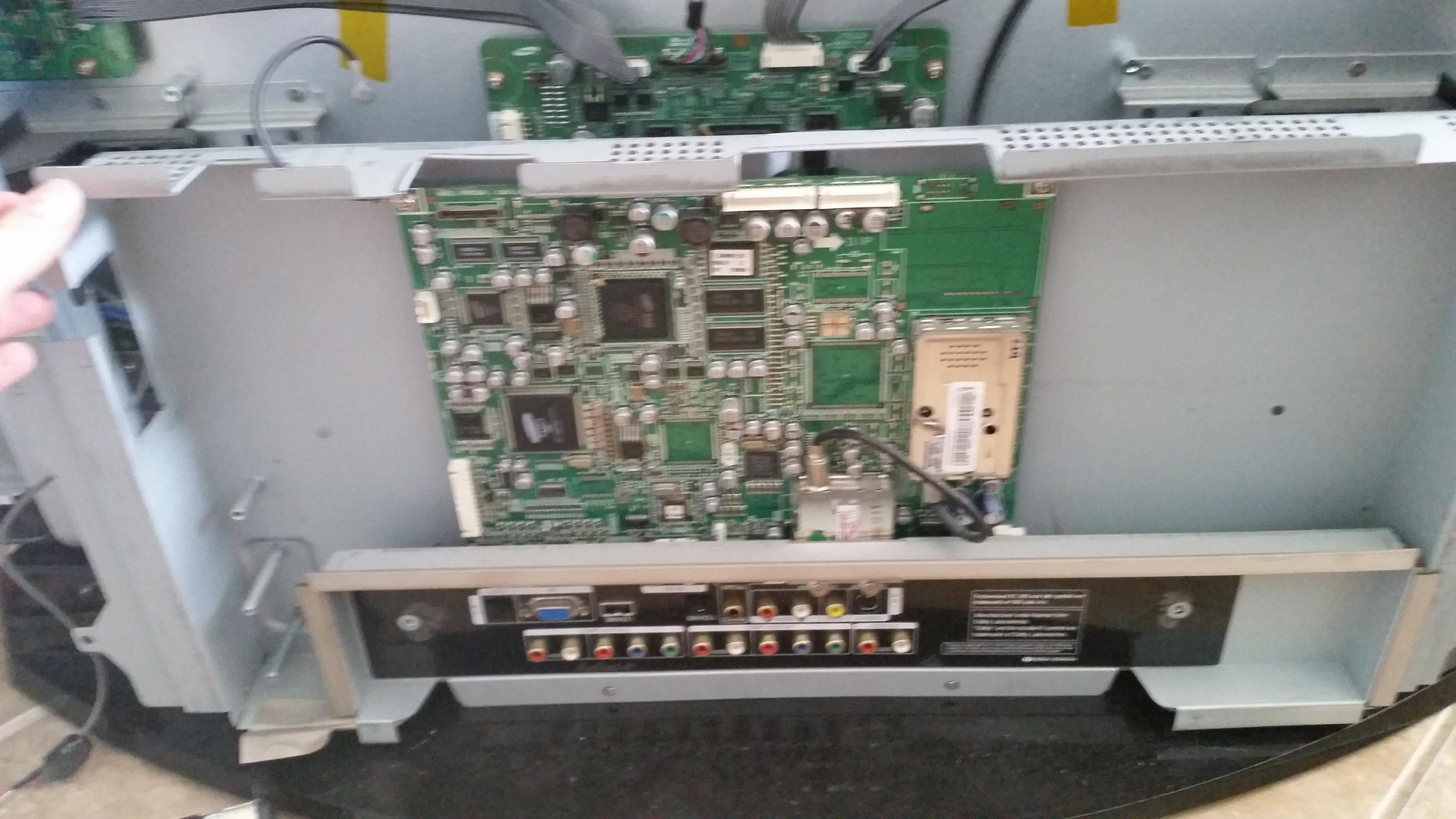

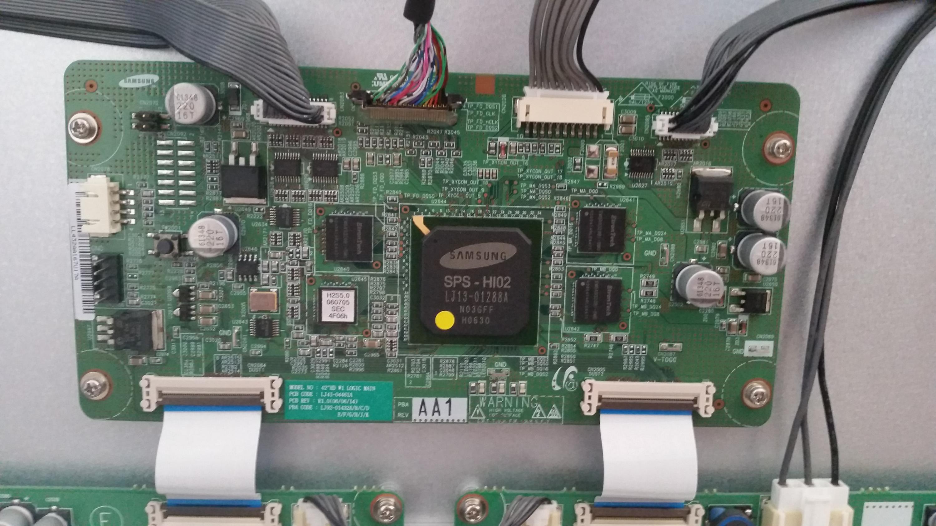

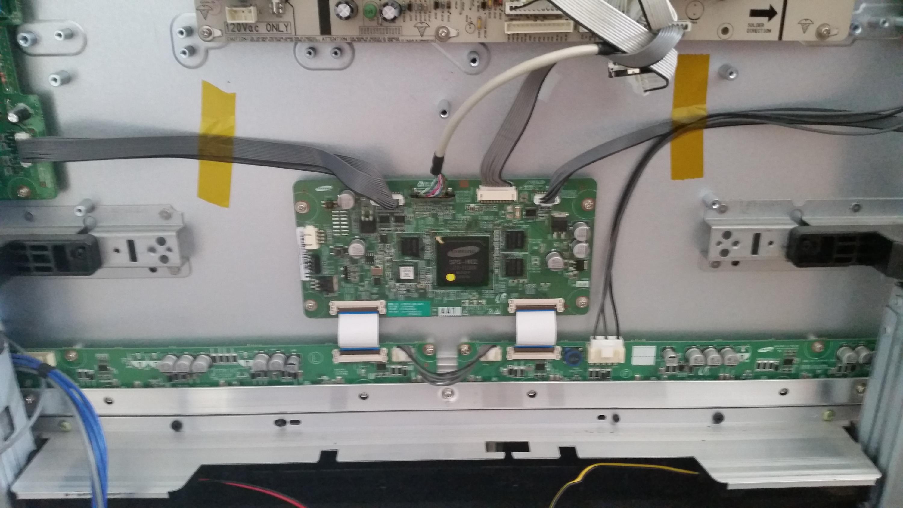

            Ok, would you be able to get a clear photo of this board? I suspect the main board is not sending a video signal to it.
            Tom, I apologize for not responding sooner.
            I had to unplug a few pins and remove a board in order to reveal the board that has the blinking lights.
            The first photo shows the board i had to remove, the second photo shows what was behind that board, and finally the third photo is a close up of the board you requested (the one that has the blinking lights).
            Thank you for your time. If there is anything else i can do to help find a solution, please let me know.

                  Ok you see the small black square at the top left of the control board, with the 4 pins numbered?
                  Use a piece of wire and connect pins 3&4.
                  Disconnect the LVDS cable (the one with the different coloured wires)
                  Power on the tv and if you get test patterns on the screen you require a new mainboard.

                      Re: Samsung HPS4253X/XAA Plasma
                      Firstly, thank you for taking the time to respond to my thread.
                      I followed your instructions. I connected pins 3 and 4, and left the LVDS cable disconnected.
                      Unfortunately, the television does not display any test patterns. Nothing has changed.
                      Is there anything else I can try?
                        So--With the set all wired as intended--all plugs connected etc, The voltages are all correct?
                        --Particularly the -Vy and VSC and Ve....?
                        --There is no very dim glow from the panel--may need a dark room to see....?
                        If not, I think I would be looking for an Open circuit device--fusible resistor, MOSFET IGBT etc on Y-SUS or X-SUS....
                        Its the mal-discharge when first turned on that makes me think there's something amiss in Y-SUS..
                        Do you have a dual-channel 'scope...?
                        Time to check waveforms I think....

                          I've checked the Voltages according to the table that's next to the boards. I remember that everything checked out.
                          As for your second question. There is DEFINITELY a dim glow when I turn it on.
                          Thanks for your time.

                                        There are 3 boards that we are talking about which are located towards the center.
                                        My pictures show a board towards the top (1), and two towards the bottom with one in front(2) and the other behind it (3).
                                        If I'm not mistaken, the boards are
                                        1. Powersupply
                                        2. Control board
                                        3. Mainboard
                                        is this correct?
