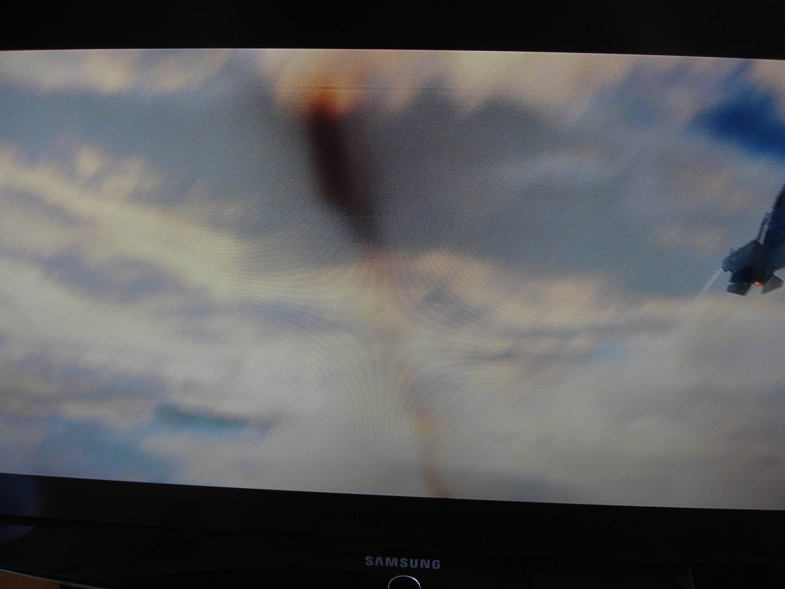

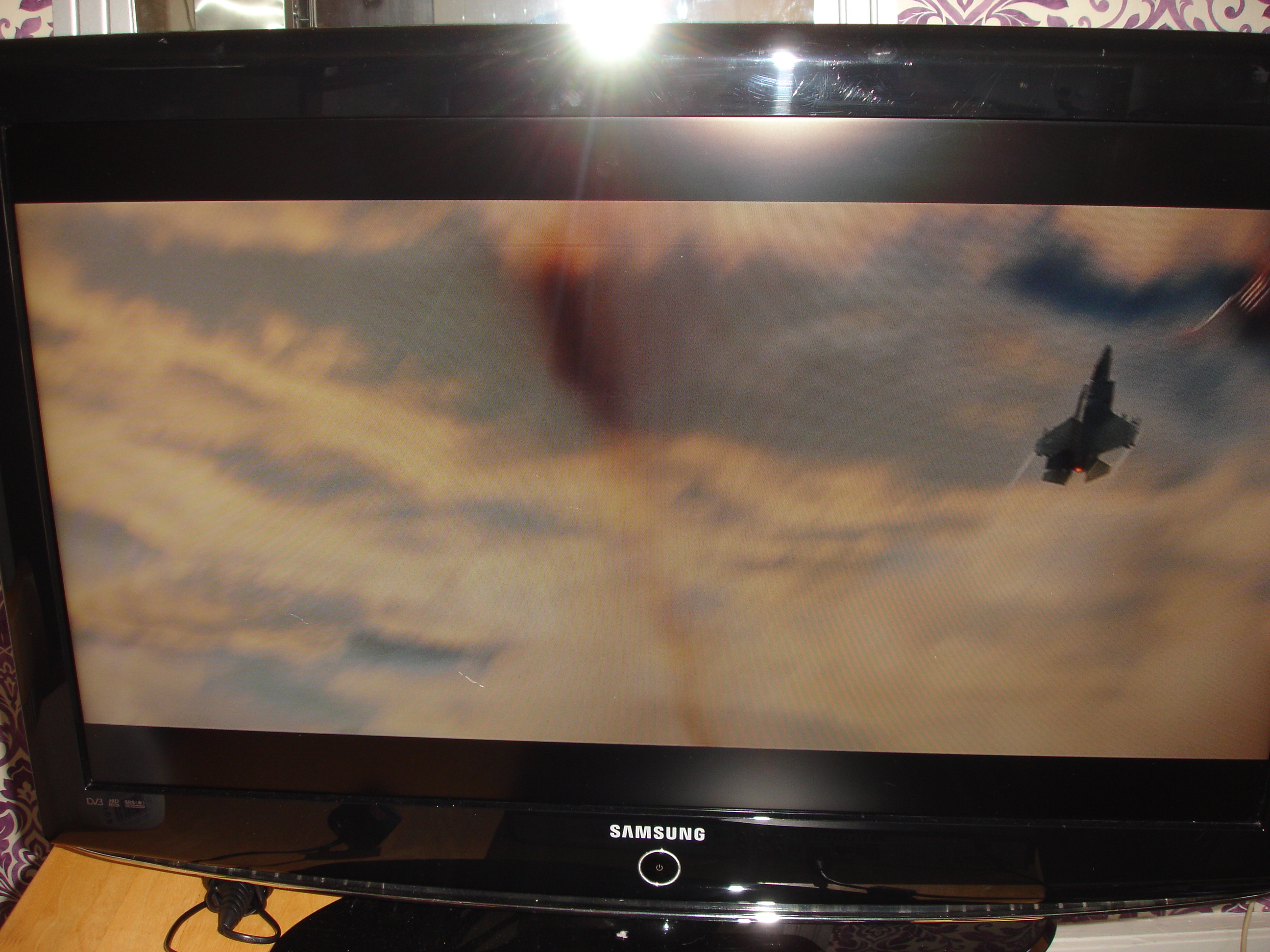

    I have a black mark on the scree just wondering if its the panel or could it be the t-con you can see the marks on the pictures I have put on here

    is it in the menus too?
    have a samsung with similar except it's blue and horizontal, which is a panel fault, also a bordeaux model

      yes its in the menus to
        Re: samsung le37r87bd
        Non repairable panel defect. Crappy CHUNGWHA panel I'm guessing?
