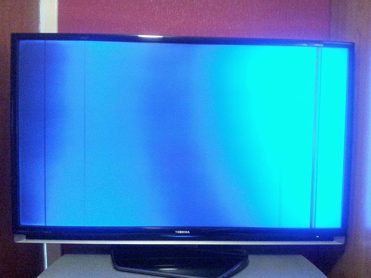

    Hey all
    I've got this TV in (Toshiba Regza 46" LCD 46XF355DB) with a faulty picture (see photo), it has sound. It then switches off after around 10 minutes. I reckon after some research this particular model has an issue with the panel. Anybody have any experience with this model ?
    Mark
    Re: Toshiba Regza 46" LCD 46XF355DB Faulty Picture and then switches off
    I would agree, definitely panel.
      Hi Tom
      Thanks, appreciate your help.
