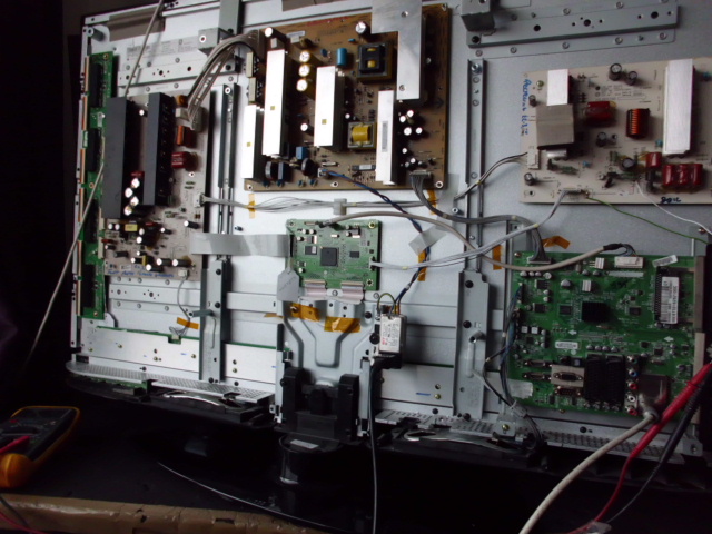

    I'm going round in circles with this one.
    TV powers up. Channel station number displays sometimes with sound.
    Click on menu, menu displays for milliseconds, power turns off.
    VS=195v, Va=60v, 5V=4.9v, ZA 75v(should be 80V)
    I've replaced;
    Y sus, Z sus boards,psu and ysus buffers
    That only leaves bottom buffers and lvds/t-con
    Any help or advice welcome.

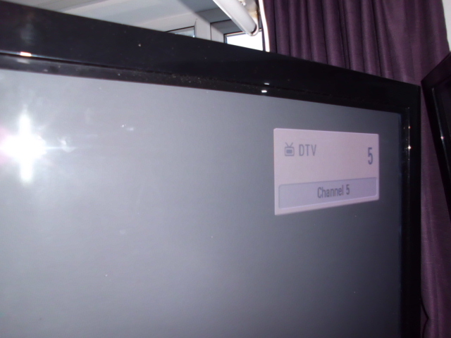

      On power up , relay clicks in, green light comes on, I get a picture and sound for about a second then relays drop out.-red light comes on.
      Heres a pic of tv on for that split second with sound. Its not a full picture of the station only a picture of the station number which shows in the top right of screen. For a short while when I got this far I managed to go into the menu bar then when I clicked on setup it powered down.
      Thanks for showing some interest.

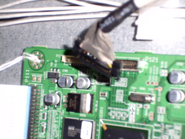

        There is a main board, with the video inputs on it, and a board in the middle of the set - the control/logic board. On the control board, there is are two points marked EXT AUTO GEN. Please place a wire jumper between the two holes, and disconnect the LVDS cable which runs between the main and control boards.
        You should get some patterns showing up, do you?

          I soldered a link wire to the holes & disconnected lvds cable going to the main board.
          Standby goes to blue, relays click on screen shows signs of life -backlight only then relay clicks off,standby stays blue,after a couple of secs standby goes red. Cycle repeats itself as long as power remains to the set.
          Hope thats been of some help.

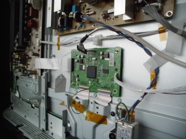

            Can you show me which cable you unhooked so I can be sure it's the right one?
            • Cornboats
              Dave
              • Oct 2010
              • 232
              • United Kingdom
              Re: LG42PQ3000-powers up & cuts out
              heres 2 pics to confirm.

                That is the correct cable, you did press power button and TV light went blue right?

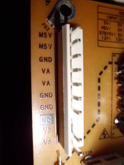

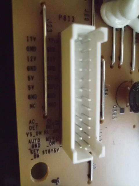

                          PSON and VSON to 5V Standby. If there is an M5V_ON or RL_ON jumper that too.
                          • Cornboats
                            Dave
                            • Oct 2010
                            • 232
                            • United Kingdom
                            Is this to get a pattern from the control board?
                            I can't find PSON and VSON to 5V Standby. I'll upload the only 2 connectors on the smps board.
                            I've got M5V on & RL on. Do I jumper these to the 5v standby or to themselves with the 100 ohm resistors?
                            Do I refit the connector from the main board-if so I need to solder jumpers underneath.
