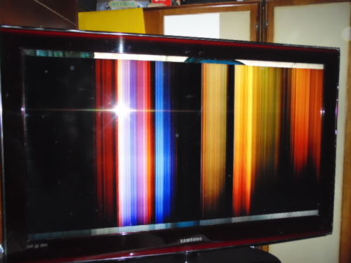

    Samsung LE-40A656A1FXXU 40" faulty going to put a picture of the fault any idears please could it be the t-con thanks

    for got to say you can see a bit of picture at the top and bottom of the screen
      Re: Samsung LE-40A656A1FXXU 40"
      Sorry, looks like a bad panel to me. To rule out tcon you could try checking VONE and VOFFE on tcon board. Post a pic of tcon if you're not sure what to do here.
      VONE: +18V to +30V
      VOFFE: -4V to -10V
