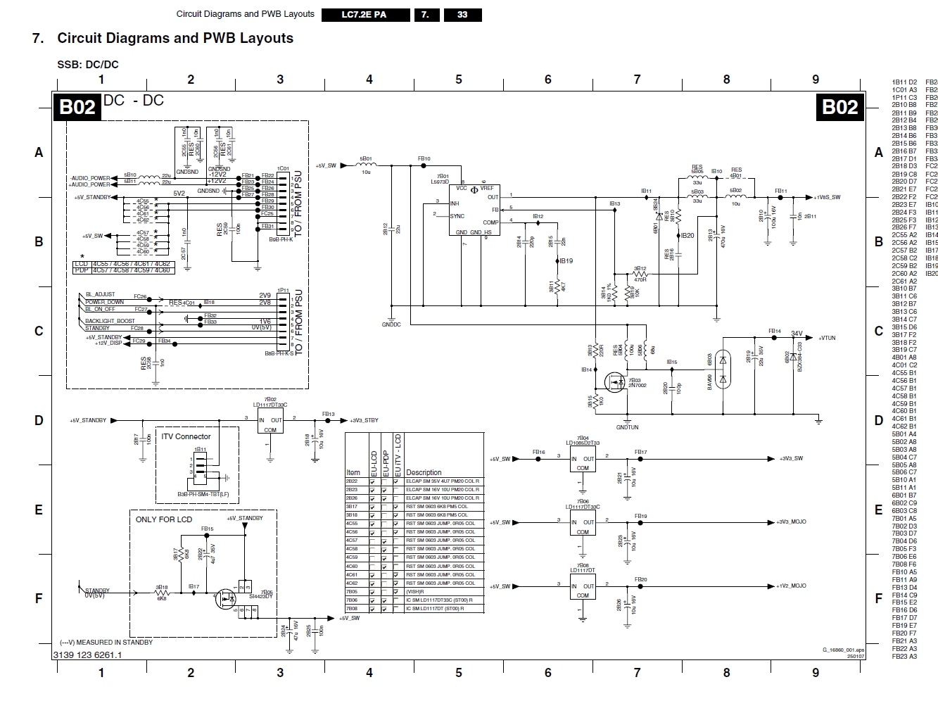

          I believe (might be wrong) this main board uses +12V and -12V for audio, which is rare these days. Check that both rails are stable. It's possible that the plasma version of this set does it differently, but I know the LCD version does this.

            Tom, you're right about the +12V / -12V on this one.....shown on the attached diagram. PS connector 1C01 carries the two voltages at pins 1 & 2. I'll check these also for stability before and after caps change.

              UPDATE: Checked those two lines +12V & -12V (for the audio) off the PS board connector 1C01 (to the SSB). They are measuring +17.05V / -17.05V !!
              So, PSU is putting over-voltage into the audio side on the SSB. Supposedly this is due to the bad caps I can see.....I'm hoping anyway. I'll swap these today and hope it restores the voltages to the +/- 12V.
              Could this be the reason for the poor sound? I'm guessing it's not helping!
              I'm hoping that the over-voltage hasn't caused any faults down line with the audio circuits.

                  That could certainly cause harm - you would need to check datasheets of the chips connected to see if they are at risk of damage. Also, check stability while playing program audio, see when sound is "mushy" if supply voltages drop.

                    After checking Vsnd voltages off power supply board for the audio....thinking they should be +/-12V.....replacing the 'pregnant' caps on board....re-checking Vsnd...still +/-17V.....finding out, after much research, that Vsnd SHOULD be 17V....I finally (whilst the lower back speaker cover panel was off and the TV on) thought, 'I know what that is....it's just a blown speaker'!!
                    And, sure enough, substituting 'bad' side speaker leads to good-sounding speaker proved, in all that time, it was just one side blown speaker!! Something I should have done right at the start! Arghhh!
