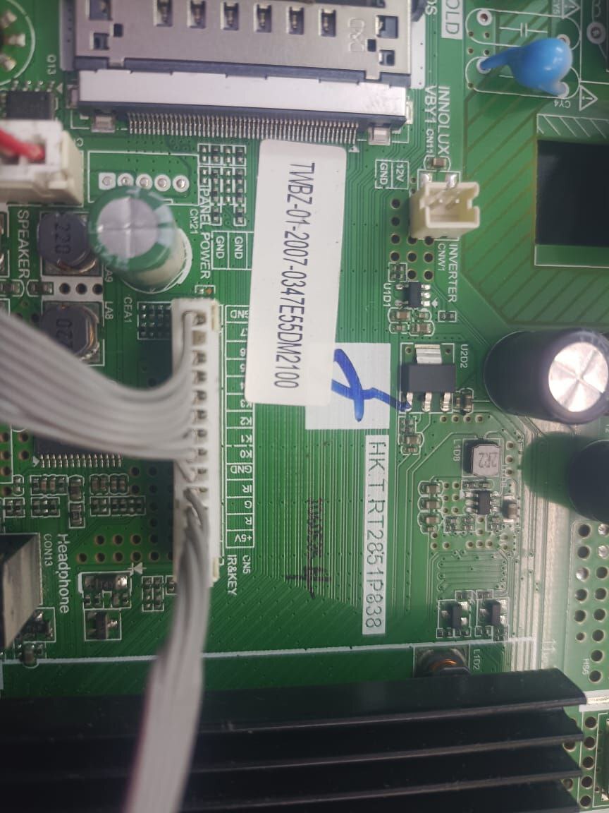

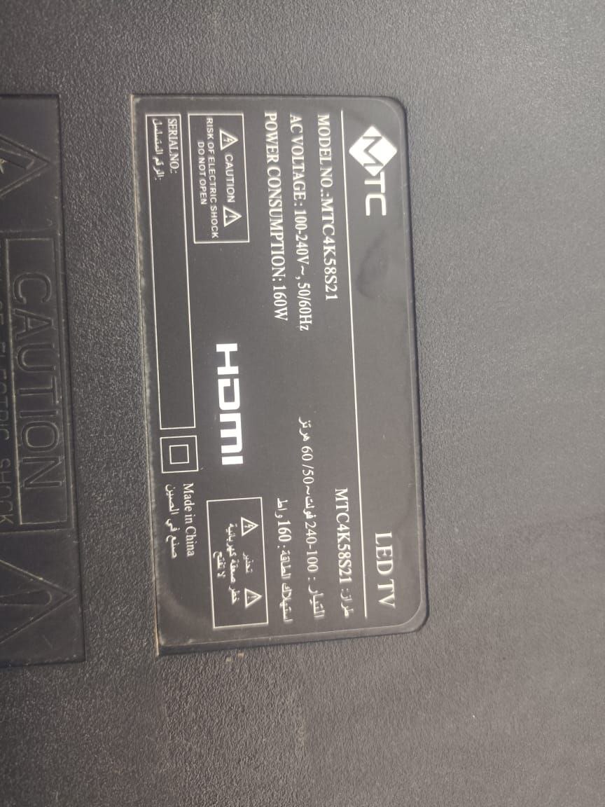

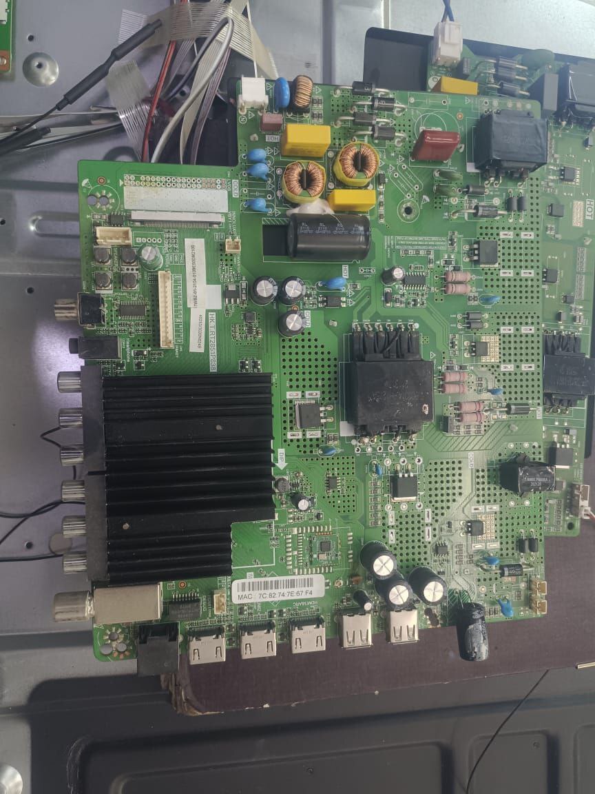

    Hello friends, I have MTC 58' TV which has stand by position. I thought the software was corrupt. I have downloaded the software from the internet but the data is not matching. The format window is opening from the TV software but none of the buttons on the remote or TV are working. Why? Can I edit this software with a hex editor? Is there any guide to edit this? Or does anyone have access to this software? Thank you very much for your help.
    model no.---'[Mtc4k58s21]
    panel---D58-M30

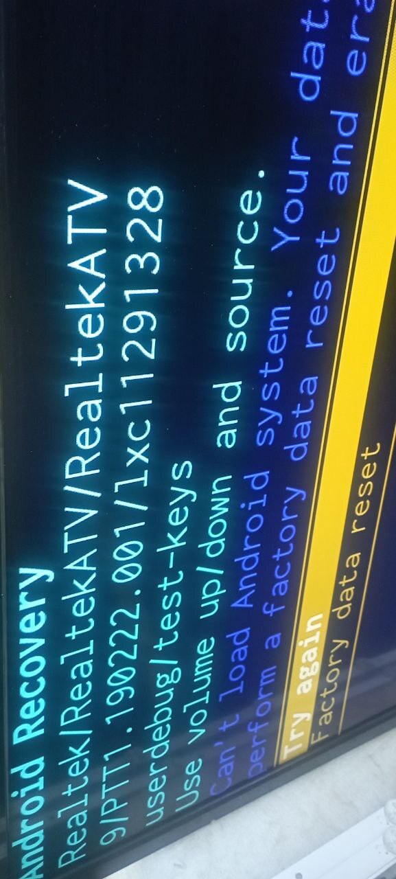

    from yours recovery photo it say user_debug .. it mean it rotted or ready for root... generate new remote.conf keys file via adb shell... and place it over write the exist one at /system/etc with permission 0644... or pull the one exist modify it and push it again

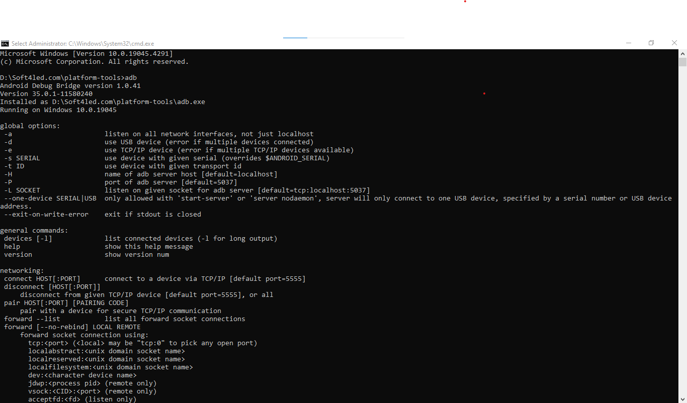

          Sir, from the hint given by you today I came to know that you are talking about literary ADB tool. I typed cmd as type in Python and this window opened. What to do next, sir, please tell me the way, I don't have that much money. I can't do programming courses. I learned a lot with your help. Thank you very much for your time.

            use normal usb mouse with TV instead of the RC because its not working... when yours TV start on and it show the recovery screen... try to hit with mouse the option factory reset... hope the temp file still there so it will install again

              I tried with bluetooth remote but it is not working. The TV LED is blinking red green red green repeatedly. None of the buttons are working.
