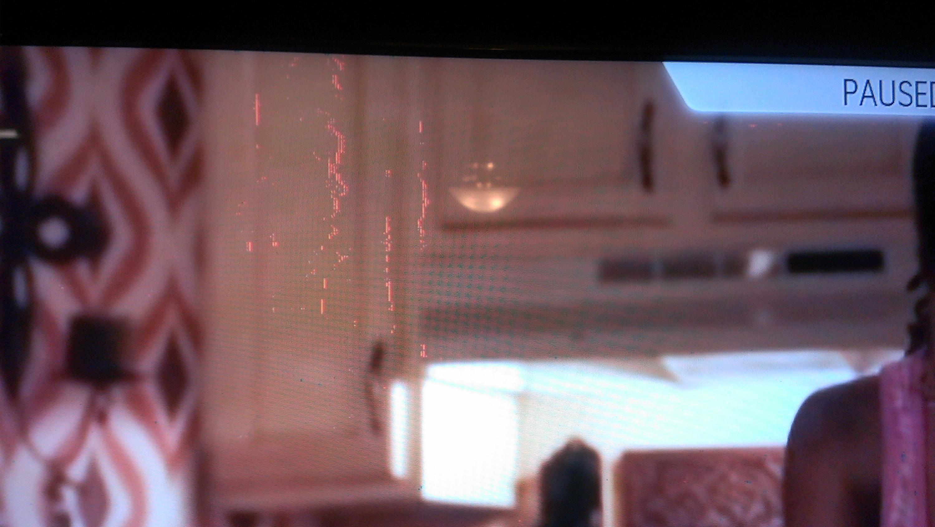

    Samsung LN46A850 LCD Distorted colors
    Weird distortion that occurs occasionally. Anyone have any ideas what could cause this?
    EDIT: Forgot to include Model #
    Re: Samsung LN46A850 LCD Distorted colors
    This TV have 100Hz motion enhancer? Try disabling that.
    • fuxxy
      • Jan 2013
      • 318
      I usually keep the 120Hz disabled, I'll double check that
      • fuxxy
        • Jan 2013
        • 318
        It was set to Medium - Turned it off and problem resolved! Thanks!
        • coffeeman200
          • Oct 2013
          • 2
          I usually only have this problem with certain inputs. But luckily i like the option off anyway
          • fuxxy
            • Jan 2013
            • 318

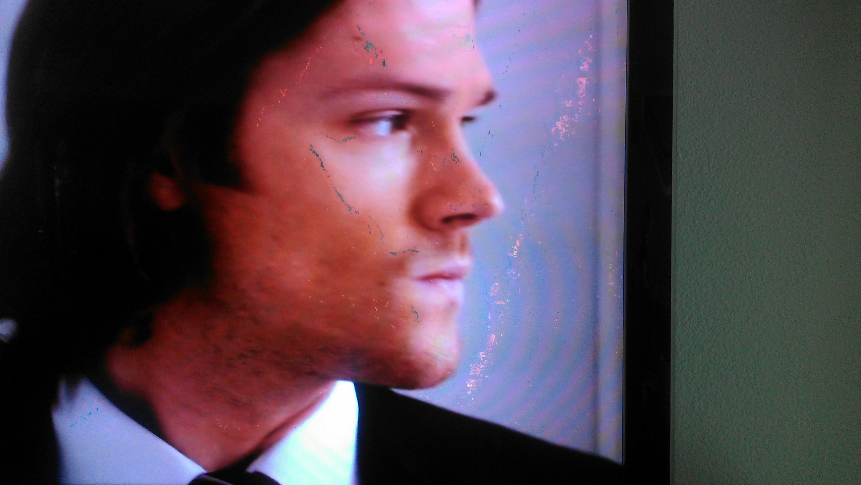

            Bleh. Still doing the same thing with AutoMotion 120hz turned off.
            it moves around with the scene.
              Ah, XBMC? Nice. I use that on my HTPC and RasPis.
              If the problem was transiently resolved by turning the 120Hz off, I'd look at a defective t-con causing this issue thru the motion flow processor.
