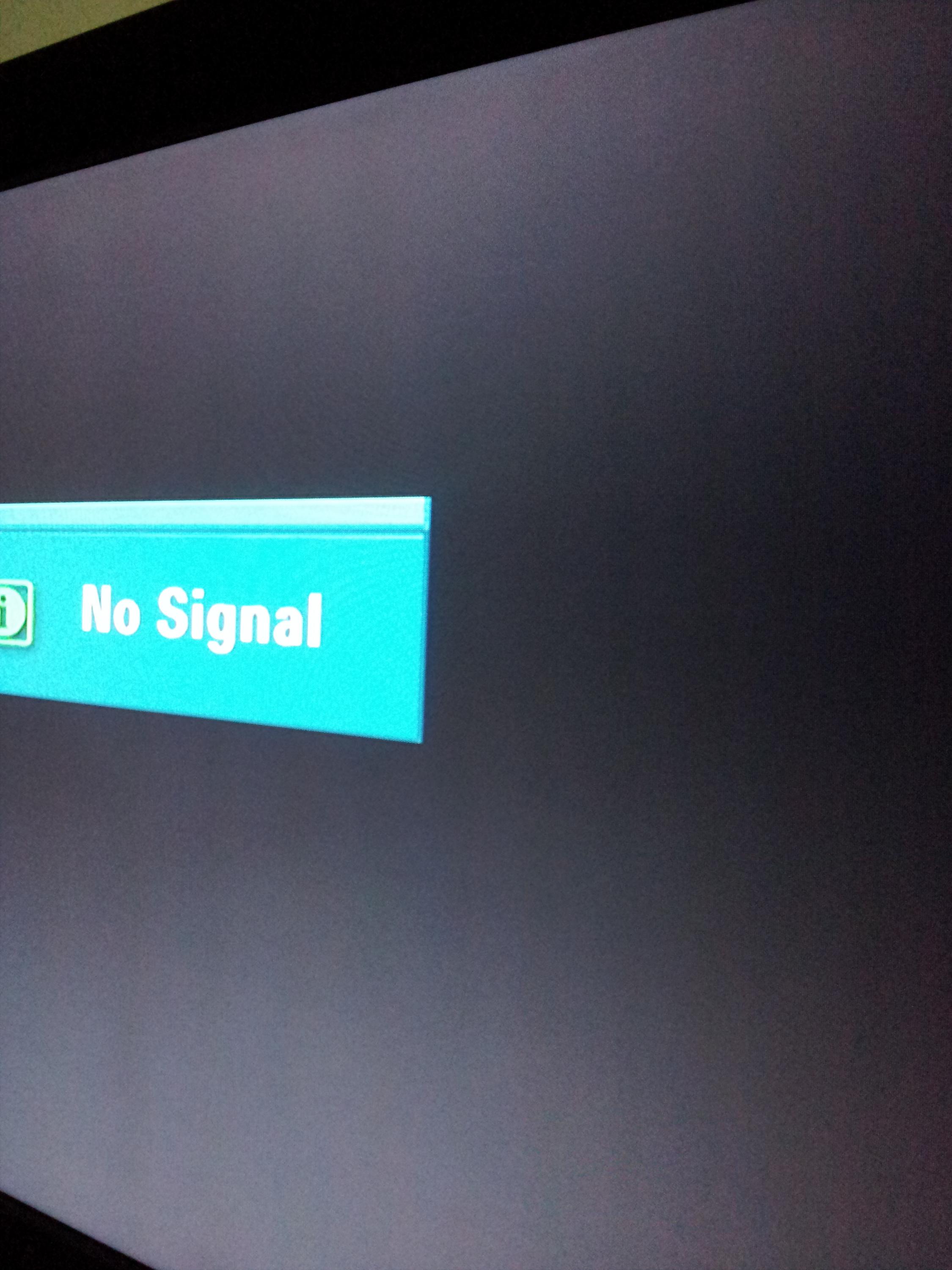

    I have Samsung LE32R81BHX,
    This TV have problems with image, negative image.
    ON T-CON board (V315B1-C01) changed AS15-G , and now image is not negative.
    But, you can see in picture , despite giving the image well, image very grayish
    Maybe have problem in T-CON ??!! anybody have a schematic this board ?
    Can help -me please !

    Hmm, I think that's normal. These LCD panels used in R81 Samsung are typically CHUNGWHA or CHIMEI which have poor black levels. Do try tweaking the brightness/contrast in user menu, though.

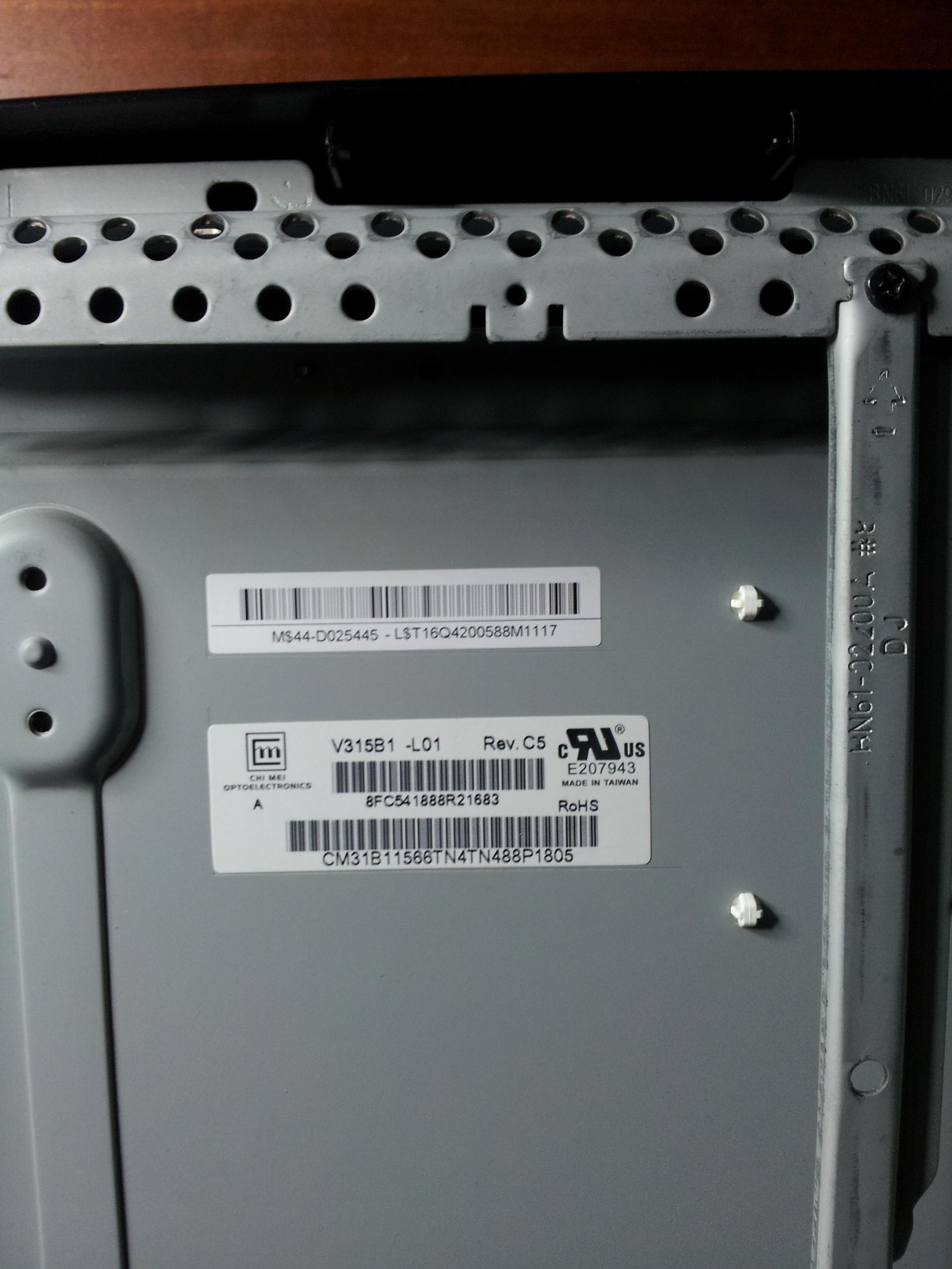

      Panel is CHIMEI

        I don't think there's anything you can do, it's simply a rubbish LCD panel. You can try turning down the backlight brightness if that option is available.
