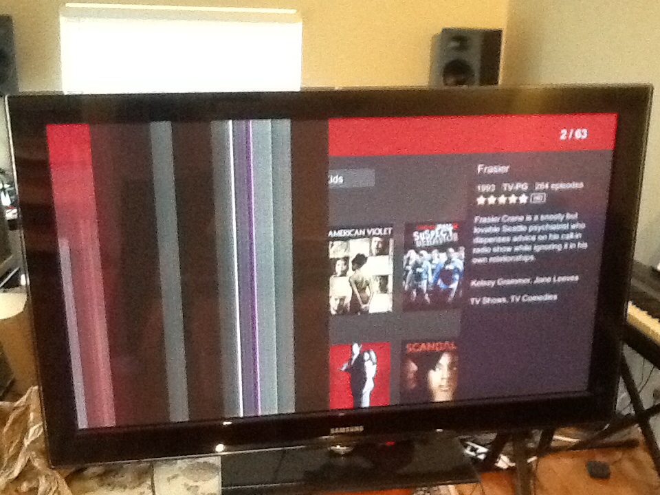

    I just put a ysus and y buffer in this 2009 Pn50b550t2f. Got the parts off eBay. It was doing the typical sound but no video before. Now I have video but it's looking like the attached image. What now should I do? Any ideas?

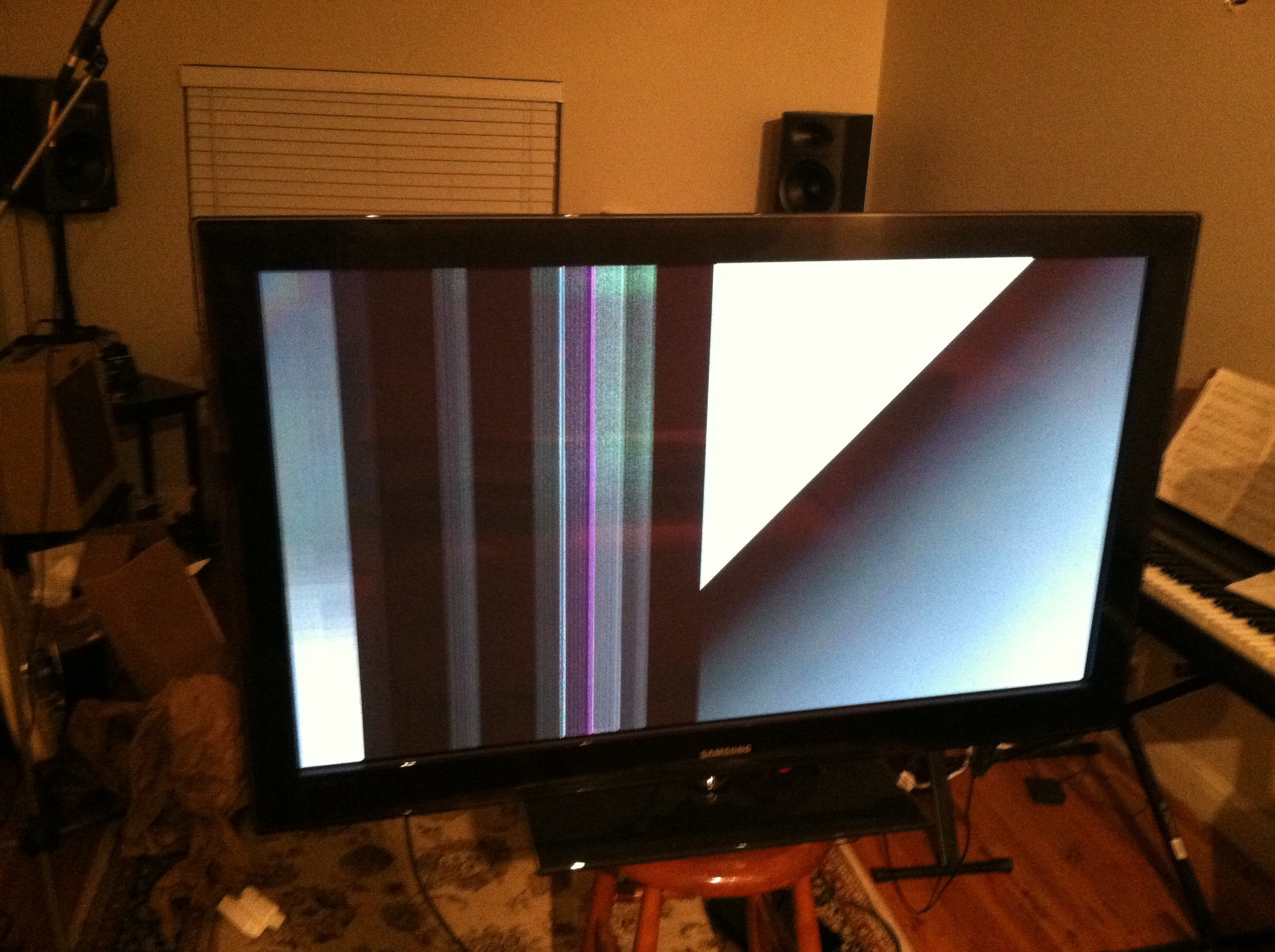

    Try the test pattern generator on logic board

    I fear the panel may be toast. At any point, did you reconnect the small connectors coming off the Y-main or X-main going to the bottom of the panel without discharging the Va below 10V? Especially damaging if Va was fully active at the time.

      Re: Samsung Plasma Vert Half Screen Issue - Pn50b550t2f
      I didn't Tom. The test patterns have the same distortion on the left side of the screen.
      I did forget to plug in the power from the ysus to the bottom horizontal boards at first. I powered down though and plugged that in. Which is where I have this problem.
      Definitely a bad panel?

          The X- and Y-boards cannot cause this. You can try a control board replacement but I think the actual plasma panel is shot due to Va transient.
                TV is working with the new main board.
