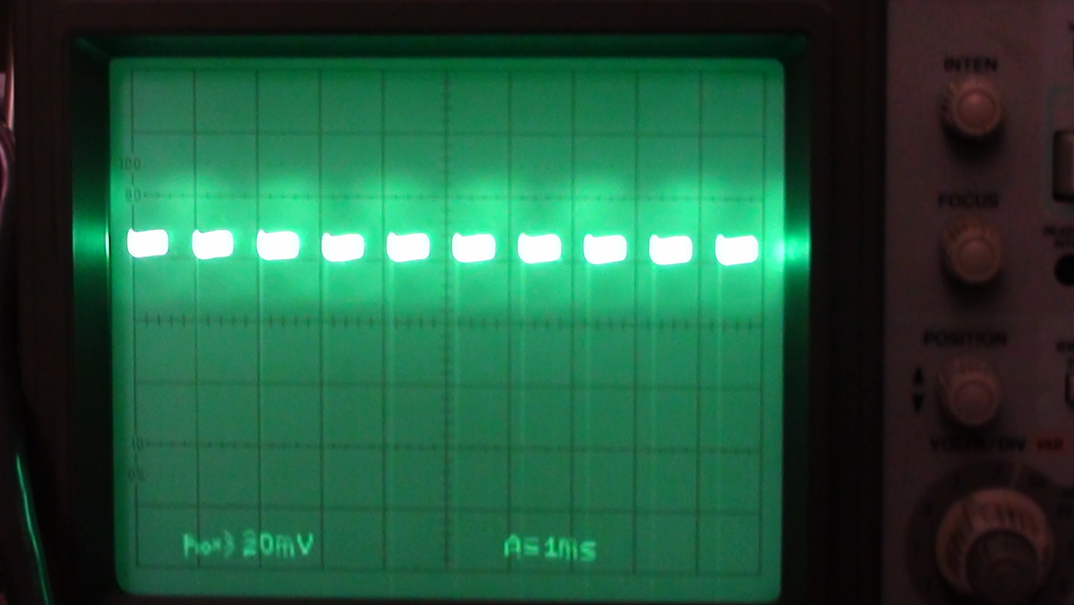

    Hey guys, I got the broken part fixed on my first scope, as some of you might know. I am having some issues compensating the probes. I've done some reading and watched some videos on it. It's a X100 probe I'm trying to compensate and I can get a square wave on the screen but it is extremely small. It's very hard to see. The squares don't go very high. Even if I hit the X10 Mag, which, I don't think is supposed to magnify the wave. I might of misunderstood what I read. Is there any way to make it bigger?

    It's an X100 so has 1/100th normal amplitude. Try setting amplitude to 100x higher gain. e.g., if it suggests 1V/div use 10mV/div.

              No risk of damage from changing volts/div.
              Set scope to 10mV/div, then connect 100X probe to compensation point, you should see a (possibly distorted) square wave occupying one or two divisions. If your scope has 5mV/div or 2mV/div options, try those too.

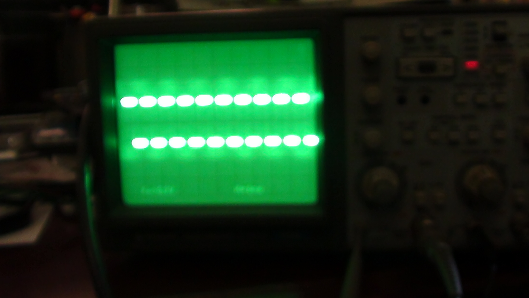

                              I typed that earlier but didn't realize I wasn't signed in. I have ran the tests and these are the results. When VOLTS/DIV set to 10mV and the line centered in the screen with GND pushed in and AC/DC set to AC, I release the GND and hook up the probe.
                              The screen is all jacked up. I cannot see anything, just very faint lines going vertically up the screen. When I adjust H-POS all the way up, I can see the bottom lines. If I just it all the way down, I can see the top lines. If I change the VARS to 20mV, I can see the squares perfectly. I'm wondering if in the manual they got the two mixed up. It seems to me like the one called VARS changes the distances between the very bottom line and the distance between the very top line. The higher I go, the smaller the distance. Here are some pictures...

                                  Re: Hitachi V-1065A Scope Problems...
                                  Volts/div is the COURSE control, it moves in discrete individual increments, VARS is the variable control which is fully variable. If set on AC coupling, neither should significantly move the trace in the vertical axis.

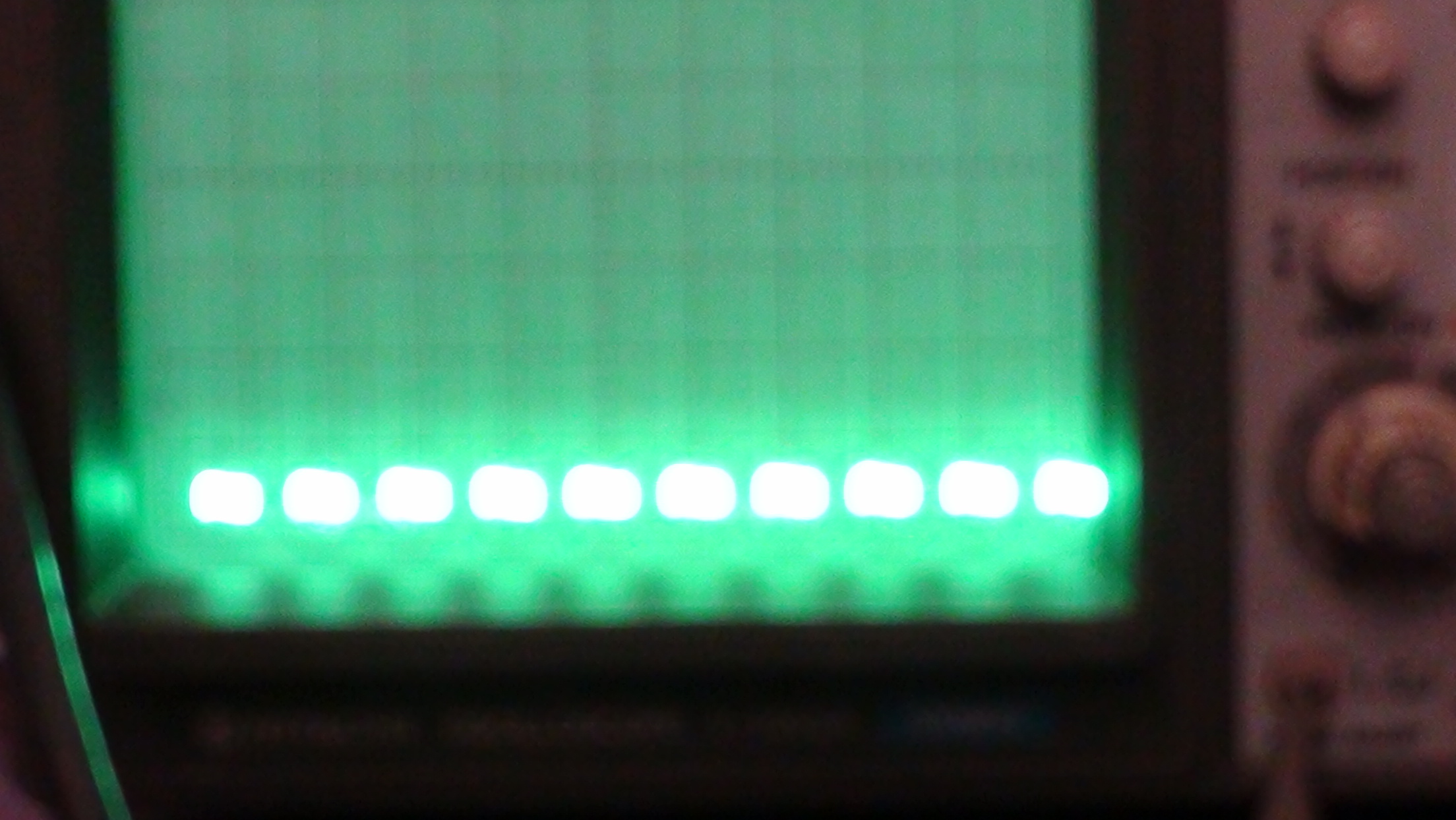

                                    5mV is off the screen, 10mV is about 5 squares from bottom to top, 20mV = 2 1/2, 50mV = 1 square...
                                    The controls are definitely mislabeled in the manual for probe 1. When I push a button in, it's set to DC, when the button is out, it's AC. When it's AC, that means that AC coupling is set, correct?

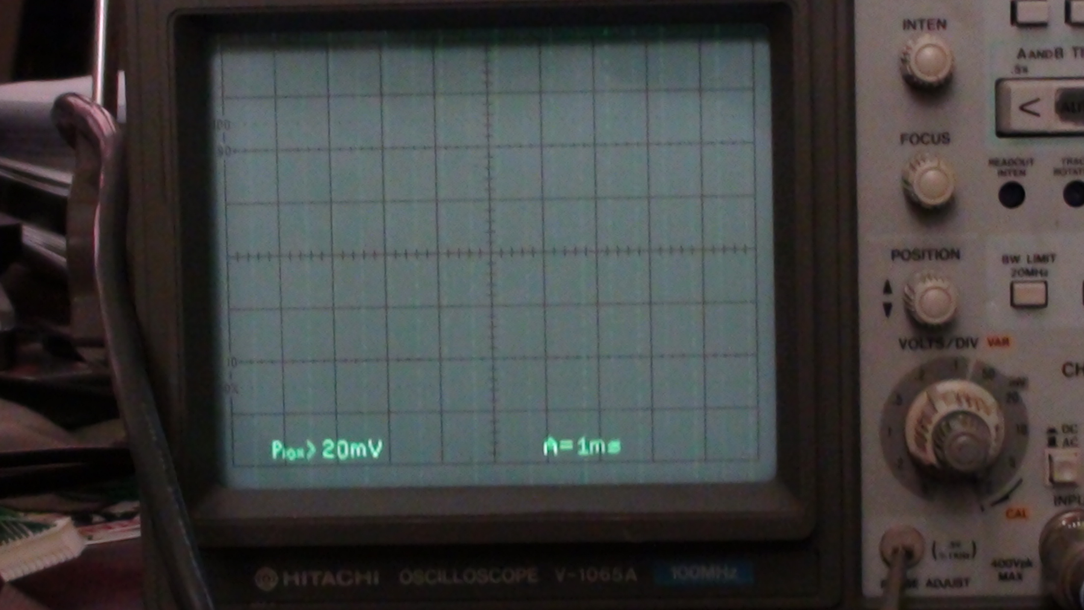

                                      Sorry for the delay, I've been watching that long video someone (I think you) gave me a link to on how to use this thing.
                                        Yes, you want to have it set to AC.
