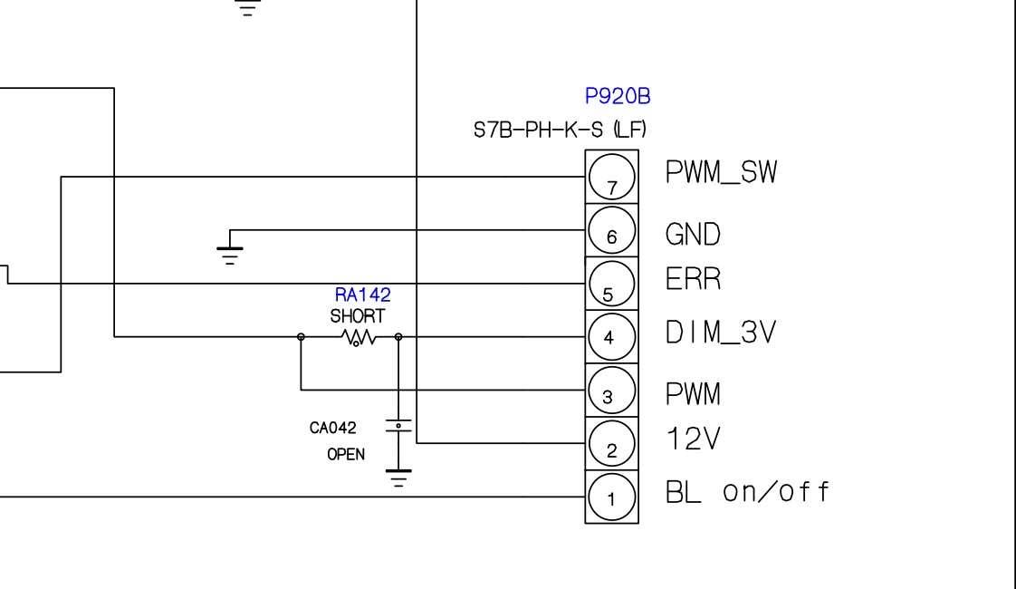

    I then checked voltages and found an incorrect voltage at 12v_lcd. Looking a bit deeper I found that 24v goes through an mp1591ds step down converter to get this 12v_lcd, but the mp1591ds step down converter is switched by a 3.3v from the mainboard.

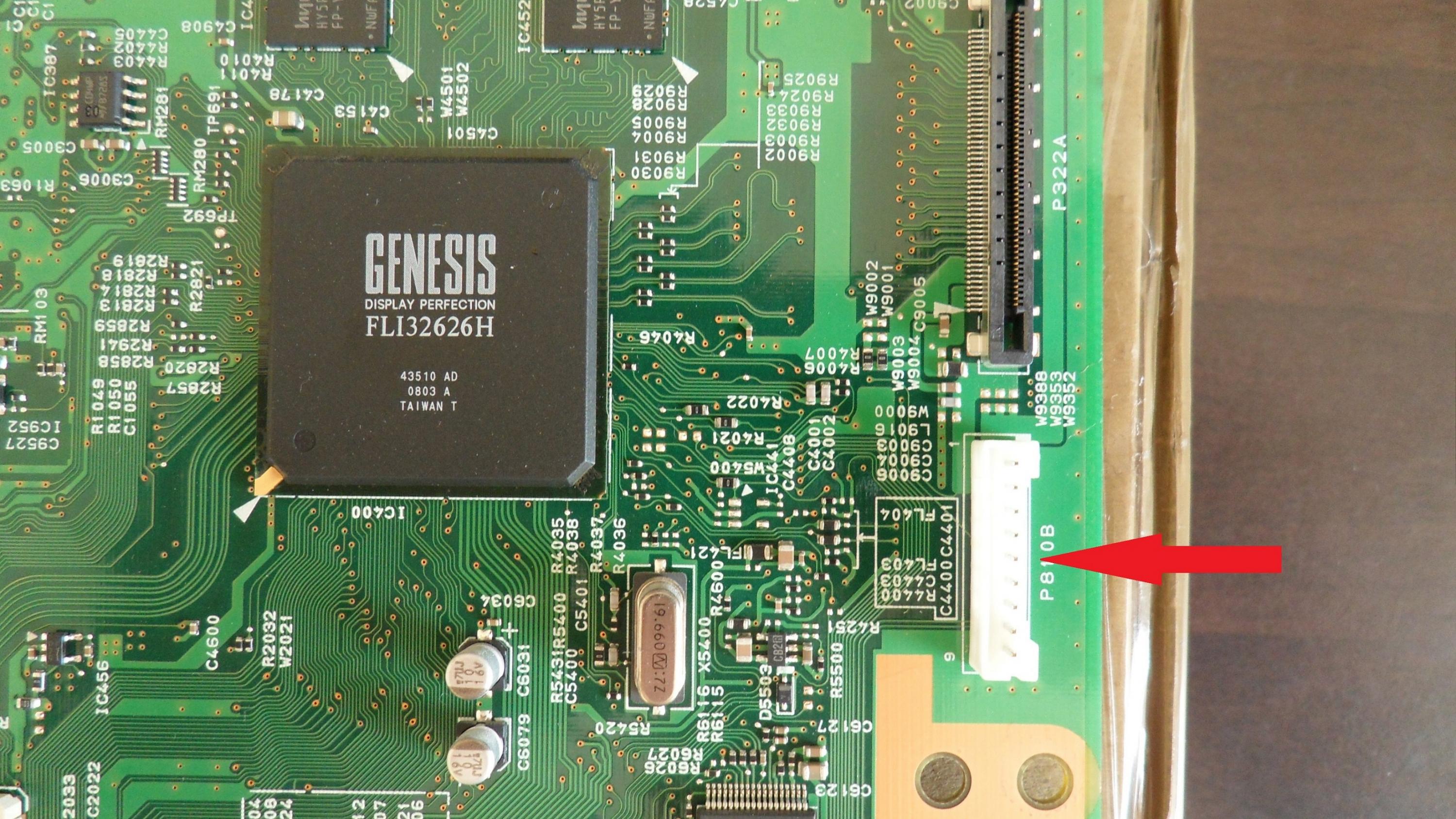

    The 3.3v from the mainboard is where I believed my problem originated. If I disconnected the mainboard from the power supply the mainboard would read anywhere from 2.2v-2.9v, but as soon as I connected the mainboard to the power supply the voltage would disappear.

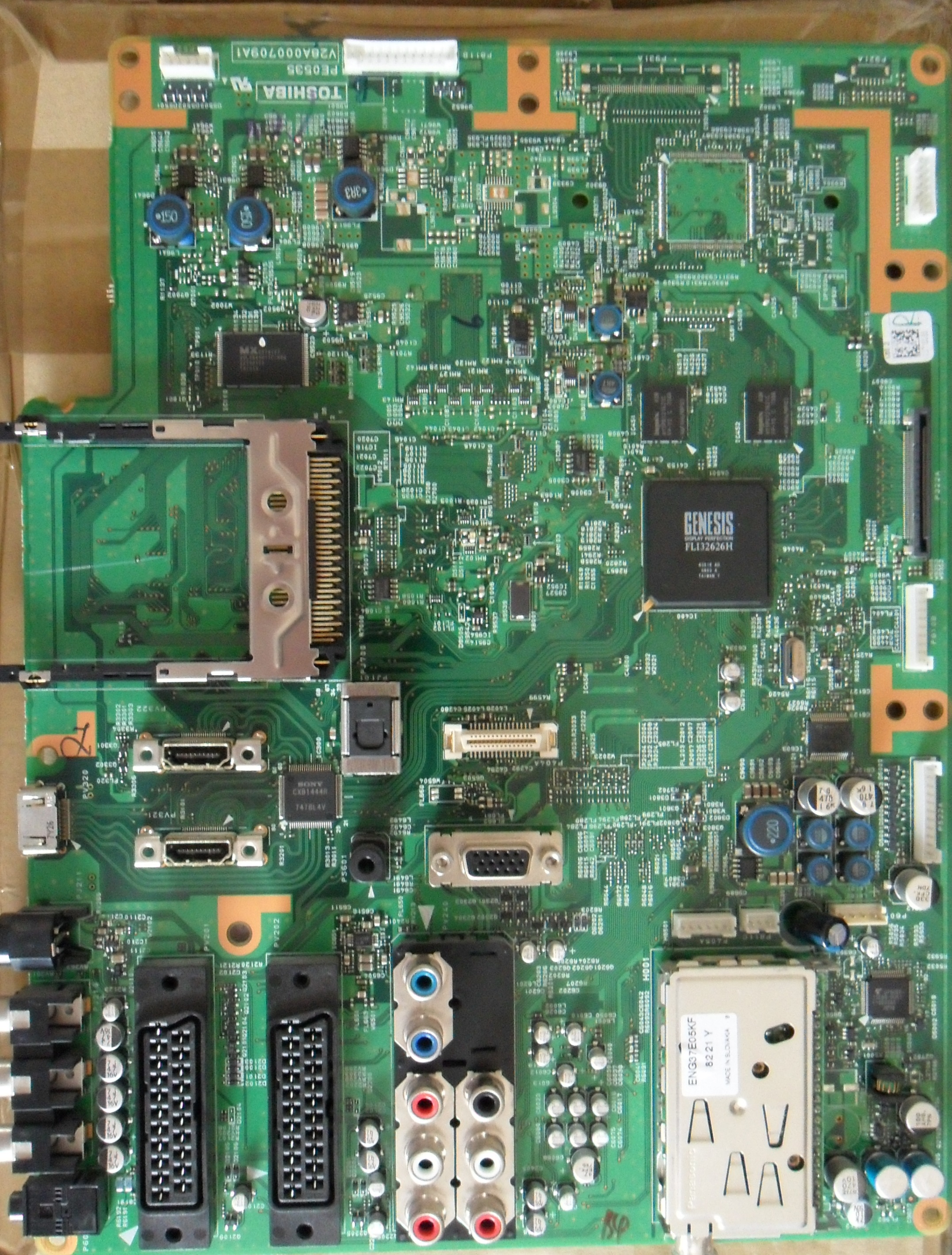

    I replaced the mainboard with a 2nd hand Ebay board and now I have a constant 3.3v to the power supply, and the TV acts as it should when turned on, but I have no picture or backlight.
    I have 2 questions that I am in hope of getting some help with if possible please.
    1) should a mainboard swap work without having to make any other changes?
    2) is anyone able to trace the 3.3v and give me any indication to what the problem might be with my original mainboard?
    I've included a couple of pictures, one of them indicating where the 3.3v should be and also a service manual that shows the 3.3v(Power_Lcd) on page 23.

          All the numbers match up on the boards PE0535 B, V28A000709A1

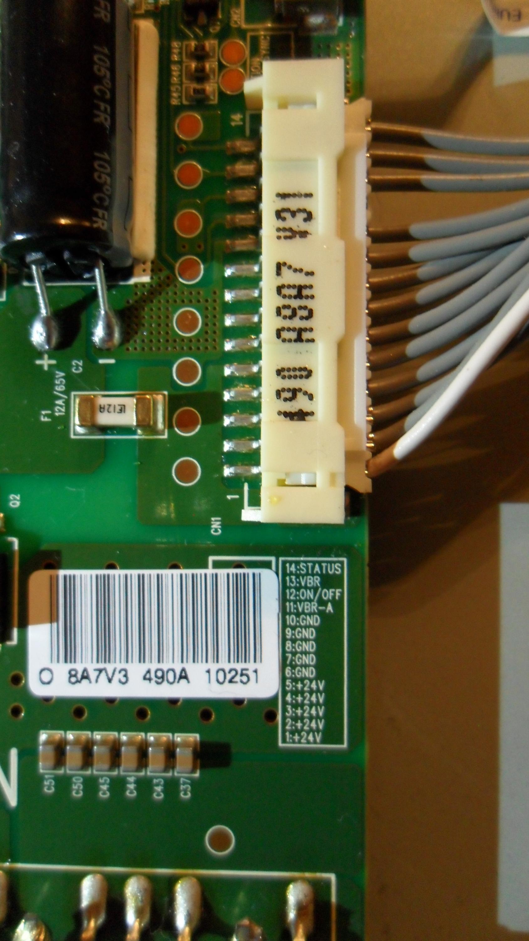

              I spent a little more time on the tv with the replacement mainboard fitted. I managed to get it into service mode and shine a torch at the screen and I could see an image so it looks like the main board is working and the issue is with the inverter not being turned on.
              I started testing voltages at the inverter and this is what I get, does this point to a fault with the mainboard?
              14-1.6v , comes from ERR on mainboard
              13-0 , comes from DIM_3V on mainboard
              12-0 , comes from BL on/off on mainboard
              11 , blank
              10-GND , comes from GND on mainboard
              9-GND
              8-GND
              7-GND
              6-GND
              5-23.85v
              4-23.85v
              3-23.85v
              2-23.85v
              1-23.85v
